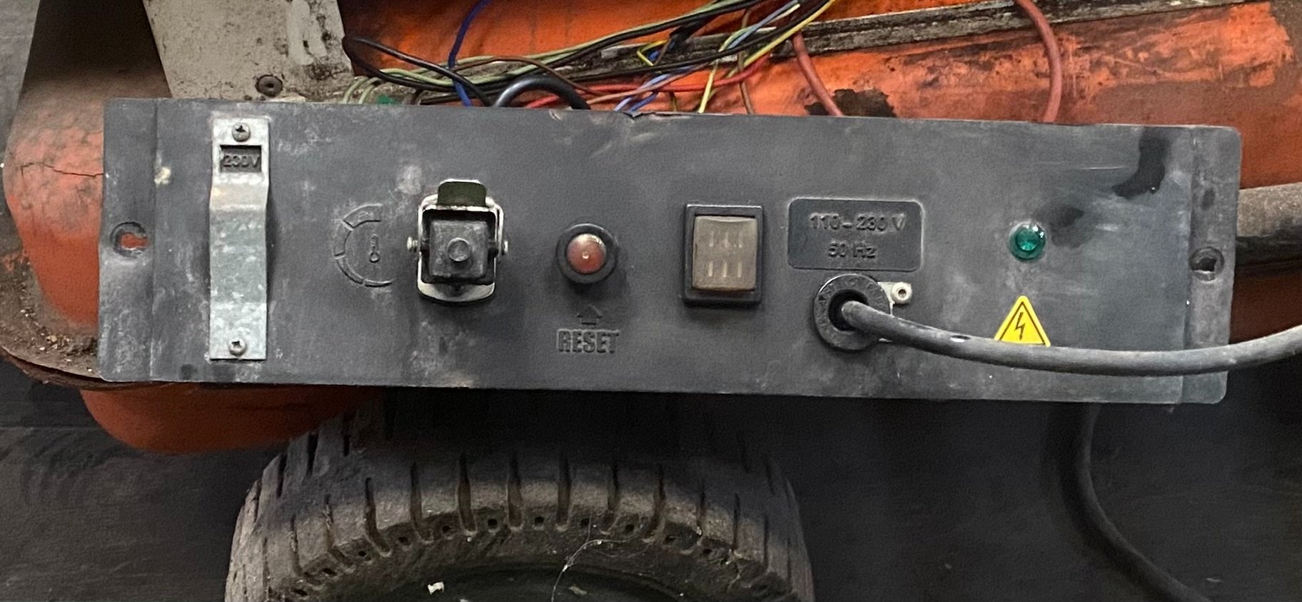

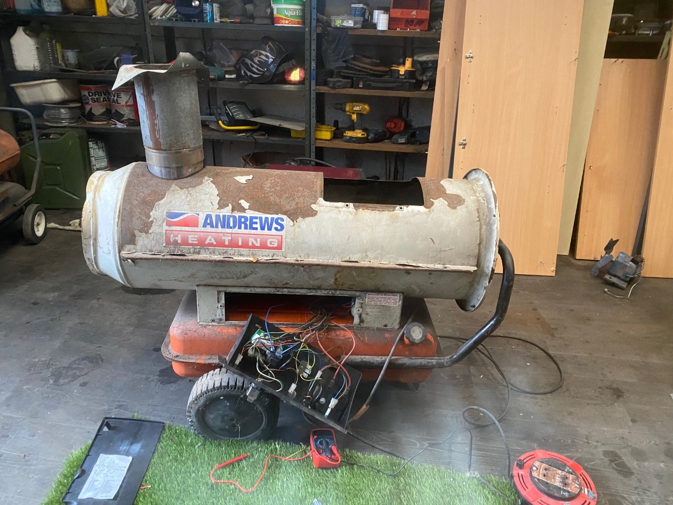

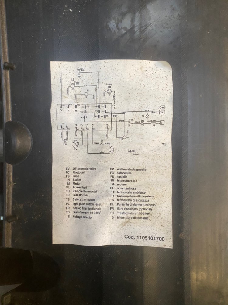

I've got a rough looking Andrews space heater, that doesn't want to power up, it's dual voltage, but is set up on 240v
Things I've checked that work.......
1. Overheat sensor, no resistance from cold
2. Optical sensor, reacts to torch light, checked with ohms on multi meter
3. Fuel ignitor works
4. Fan motor works
5. Fuel solenoid clicks when powered
There's no fuel level sensor, but has fuel and the rest light is on permanently, ie won't reset.
Anybody got knowledge with these type of indirect heaters?
