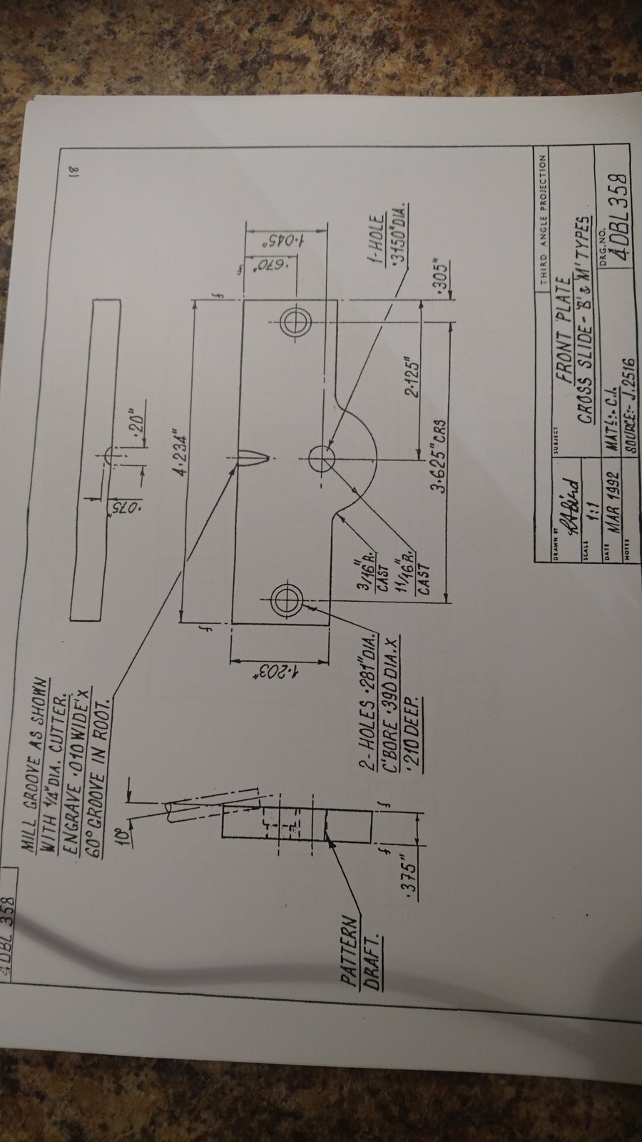

Looks pretty complete so far, just missing a gib strip for the cross slide.
Here is my missing gib strip thread.
Ask one the fb group someone will have oneThe citric acid is working a treat, it strikes a bit cold on the hands fishing stuff out firs thing in the morning though. Just the face plate and the 4 jaw to finish off, and the big bit to sort out.. Looks pretty complete so far, just missing a gib strip for the cross slide.
Not difficult to make from a bit of BMS strip.Ask one the fb group someone will have one
I was reading that earlier. Looks like there are worse bits to lose. I'll make a steel one for it at some point.Sounds familiarHere is my missing gib strip thread.

No but it'll probably be easier than getting a piece the right size and cutting itNot difficult to make from a bit of BMS strip.
