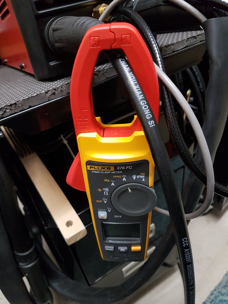

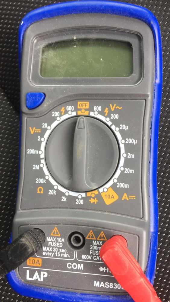

So I borrowed my mates amp meter.I would like to find out if my digital amp reading is true. How do I go about this , how do I rig this up
and make sure it does dc current depending on your welderYou will need a clamp on amp meter for that and you just clamp it around the welding lead.
You can't use an ammeter with leads - the current is far too great for the meter. You need to use a DC clamp meter (assuming you are using DC to weld).Arc welder 140 . Amp meter has two leads live and earth ,so connect live to rod holder and earth to earth lead and turn on ?

"You can't use an ammeter with leads - the current is far too great for the meter."
yes and no, normal practice used to be to use a shunt so the meter measured only a small part of the current flow and was calibrated to that shunt.
Alec
No, that would be a big mistake, and your mate who lent the meter to you would not be at all happy.Arc welder 140 . Amp meter has two leads live and earth ,so connect live to rod holder and earth to earth lead and turn on ?
