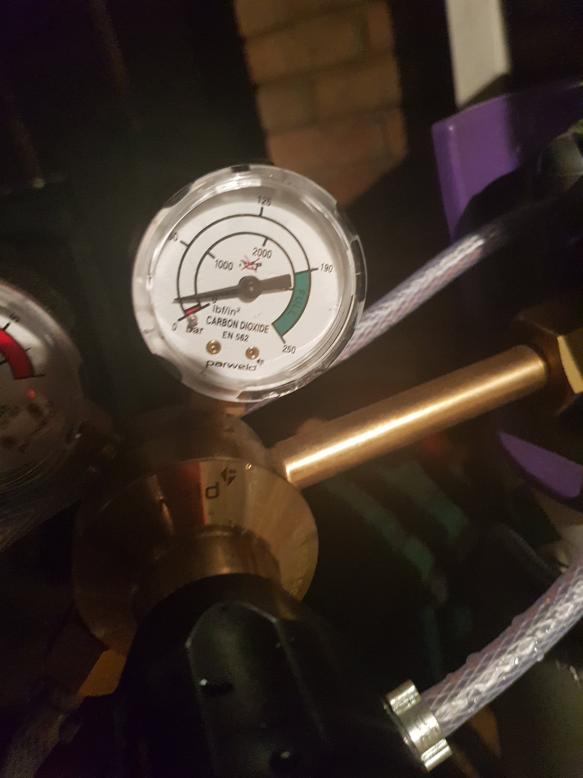

Where are you getting your CO2 if you don't mind me asking ? As would you believe it but done spot of welding over xmas and bottle ran outok update i was up early this morning as i do have times of insomnia not that often but seam to happen in boughts of a week or so then a few weeks of sleeping fine
any how had a look at the bottle and found 14.5 kg on the bottle marked up weighed the bottle with the reg on and thats 16.4 kg
removed the reg and its 15.3 kg
so i know the reg and hose is 1.1kg and the weight of the bottle is 14.5 kg so there is 0.8 kg left in the bottle so theres aprox 15 percent left
and for next time i can weigh the bottle with the reg on as i have marked 1.1 kg on the reg
looking like i will need to get another in the new year a quicvk cheak online the bloke is still there so with good luck i should be ok and with the litte left hope i got enought if i got a little idea for a small job i dont know how long .8 kg will weld for
