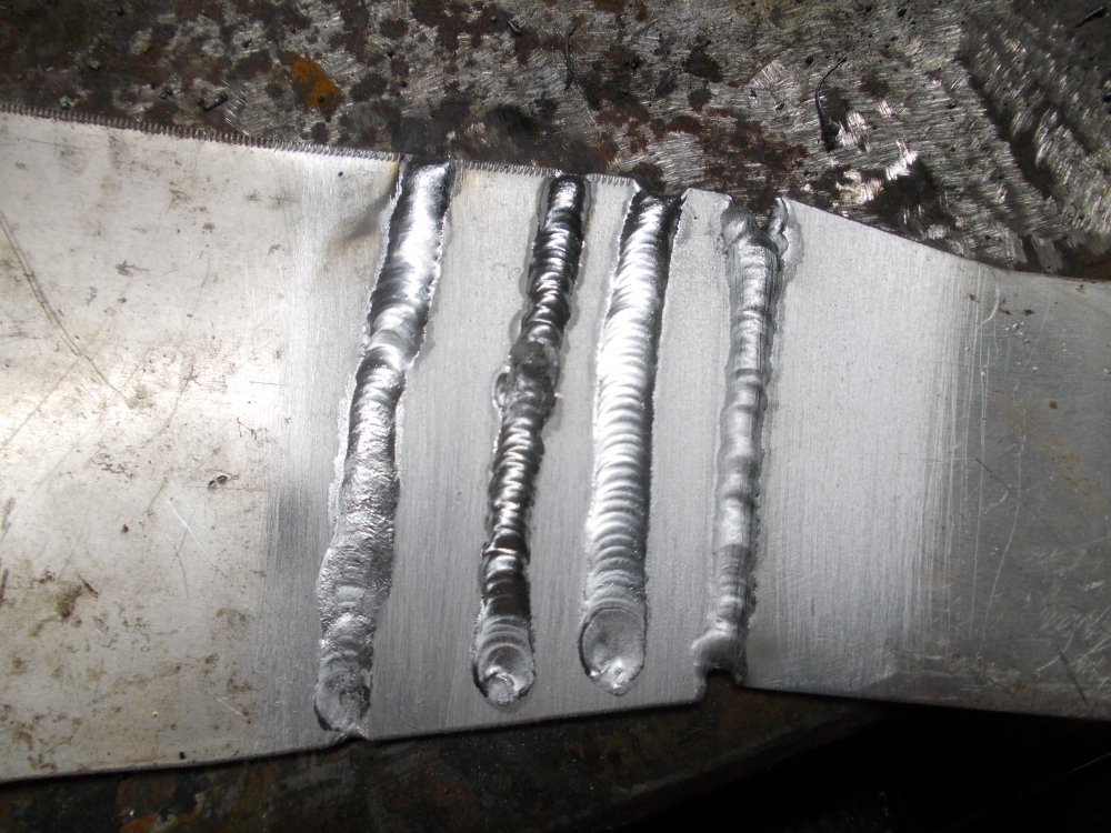

If thats all i will have it all covered by lunch time tomorrow I WISH. thanks for the input you have to bear your sole on this forum but well worth it.Welds look clean,
You have only technique to perfect by the looks of it. I say "only" that's the hardest bit!
Arc length, rhythm, steady, straight, consistant speed and torch angle.
I do wire brush the weld area with a stainless wire brush what would you recommendOld stuff can still be cleaned!
pedal
No point in trying joints
Sorry but it will only lead to disappointment , get those runs looking great on the plate then transfer those great looking runs into butt joints.
Have you done much with DC Tig. Everything works a little slower with DC allowing you time to perfect things. I learnt to Tig weld to a reasonable standard over the course of a year solid and probably another year to get good with Aluminium. It's up to you but I would not move on to the next step till I'd perfected the first one. Other wise you may as well get a pipe stick it at 45 degrees and go straight in at 6G, you'll be throwing in the towel by the end of the day as you'll see no pleasing results which is demoralising. Hope you see this as positive help as that is what is intended.
