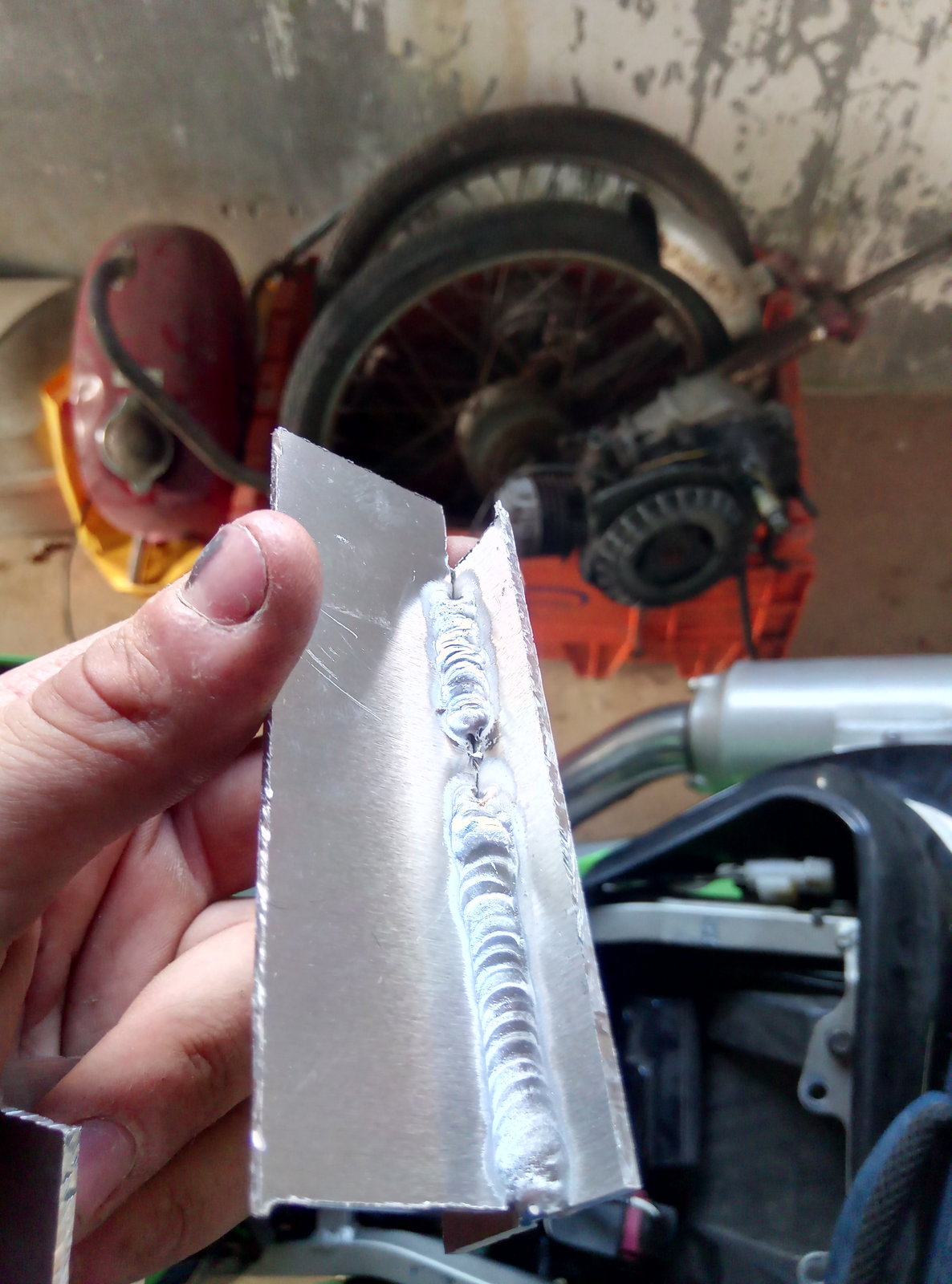

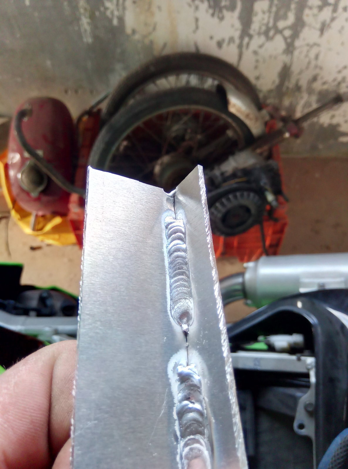

Its an interesting beast shows up every fault, ive never welded ali so it was nice to have a play.

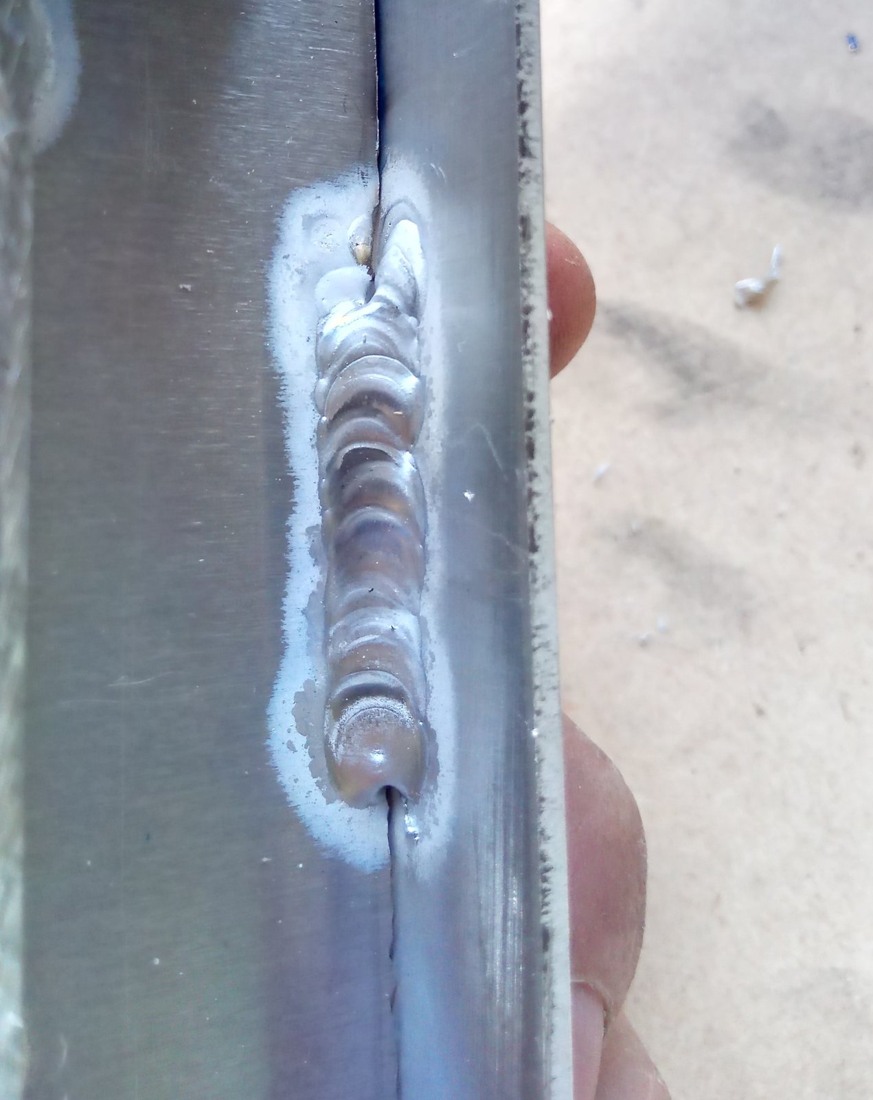

Had no trouble with stringers, but fillets i i found interesting until i just floored the pedal which helped stabalise the arc then i could ease off. Loads of practice needed yet also need to learn the pedal as it's different to my last machine, the settings seem set about different to other machines ive seen. For example has balance" +1 :+10 cleaning." -"1:-10 penetration" it might be im in one of its many modes
How anyone does it without a bench is beyond me i forgot to take my stool so was propped up on some boxes just could not get comfortable.
Hope either Richard or brad could book me in to give us a hand
Thought i took stringer pictures alas my phone took the picture after i moved, so it took a picture of my feet

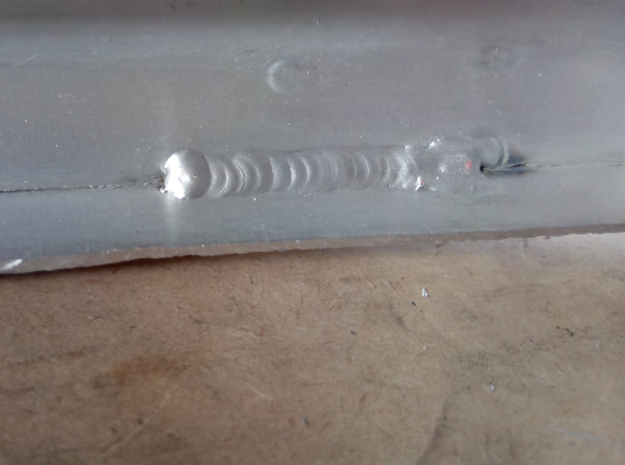

I tried to fill a crator but was cold made a right mess
In both had trouble with the arc wandering leaving poor root penetration at the ends
All in all wow thats tough.
