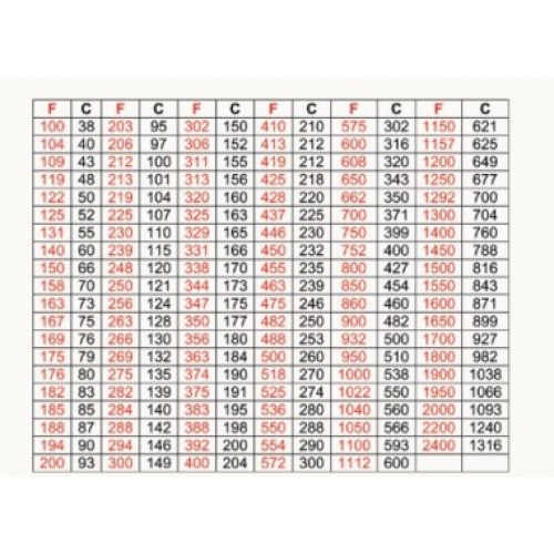

it's something i'll have to try.what kind of temp do you normally heat to? or doesn't it really matter.
Yes temperature matters, too hot and you will boil the alloy. if you have tempilstiks, use them for a temp guide, say 75c to a max of 125c.

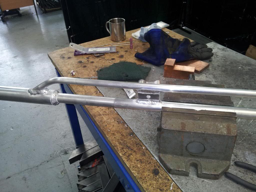

Does the 1mm wall pipe take fluid?
