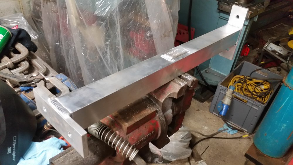

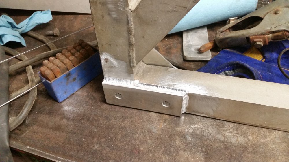

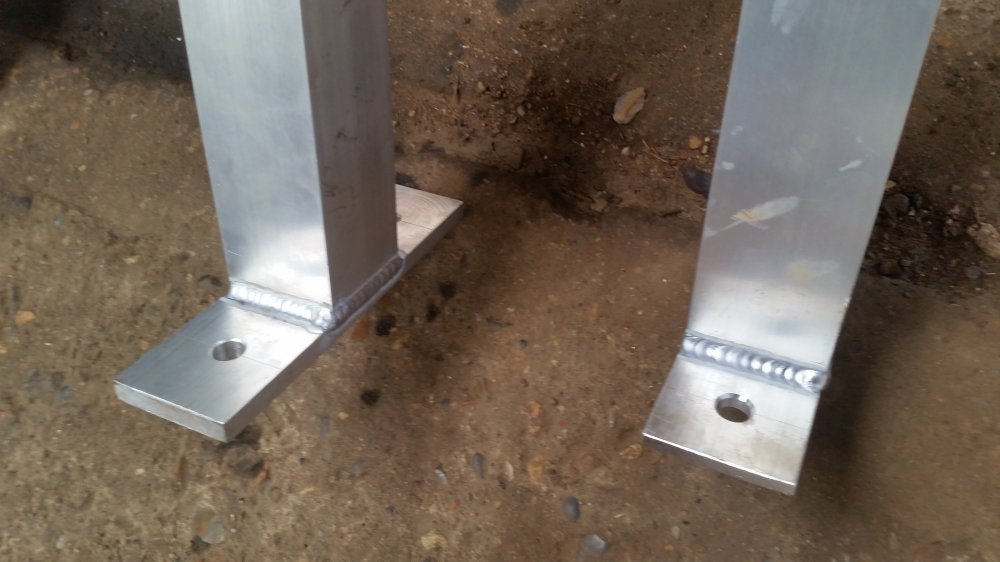

Still getting the graniness in my aluminium welds with both 4043 and 5356 (BOC filler rods) but these are some welds for a gangplank/handrail job I'm doing this weekend. It's a repair job I've done twice before. 3mm aluminium box and 90 tonne excavators don't mix.
Preheated, vee'd, whacked in at max amps off the pedal on my Rtech.
