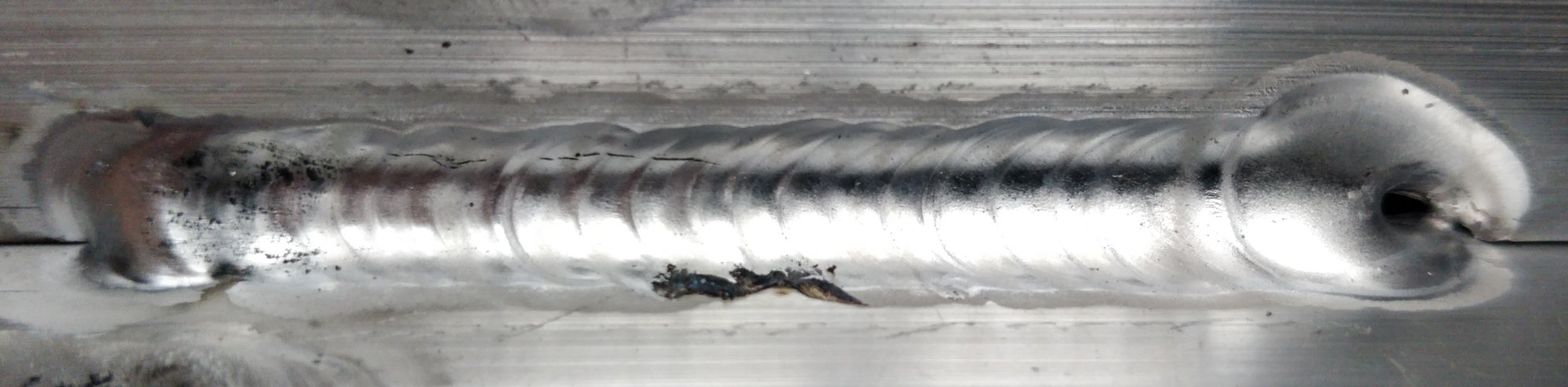

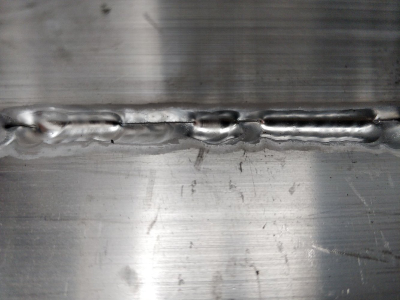

And myself - I found I had to get the tip of the tungsten *much* further into the corner than I was comfortable with to get decent fusion on fillet welds - Jody's video above shows it very well towards the end. The trouble with a lot of these things is that the differences are subtle. If you know about them, they stand out like sore thumbs; if you don't, they're very difficult to spot. It's worth watching the 'how not to' bit of that video a few times and pausing to take in what he's saying. It sounds like chat, but it's actually very concentrated information.beginners such as myself
