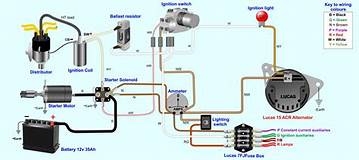

I’ve managed to find a wiring diagram for the alternator version of this tractor, so tomorrow I’ll start by checking the wires between the IND terminal and the lamp, and then between the lamp and the starter. The loom is actually very difficult to get to as it disappears under the hydraulic tank and battery box, so if any of them need replacing I’ll have to re-route them.
