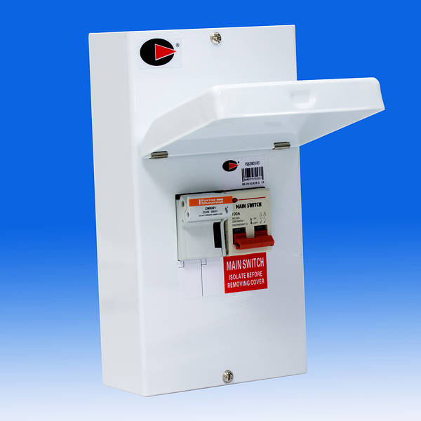

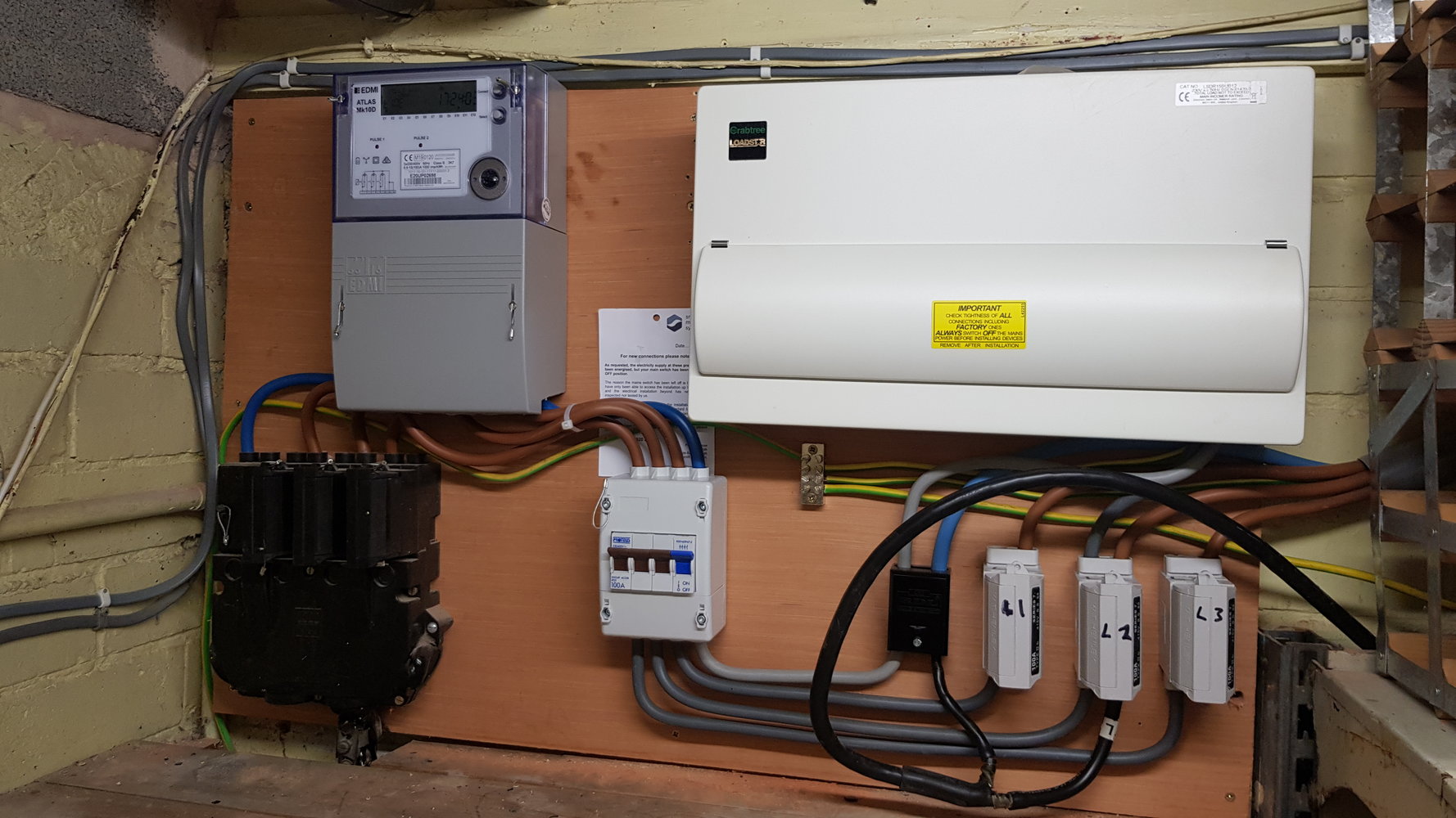

100 amp main fuse (415v apparently, 3 phase voltage on single phase supply, sure it’ll make sense to someone with more electrical knowledge then me). Can any qualified electrician run a new line out to another CU from before the houses CU? Or is this a job that the electricity supplier must do?
This seems like the best option, will be able to run power to a new CU around 2-3m run from the metre, into the compressor/washing machine shed. 16 amp and 32 amp socket from there (possibly more in future) then to get by for now run 32amp swa extension lead from there for the welder in the workshop until that all gets wired up properly etc?
Does this sound like it’s along the right lines or am I way off?
