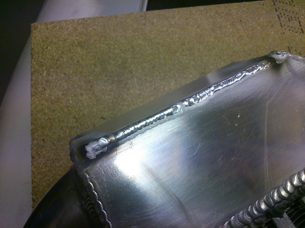

.That's black soot. Usually a result of too long arc length/bad torch angle. If torch angle is correct (10-15degrees) and arc length is short the gas coverage is protecting the leading edge of the pool and reduces the oxides been transferred across the arc which is what causes the black soot you see on those runs.A massive improvement lee and the material looks nice and clean.
You do however have a lot of contamination at the start and finish? Did you dip the tungsten when tacking? Also how are you cutting material? The bead itself does look a little cold. So keep playing with amps,travel speed.
You must have good technique lee. Very occasionally I might get a spot come up usually on the first tack of an outside corner joint. The important thing is to brush it off before continuing.Have never experienced that before the only time I've ever had soot in a weld was from a dipped tungsten. Never stop learning lol
I appreciate the feedback again. Start I think may be contaminated from a bad tack. I think end was torch angle where I ran past the end of the job too far.
I ran another one and they came in much flatter. Like the end of the second weld. I think slower travel speed maybe as amps were set the same.
Currently I am using the 4t trigger function. Mine is start amps on first press. Release for welding current. Press again to downslope to lower weld current which I still need to understand if that is adjustable or preset bottom value. Release again ends weld. Is a bit to get used to but the first bit I am getting the knack of!
