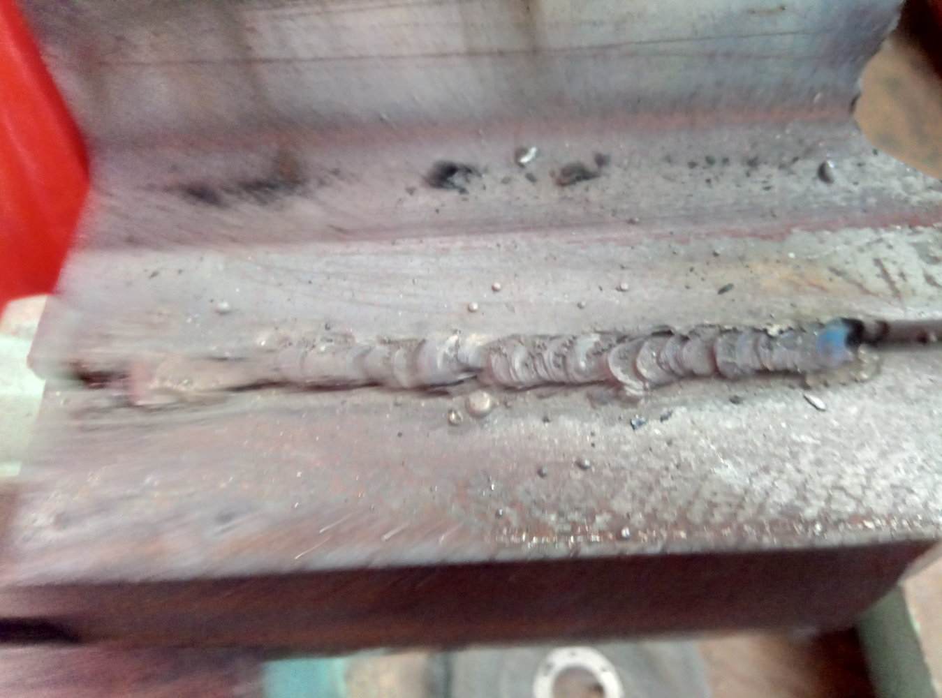

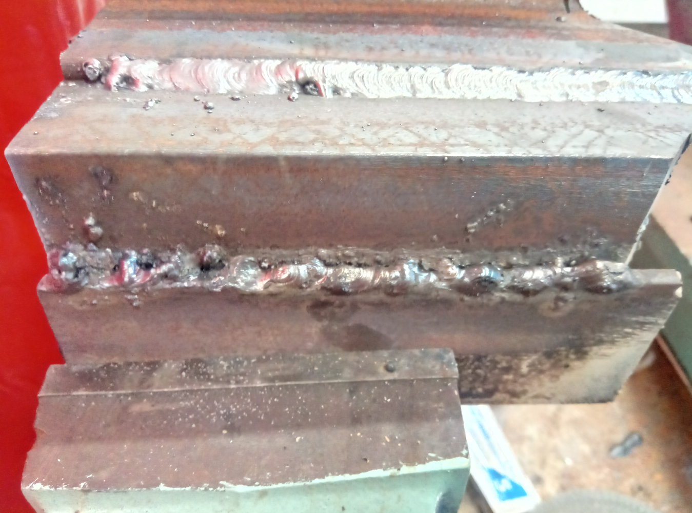

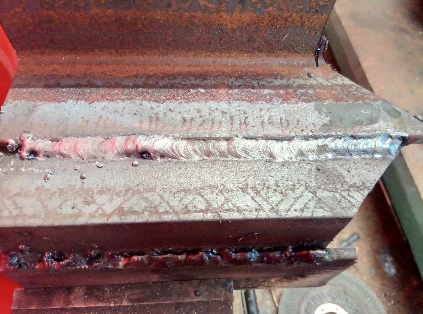

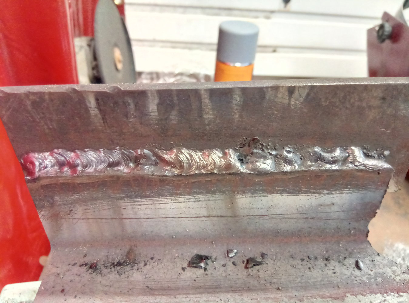

Just welded some jack legs onto my trailer, tonight with 2.4 mm SIP Rutile electrodes, because they were to hand.
I will freely admit to being a bit out of practice with Vertical Uphill, and working in constrained areas didn't help, there was much gouging of roots and reworking as I did the first one.
But by the time I got my hand in again I remembered why those SIP electrodes were to hand... Their claim to be all positions electrodes is only true in so much as they run equally badly in all positions.
I need to run some short overhead welds to finish the job off in a really tight position, and am not at all confident of being able to run them with what I have.
A recommendation for a good general purpose electrode which runs well on an AC welder (Oil Cooled Oxford) and has fast-freezing slag would be much appreciated.
