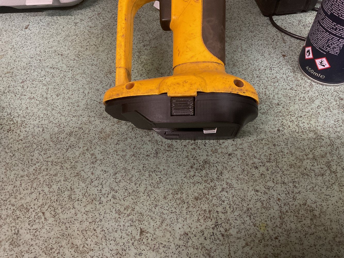

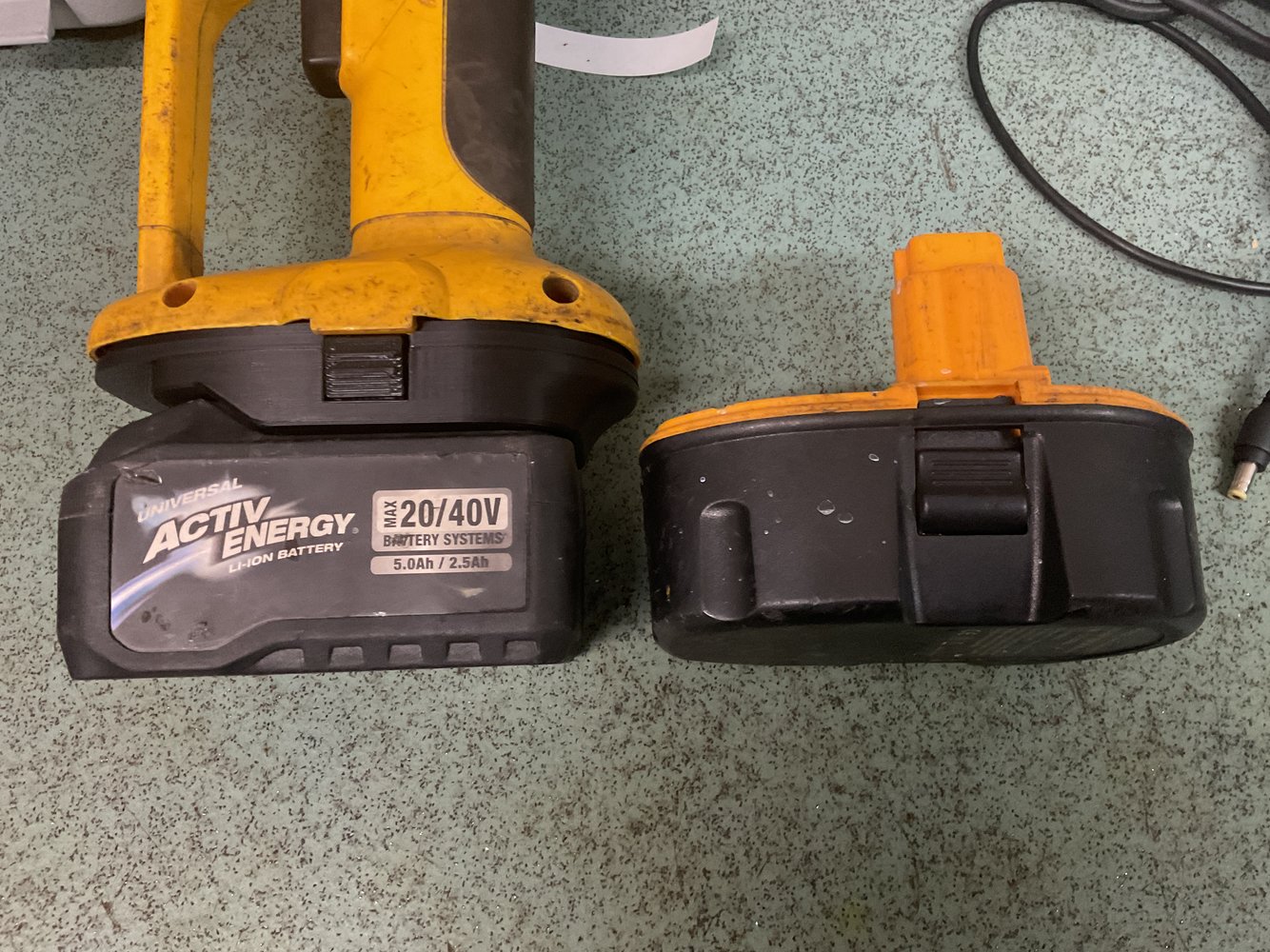

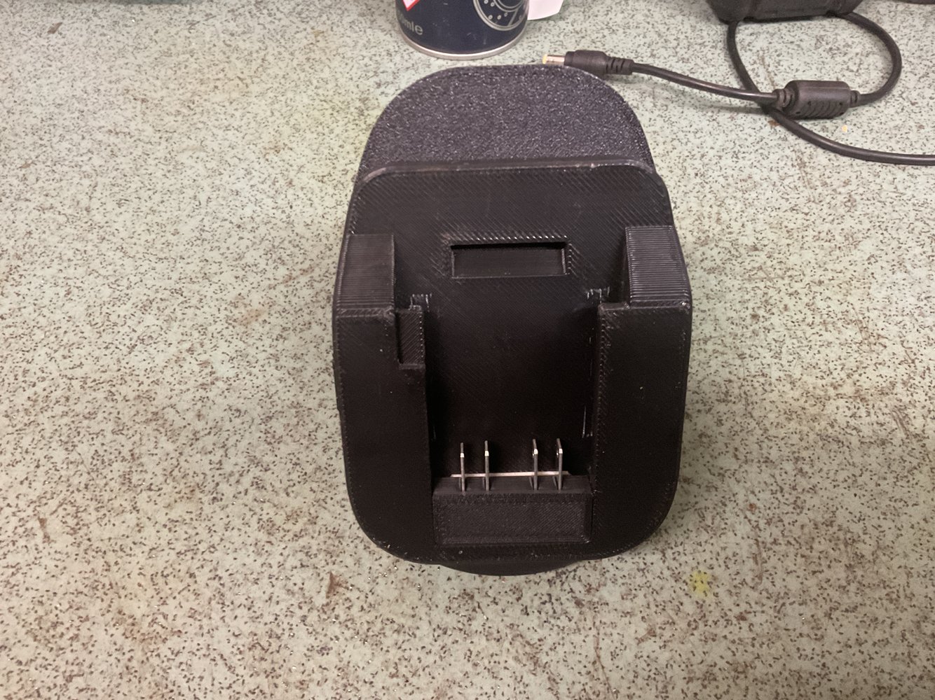

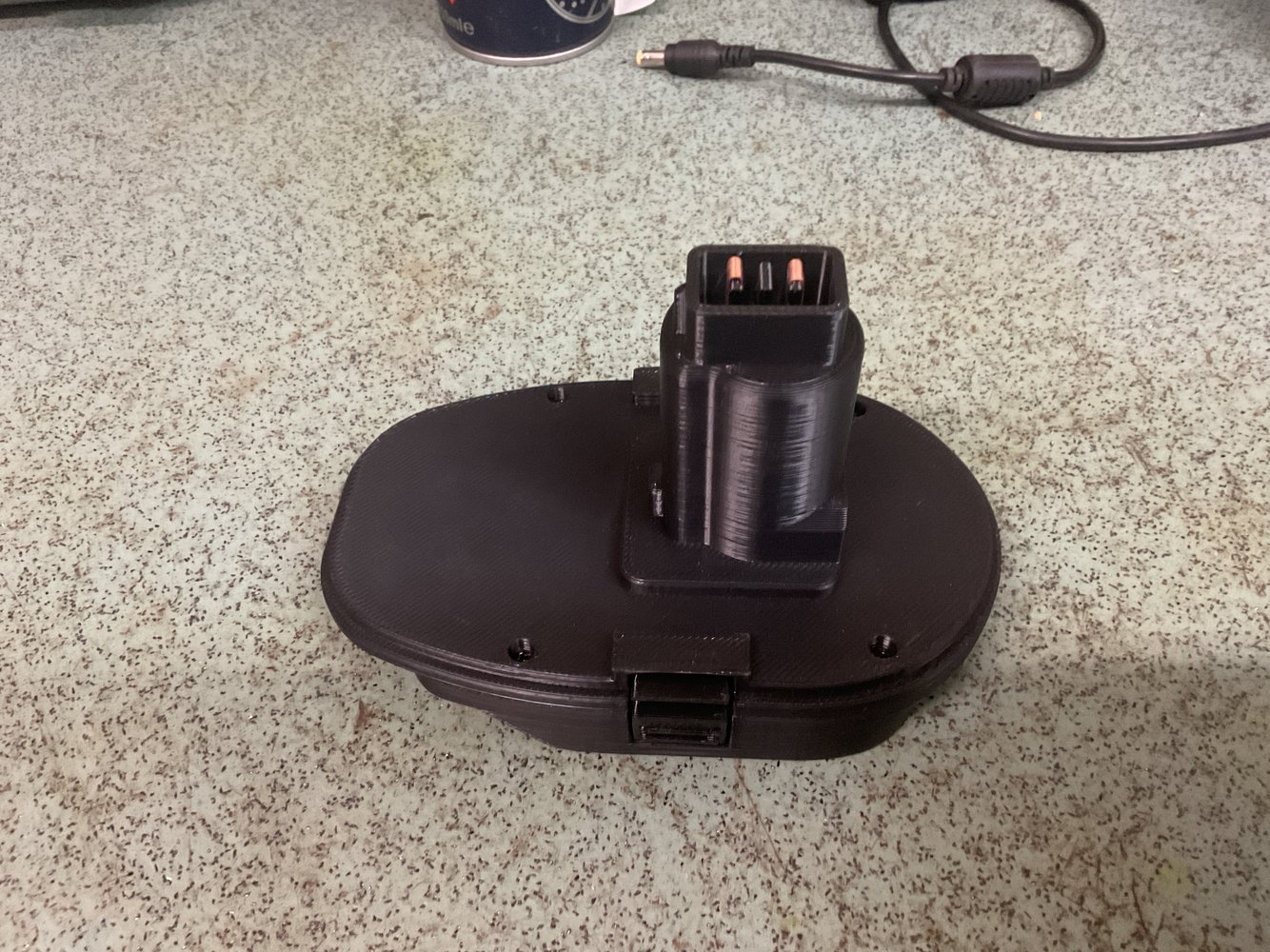

Now you have started something. On Off wont be beaten.Not sure if these snaps of a ferrex/dewalt adaptor are any use.It was abut £15.
View attachment 457776View attachment 457775View attachment 457774
Lol I only have ferrex.OK for Lidl Parkside but if anyone doesn't want to wait for me. £20 odd for the files though:
deWalt 18V DE9180 to use parkside x20
Model deWalt 18V DE9180 to use parkside x20 you will need this material: 4 male fastener 6.3 terminals for dewalt and parkside 4 screws 3mm X 16mm long 2 spring 5mm X 15mm long +/- for the side buttonscults3d.com

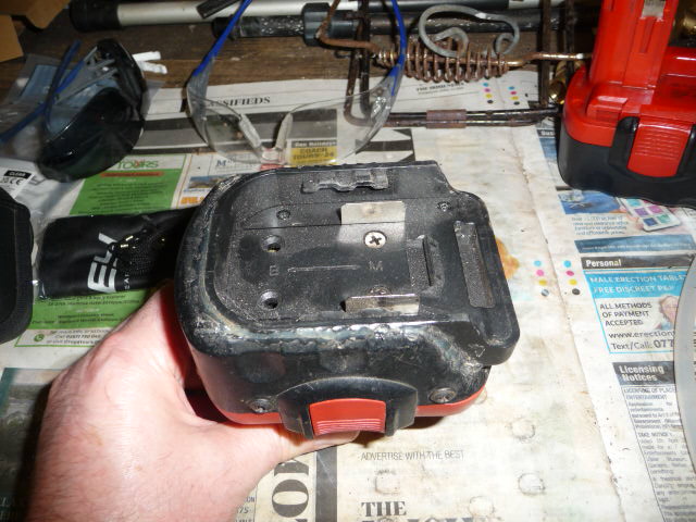

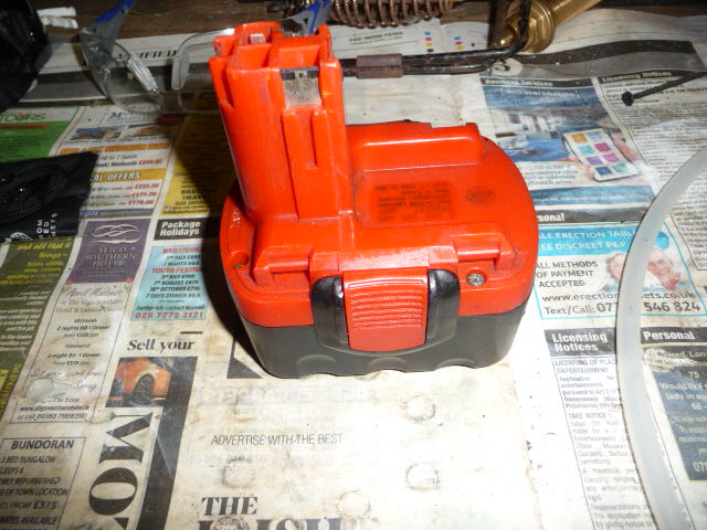

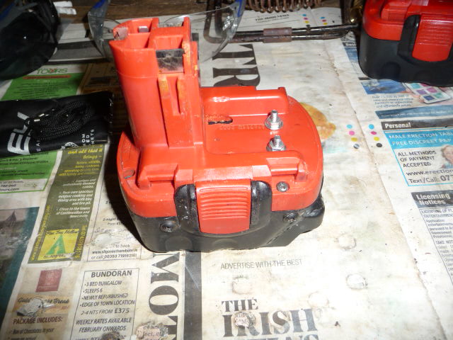

I made an adaptor to fit Makita LXT batteries onto Bosch tools.
Then in a flash of inspiration I thought why not replace the battery with a wooden dowel. Rather handily a brush shaft is the same dia as a sub-c nicad cell so that what I used! @Onoff - maybe that would work in the dewalt tower battery?
