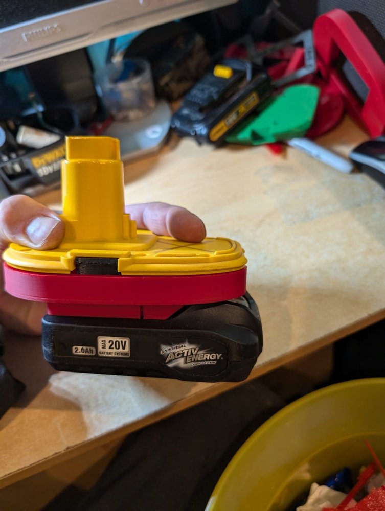

Progress...I think on the Ferrex to (old style) DeWalt. A couple of renders of a one piece amalgamation.
The face that abuts the original, yellow DeWalt, "tower section":
The underside that takes the Ferrex battery:
I've given this to my lad as a .stl to try and figure how to print. He's currently cursing me
Considering what supports / support filament etc.
We're going to try it whatever on the X1C but in all likelihood this will become a 2-piece print with threaded heat inserts and screws to put the parts together.
Considering what supports / support filament etc.We're going to try it whatever on the X1C but in all likelihood this will become a 2-piece print with threaded heat inserts and screws to put the parts together.
