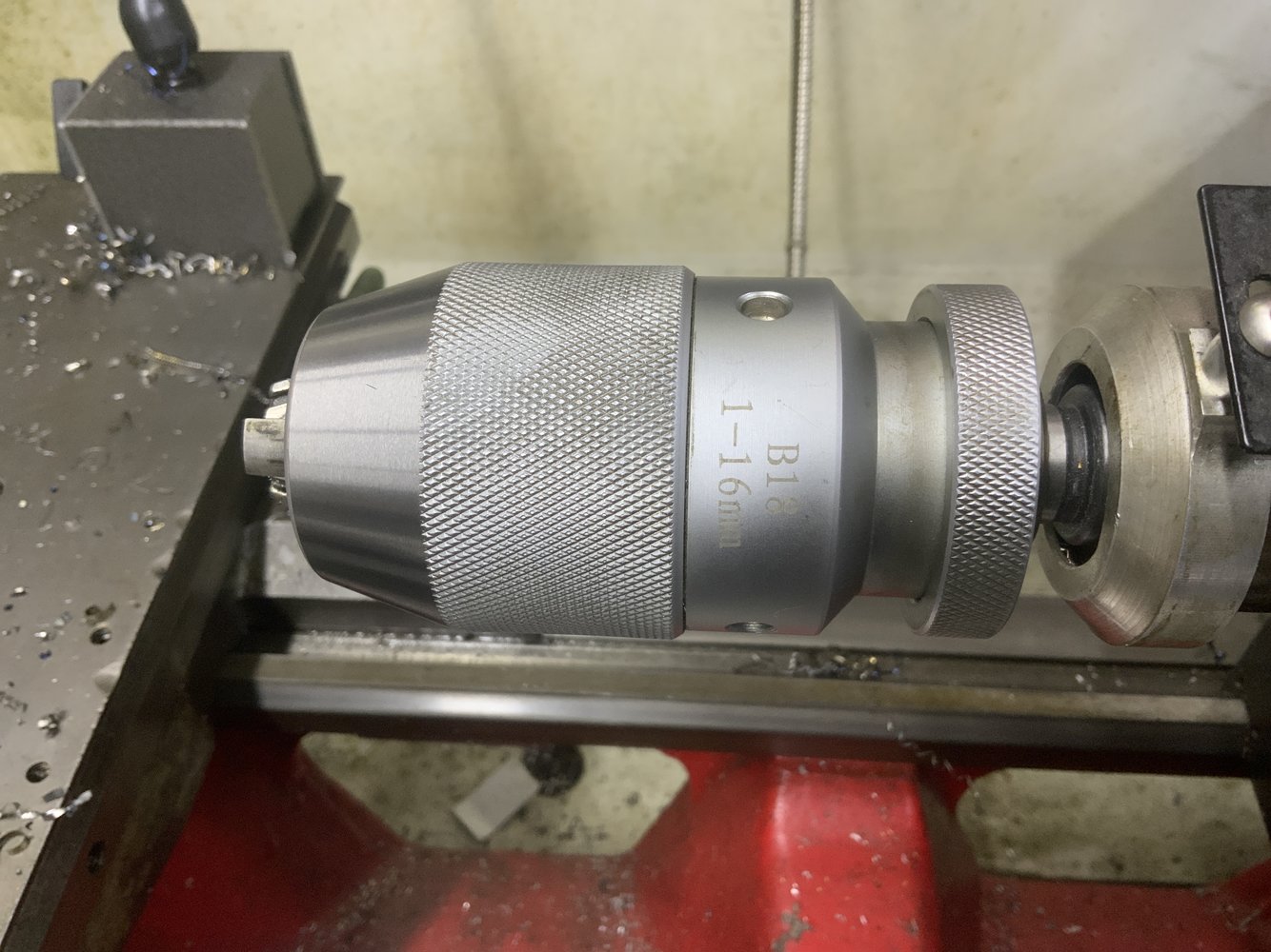

I have one of those. Very good chuck indeed.Ive a couple of HMB keyless. MT3 and MT2, less than 40quid a piece. Have to say they are very nice in movement, don't mark the shank and I can't remember a drill slipping in them. 1-16mm
The closest to match those tables for my WANDESS spindle,is a b16 mount,all I can find on e bay is a chronos and a metabo. Thanks @Agroshield .Maybe it is worth noting to anyone who might be interested in these that the B-taper in them is relatively modern and relatively non-UK or US.
So if you have an older drill press, these are unlikely to fit.
See above. Mr Nickk would need to give more details of his machine. If it is of UK-origin and old, it is most likely a Jacobs taper on the spindle. If it is a B&Q special from the last 20 years, it could well be a B-taper.
See: http://www.tools-n-gizmos.com/specs/Tapers.html
