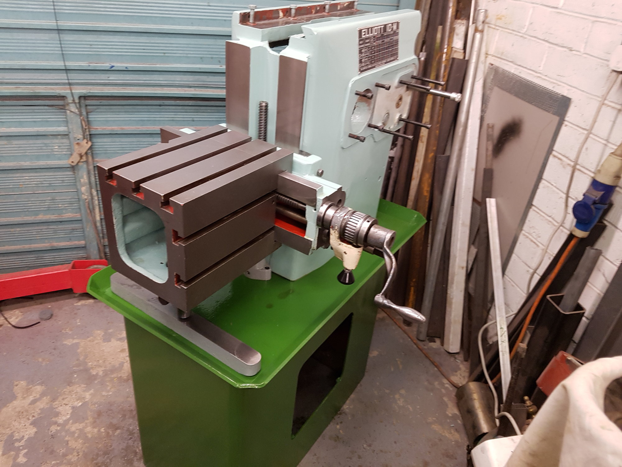

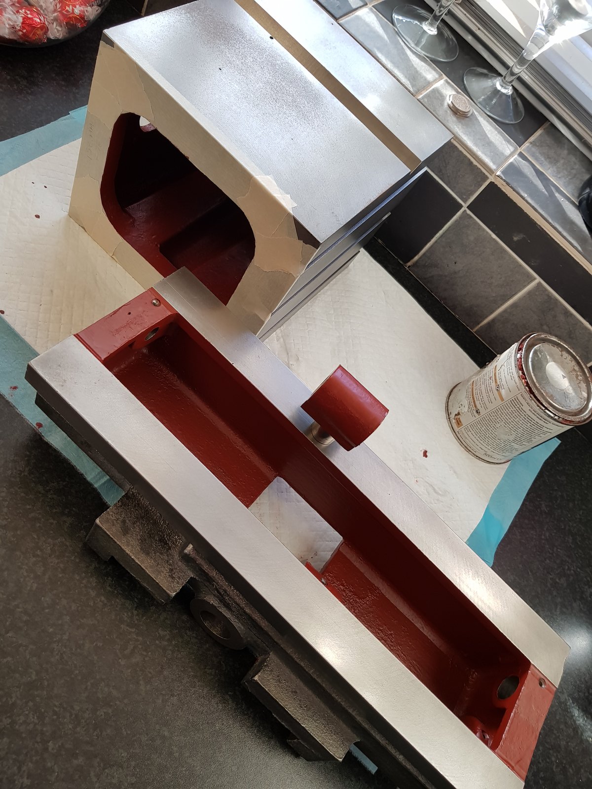

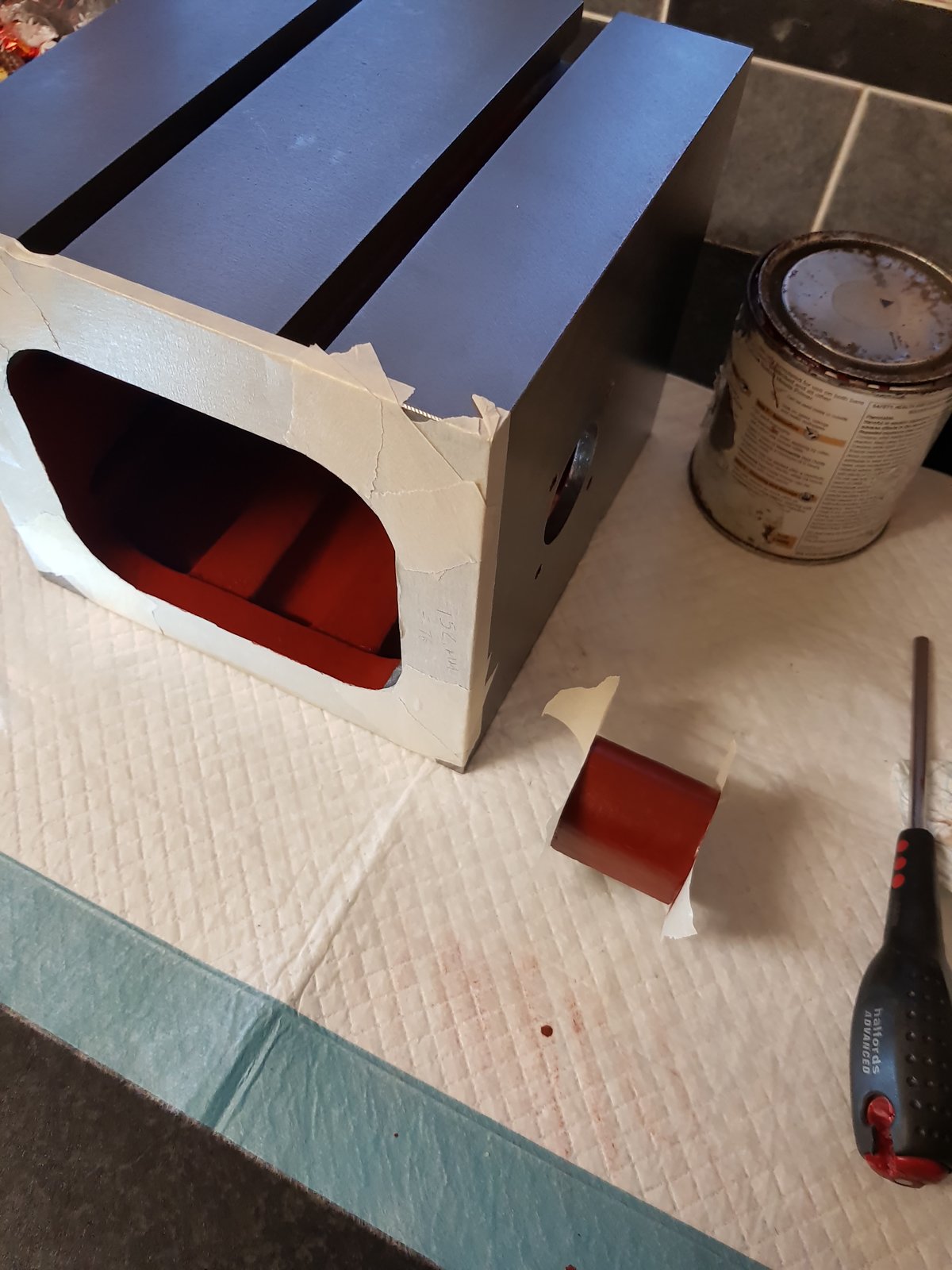

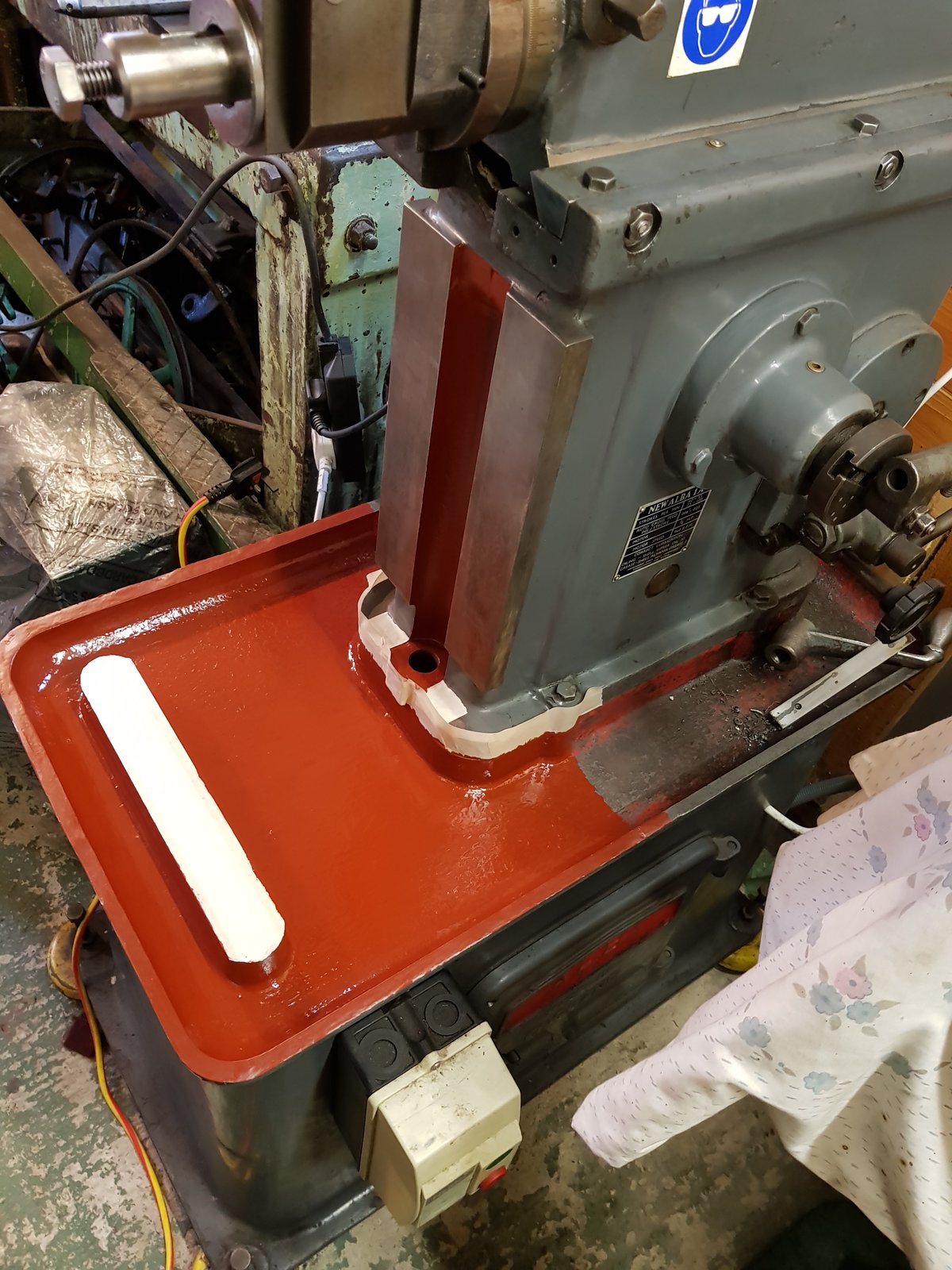

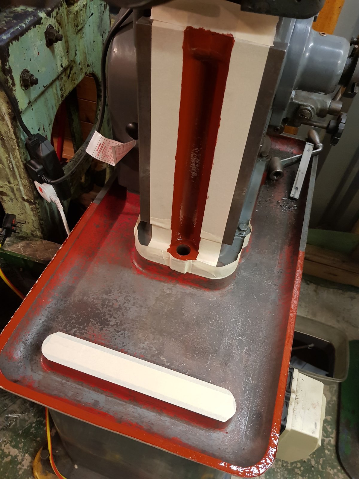

I did think about painting the outside of some parts. But it's going to get covered in crud and chippings. Plus finding paint is a joke and prices are stupid.
Thanks. Yes it be good to see picturesI'm at the same stage as you with an Elliott 10m shaper but i'm having the ram reground i'll show some pics later keep up the good work i like the pics
Looking good. Nicewaiting for the ramView attachment 127943

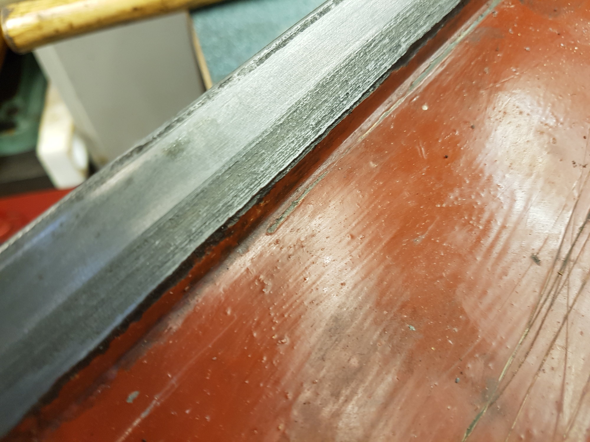

Yes that's definitely been run dry. How much is being ground offit had been run dry and it had picked up so it needed grinding i'm going to do a bit of scraping on it when i get it back. here's a picView attachment 127970
Neither my Alba shaper or my Atlas lathe have any flaking, just plain ground ways, I often wonder about that.![]()
Post pictures when you can. Always good to see another shaper buildhe's just going to grind enough off to get rid of the bad bits i would have thought about ten thou but it dosent matter cos it's the gib side. all the other surfaces are good. the gib needs grinding aswell
You don't want to flake the ram, just the short ways. Exposed ways can collect dirt in the flaking but closed ways are not exposed to the dirt.
Short ways? me no unnerstand!
The ram has long ways because it slides back and forth on the short ways of the shaper housing.
