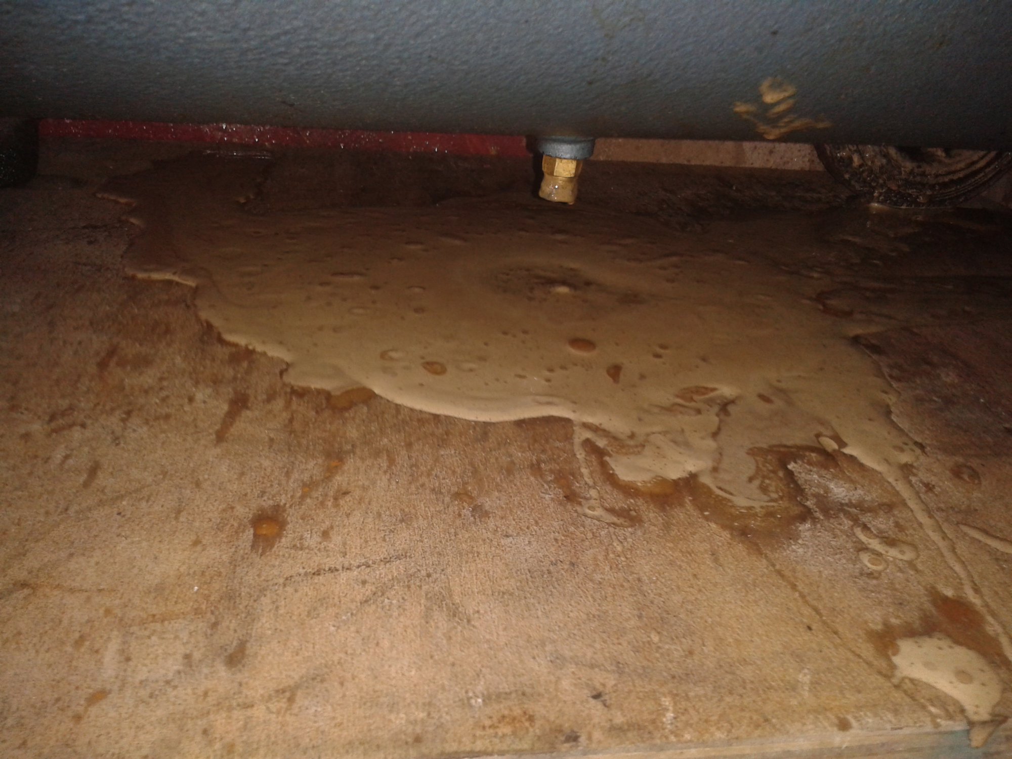

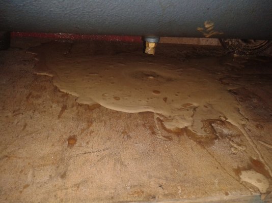

differential pressure its called,... good switches are about 1 bar cheap ones 2-3 !but, the truck is you adjust the pressure valve, so instead of kicking in at 80psi and out at 120psi it kicks in at 100 (still off at 120)
I wish! I bought it as spares or repairs and found the motor was fubar but it is in as new condition, not a mark on it!He probably sold it to you because he thought it was going tits up and knew nothing about the receiver filling with water.![]()
