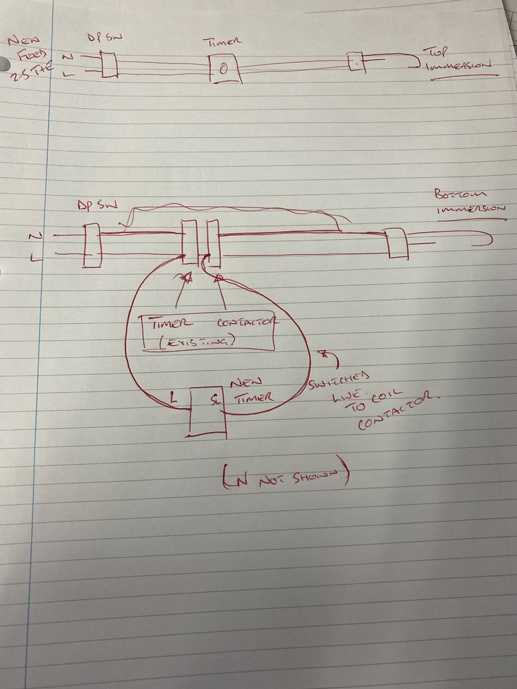

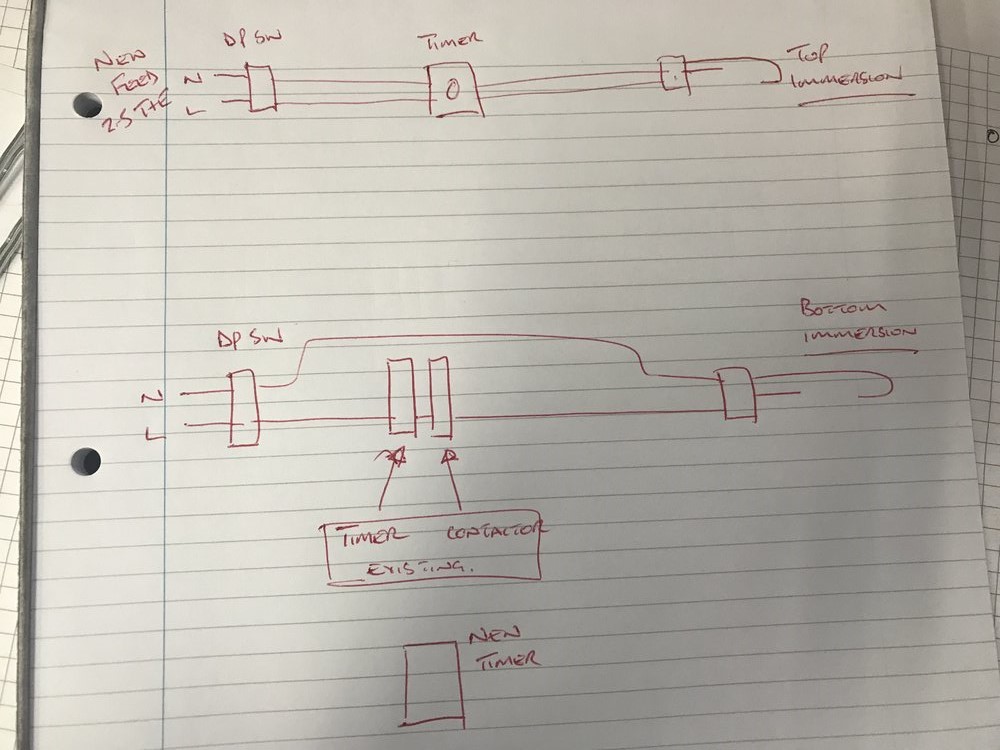

Yep that will do it, contactor and timer for boosting the water to kill off the legionaires.
You may be able to alter the timer to come on for longer or more times in a day to get a longer time heating the tank, but from this I would say that the immersion is independent from the ASHP which is what I first thought.
