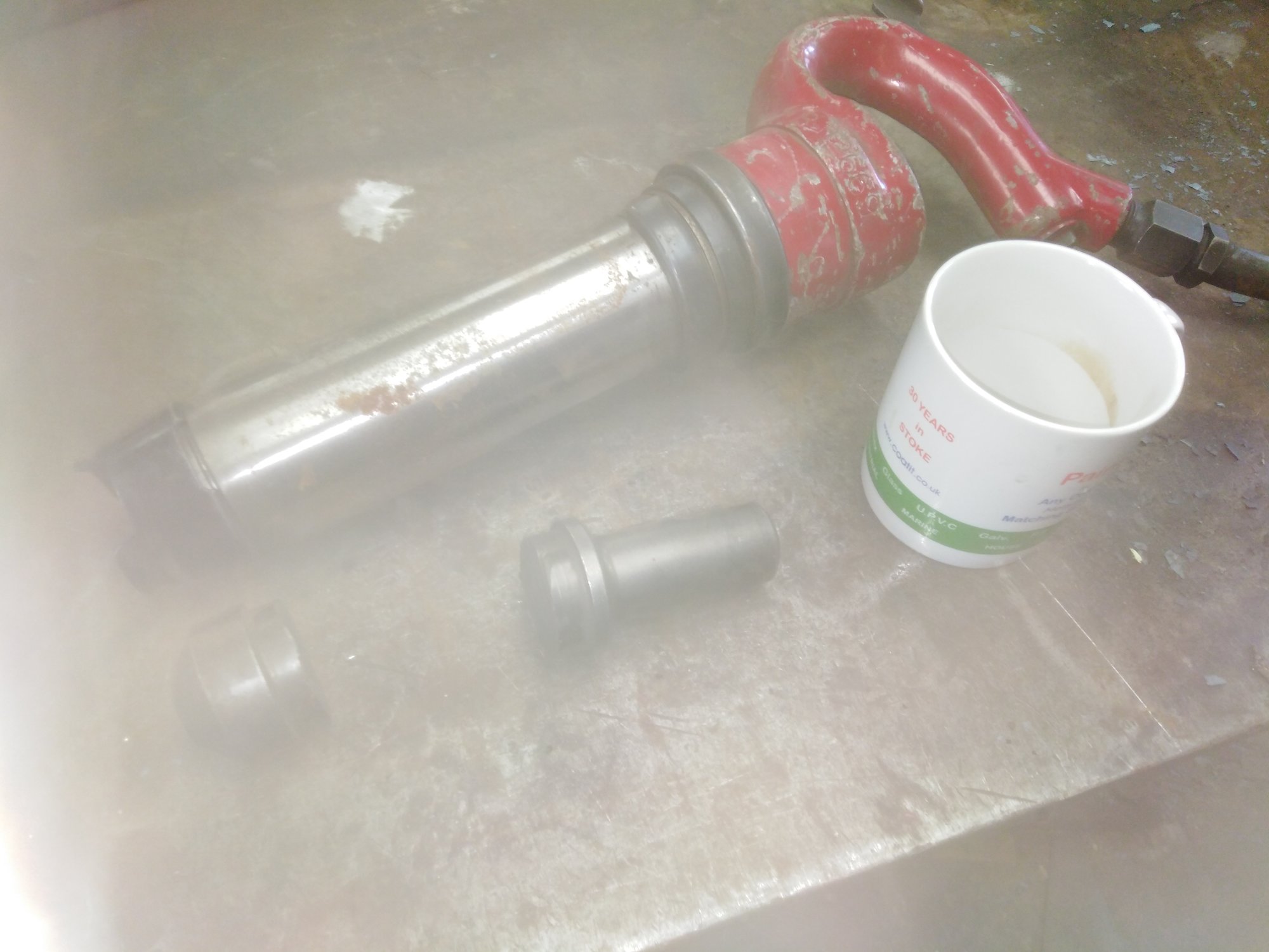

I have a large American made riveting hammer (please excuse pic, I cracked the camera lense this morning). You may be able to make out that the rivet set die has boosted. It's my own fault, I ground a portion off one side to work closer up against section sides, this appears to have caused a stress riser where I left a slight ridge. It came as a bit of a shock when over 1 1/2" of tool steel fell in two
.Soooooo, does anyone have any suggestions as to where I could source a replacement in the UK. Its like big riveting gear never existed in this country. Would turn up my own if I could find suitable shock resistant tool steel but I would probably need to have it properly heat treated after.
That rivet set is 30.88mm shank where it fits into the air hammer so it's big stuff.
