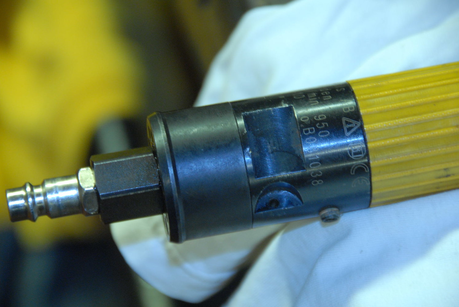

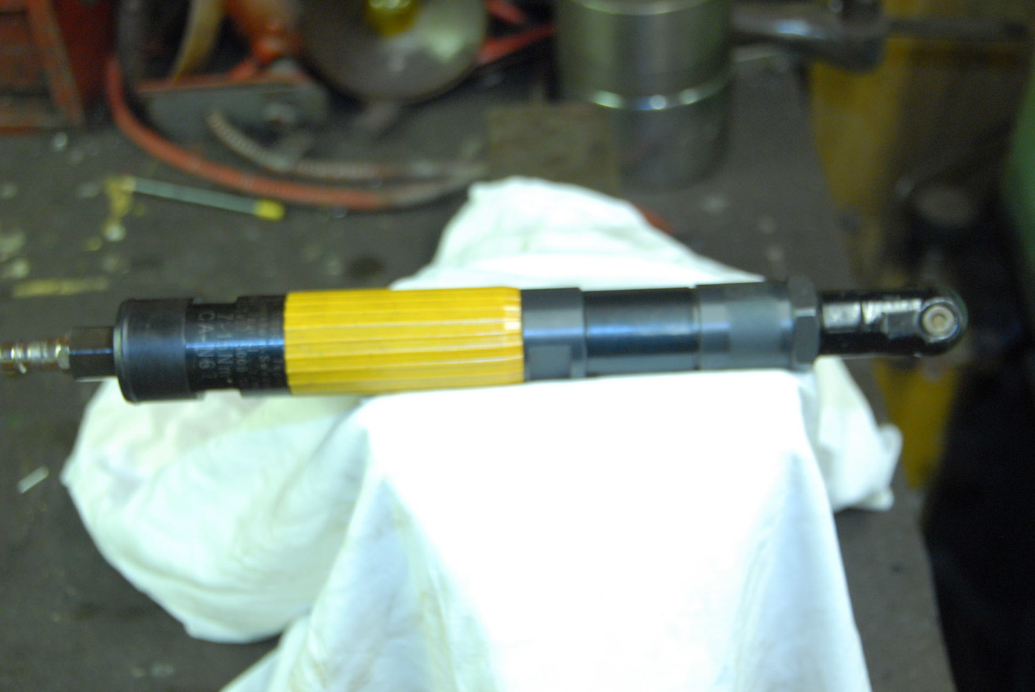

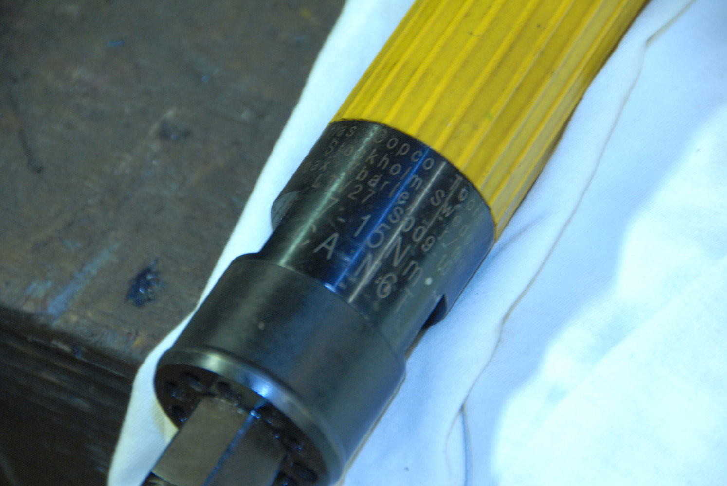

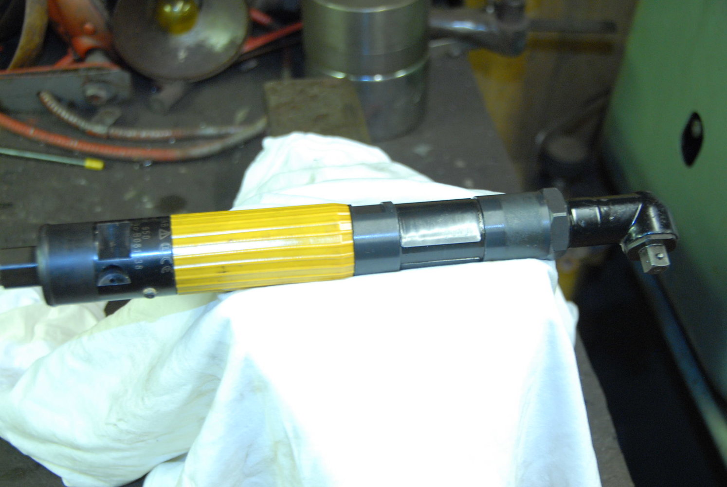

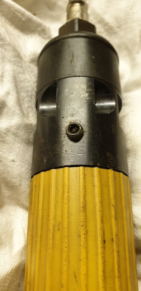

good point I dont think it reverses just one way, there's no turn nobmight have come off an assembly line doing a dedicated task
"Theres no knob on this"...."there is on the end of it" he answered. think about itgood point I dont think it reverses just one way, there's no turn nob
"Theres no knob on this"...."there is on the end of it" he answered. think about it![]()
Spot on BobIt’s a nut runner.
Bob
will check out the trigger bypass when I get a minIt's an Atlas Copco,
Part number might well be ltv26sr006
I expect it's come from an assembly line where it was doing the same job over & over.
For production you can set the incoming air pressure to achieve a desired torque.
It's possible that the trigger has been bypassed and it was previously used with a pull down or foot switch. Does it spin up if you plug it in?

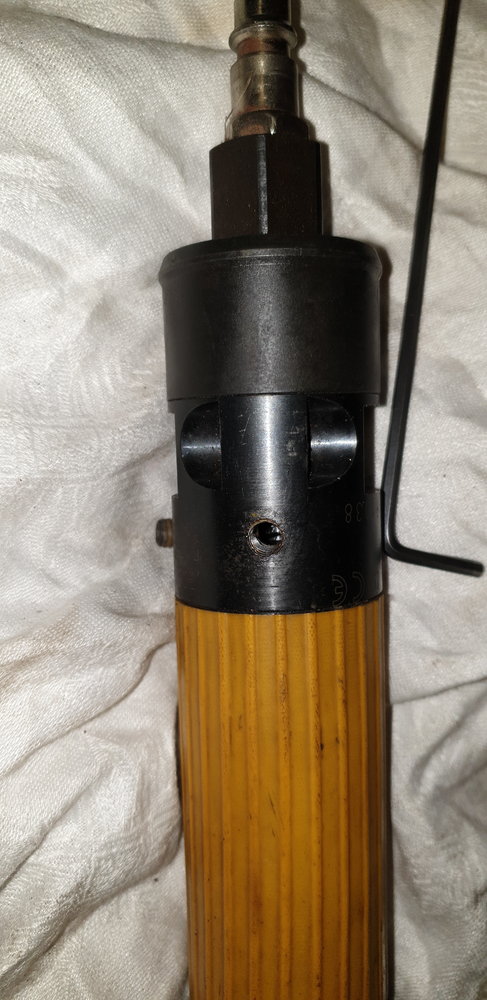

will check out the trigger bypass when I get a min![]()
Try it on the air line again with that grub screw removed and see if it still runs.
Maybe wrap a towel or something around it incase anything blows out of the hole.
