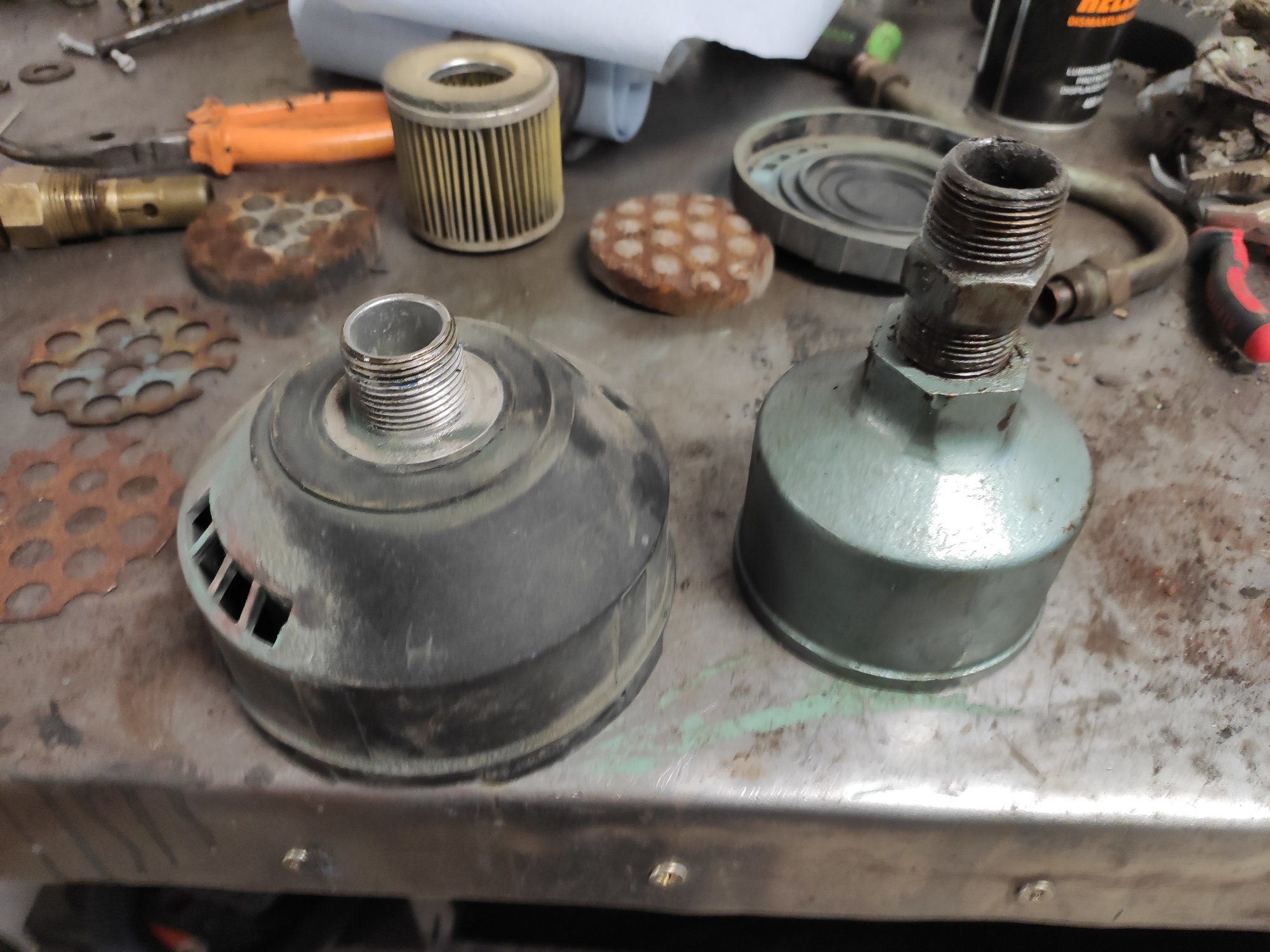

    I've an older Ingersoll Rand type 30 compressor, which needs a new air filter.
    The new filter will cost about £20 including postage and vat. It's the felt pad type and it takes 3.
    Is it possible to replace the filter housing with a canister type filter, that takes cheaper filters?
    It's the same thread as my Clarke compressor, but I can't find a source for the housing on line.

    Give Clarke Service a call on 020 8988 7400 give them the model number of your clarke compressor and ask for a price for an air intake filter assembly
    They're not expensive, its been a year or two since I bought one but the housing was around £6 without filter at that time.

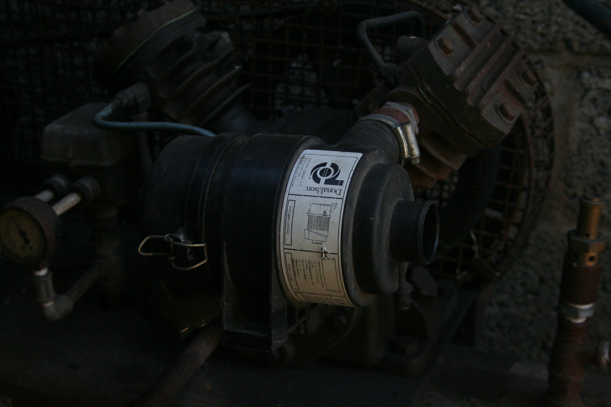

  11. Cobbler

    Didn’t someone on here fit a car oil filter?

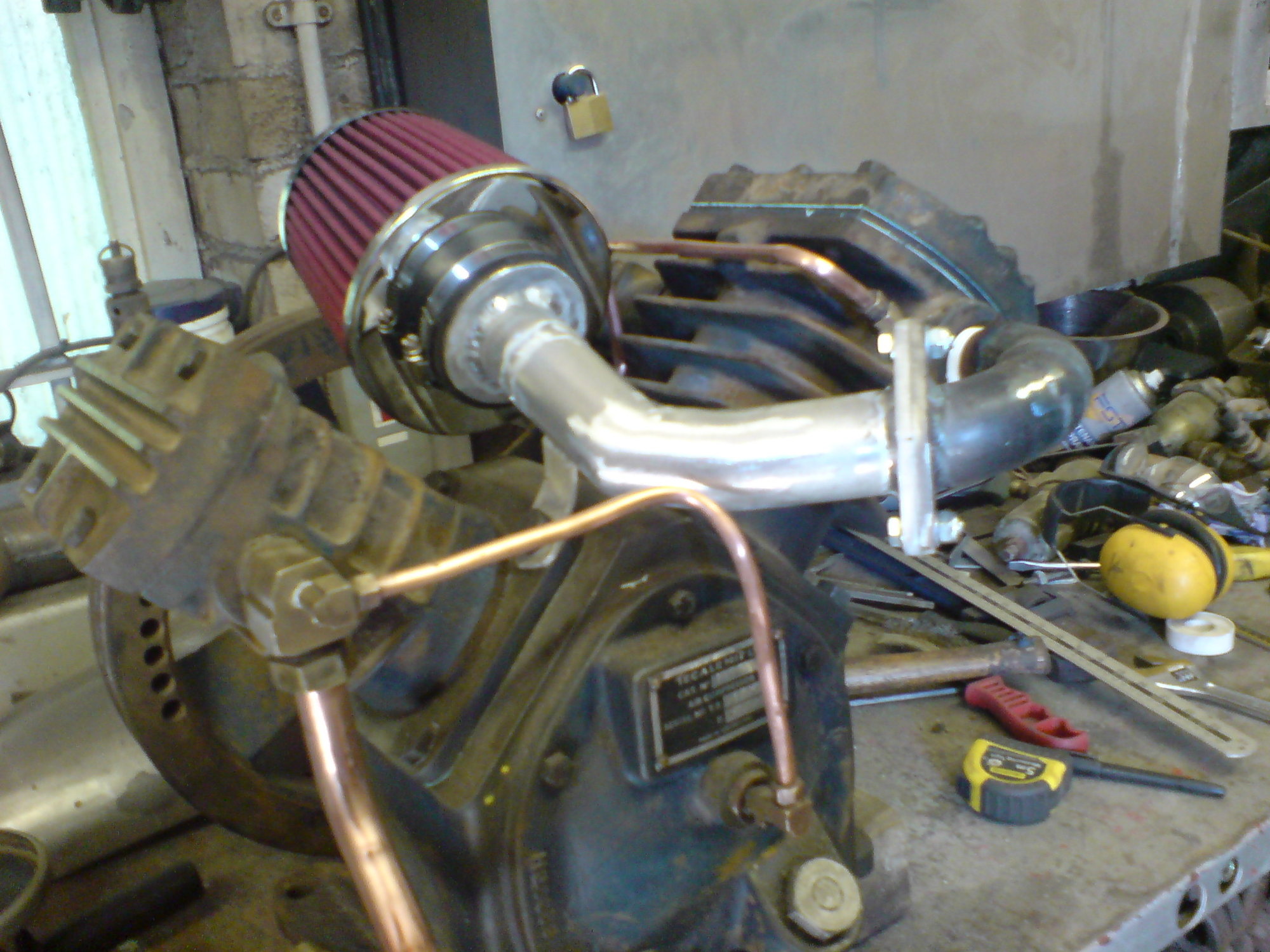

    I used an air cleaner off a diesel quad I had kicking about.
    The filter elements last for ever, are cheap, have less air resistance and best of all are much quieter than the standard felt jobby.
    An air cleaner off any engine will be better than what is supplied because part of their purpose is to reduce induction noise. (Unless it's the boy racer type @wyn used :laughing:)

  14. dannyp Member
    i wound an new old stock oil filters on mine, the small one has filters off some car the type 30 i think has a hydralic return filter on it

    I've ordered a new housing from Clarke/ MM.
    Less than £40 including two filters. The only problem is that they're not in stock, and the delivery is very overdue!
