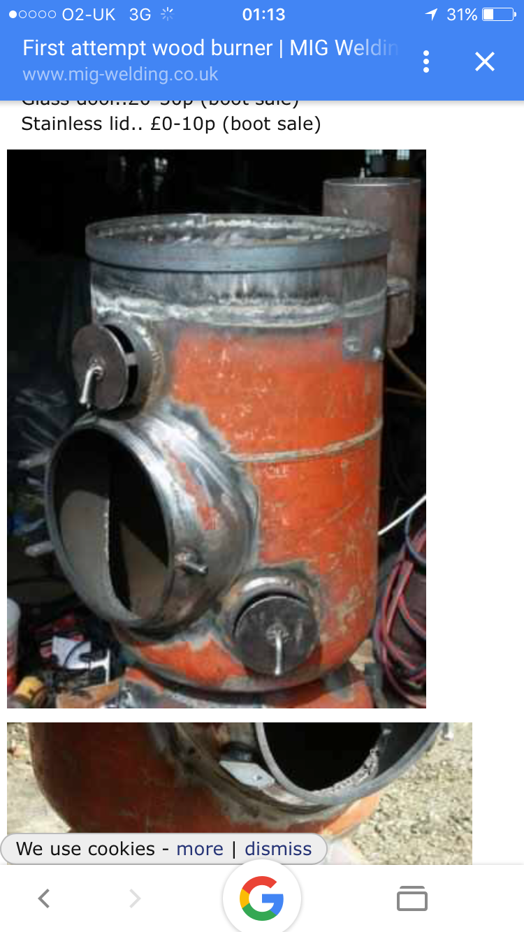

Gramas Member Messages 77 Location Northumberland Oct 30, 2016 #1 how have folks made these? Struggling to find any ideas / detail pictures etc IMG_9700.PNG 1.1 MB · Views: 99

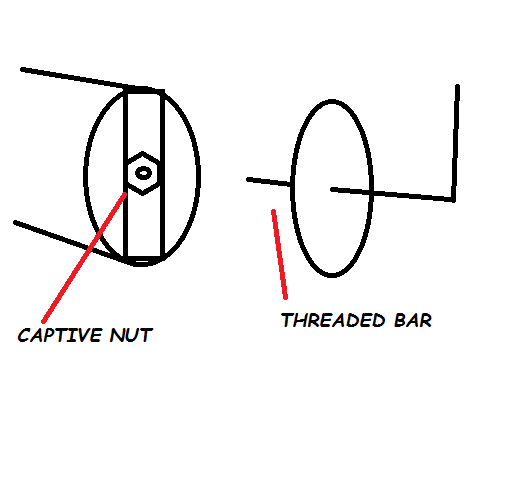

Gramas Member Messages 77 Location Northumberland Oct 30, 2016 #3 These aren't like the ones one picture I posted, need to work out how the work/ made internally gaz1 said: Click to expand...

the snooper getting older by the day Messages 21,078 Location Hull UK Oct 30, 2016 #4 They are only simple butterfly valves, a disc of steel and 2 holes through a tube for the spindle
Gramas Member Messages 77 Location Northumberland Oct 30, 2016 #5 the snooper said: They are only simple butterfly valves, a disc of steel and 2 holes through a tube for the spindle Click to expand... Worked out how to do them in picture I posted Bsp fittings

the snooper getting older by the day Messages 21,078 Location Hull UK Oct 30, 2016 #6 simple things really the captive nut would need to be set further back though
Screwdriver Member Messages 10,735 Oct 30, 2016 #8 Looks like a simple threaded stud going into a captive nut. I assume the nut is fixed to a strap inside the flue pipe. The round baffle has wings fitted to keep it aligned as it screws in and out of the pipe. <edit> yeah what he says

Gramas Member Messages 77 Location Northumberland Oct 30, 2016 #9 the snooper said: simple things really the captive nut would need to be set further back though View attachment 93990 Click to expand... Perfect Cheers snooper
