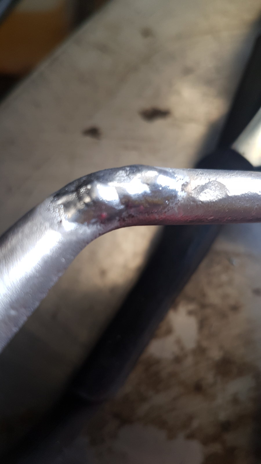

    My Volvo has a small hole in a bend on the 10mm ally pipe. I don't want to spend any more money on it as I need to sell it but ideally with air con working. Is it feasible that I can use a 10mm compression joint??

    I welded up a small ali aircon pipe for someone a while back, so that's an option if a fitting won't work.

    ideally use a Vulcan Lokring joint but the pliers will cost more than the cars worth! you need a proper car or bus AC specialist , also the system will need evacuating as said above so cans from halfrauds no use whatsoever.
    could tig the pipe , it should be purged whilst welding to stop scale on inside of pipe and if its been open any significant time a new drier cartridge , AC cheap repairs suddenly get expensive if they go wrong

    Could you use one of those aluminium brazing rods instead....I once built an entire water pump lug with the stuff and it's held ever since.
    Impressive stuff....the price is impressive to but for a one off job maybe worth it?

    I've used SIF555 on one occassion. It's very impressive. It was interesting to see how much more tough the repair was compaared with the base metal. It's well worth having a few sticks to hand.
