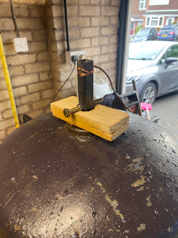

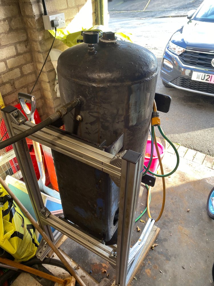

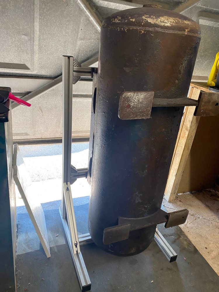

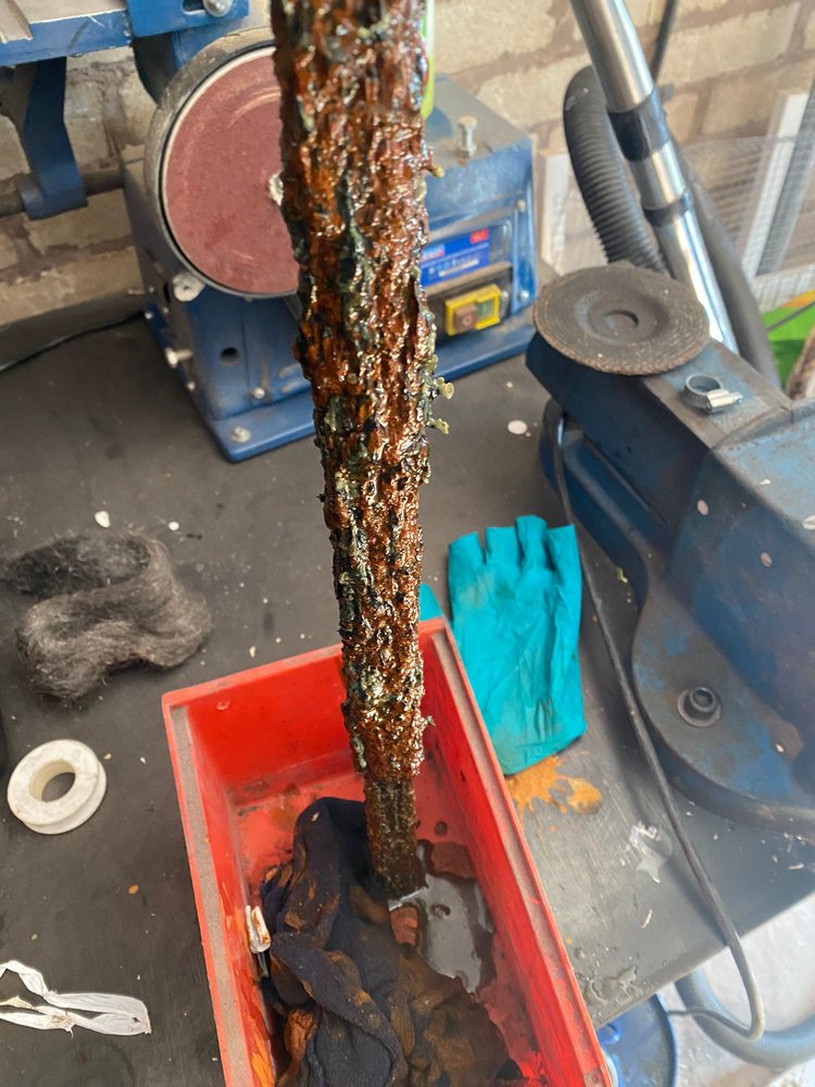

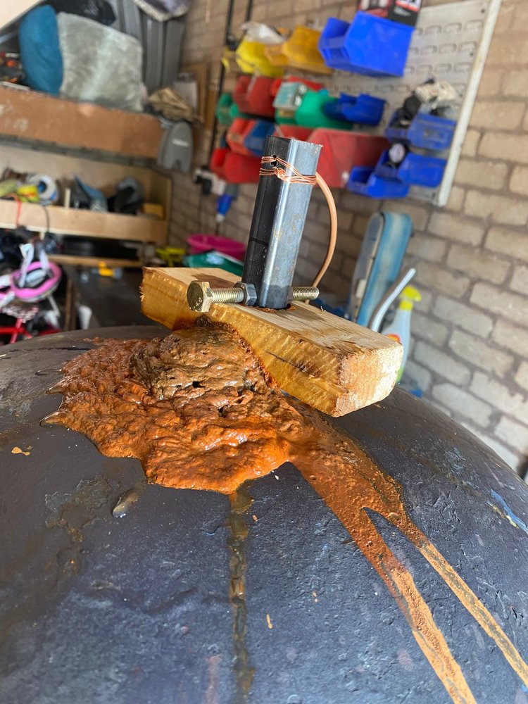

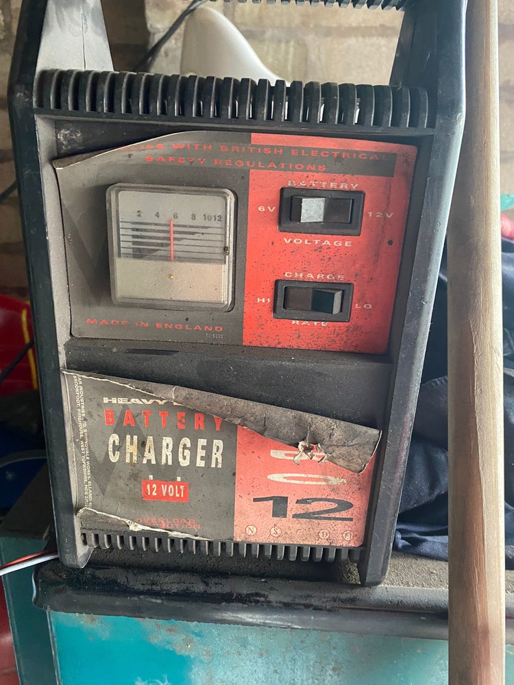

) hooked the positive up to the 1" and the negative to the body of the tank and lets the process run.
had to drain the whole tank to undo the plug and reseal and then fill back up again, got to 300psi, it this held for 20 minutes so SUPER HAPPY
Deep down I know I'm over thinking it and worrying too much.it wont explode . if it was badly corroded it would pinhole at the bottom and you would hear a slight hiss of air or it would pee a bit of water out if there was any in under pressure

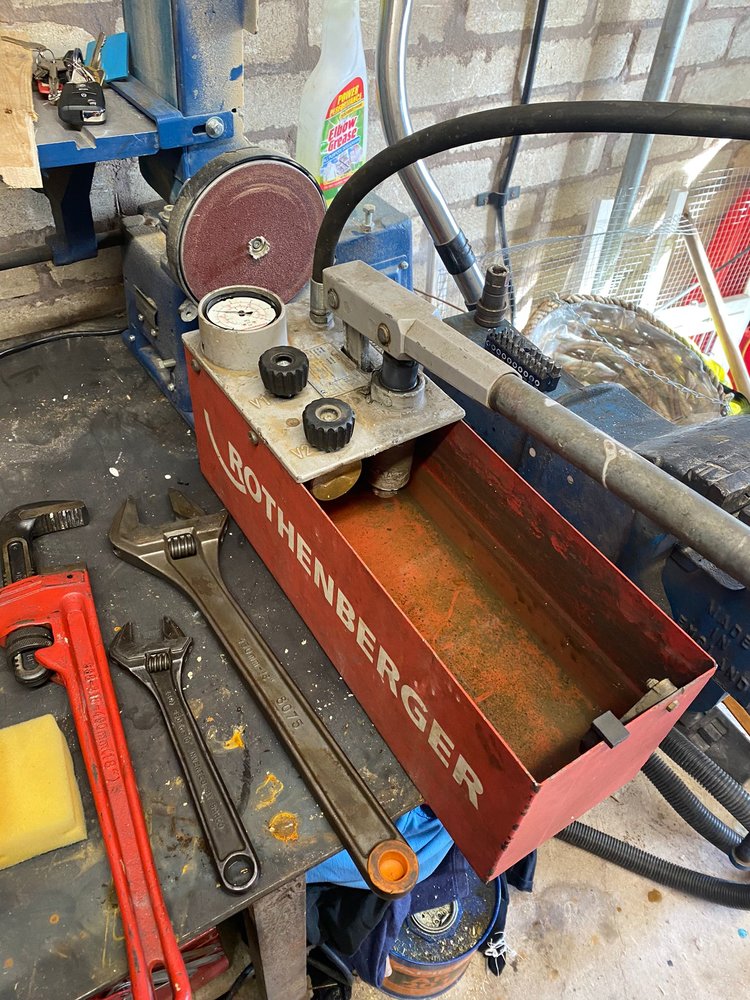

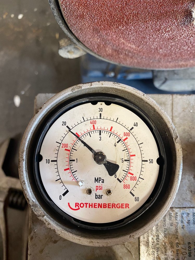

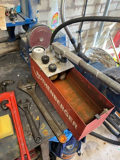

The pump is a rothenberger pumpInteresting on the tank test.
I just did the same as you with a 1975 broomwade, but without the 're paint.

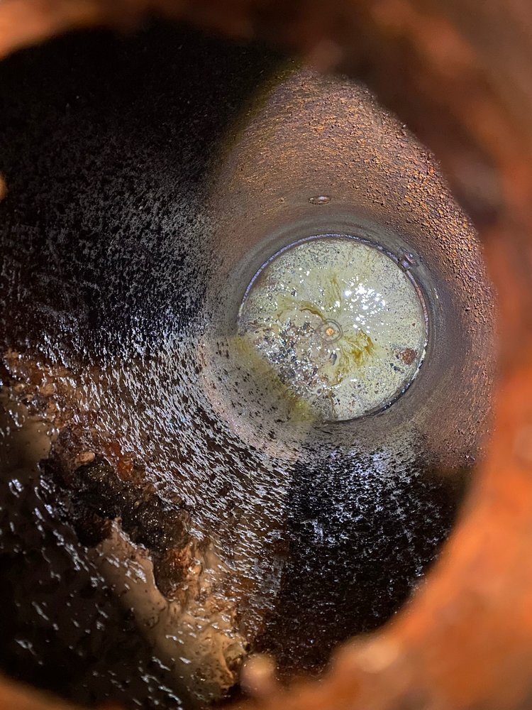

Tank had slight rust inside but is very thick and looked good.
Not took it over 90psi yet though as I really don't want it to explode!
I had been wondering about a home done hydraulic test.
Can you tell me more about the pump?
Not sure how I can create the needed hydraulic pressure.
Manual Hydraulic Pressure Test Pump 50 Bar for Pipeline Container Irrigation UK | eBay
Find many great new & used options and get the best deals for Manual Hydraulic Pressure Test Pump 50 Bar for Pipeline Container Irrigation UK at the best online prices at eBay! Free delivery for many products.www.ebay.co.uk
that’s a link to one that’s similar, in honestly I’m glad I tested it just out of peace of mind. And like you said I’ve never heard of a air receiver exploding unless it’s new thin one but this thing is heavy, thanks for saying it’s fantastic, I’m trying to do my best with what I’ve got available I know it could be better but that’s time an money I don’t currently have.
You only need to watch the accidents shown on youtube to understand that they can fail catastrophically - and make a big mess when they do.
Here is an example :
Insurance companies would not bother with regular tests/checks if they always failed safe (a small leak)

A pump is good for testing. I used a grease gun to test mine the first time (about 30 years ago). A hydraulic press pump can be used (the oil used is not important) or a bleed from a pressure washer is often the pressure source. The grease gun was slow - any air pocket, however small, needs filling and the tank will expand as the pressure rises, but it got there.
