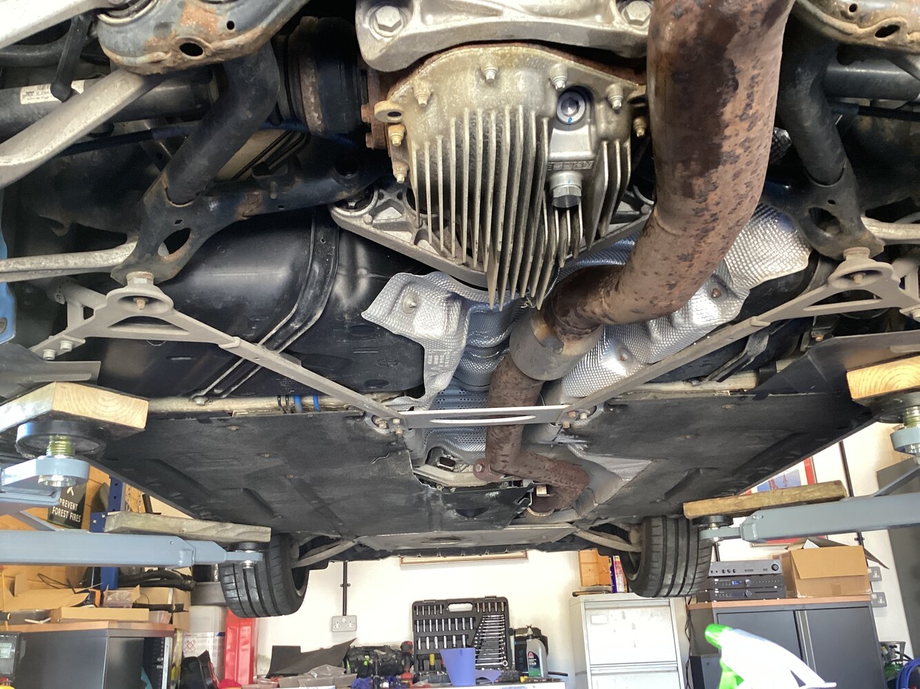

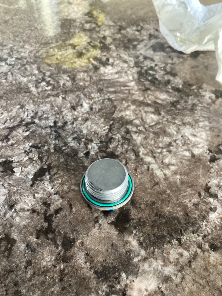

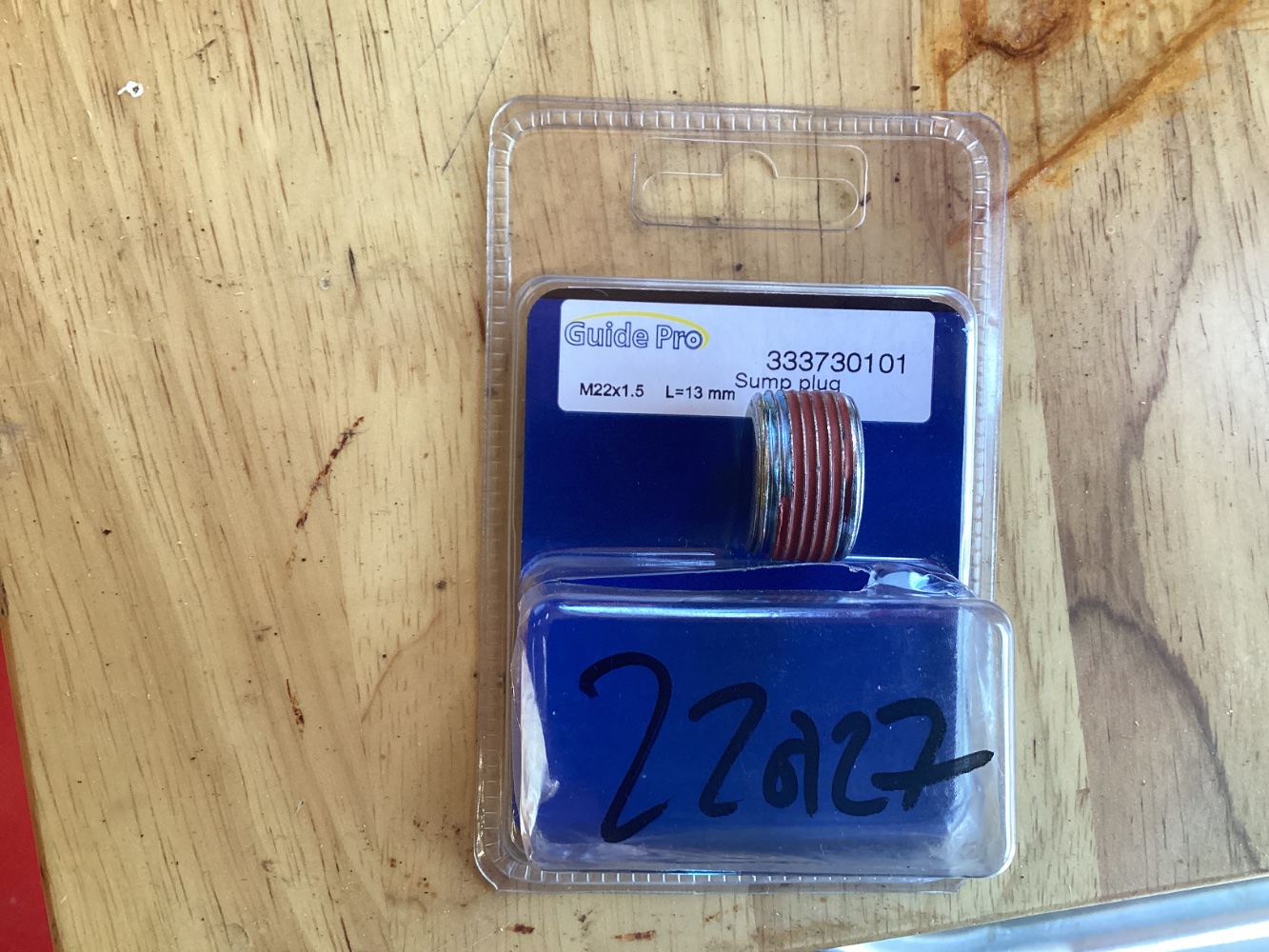

I’ve just replaced diff oil on my M2 and fitted an aftermarket magnetic sump plug.
However now I’m having doubts about it as there’s no mating surface on it other than the threads which have a red sealant on them
Here’s a picture and one of the original, the original gets torqued to 25 NM and has a mating surface with an inbuilt sealing ring.
The aftermarket one I just wound it in until it was flush, it doesn’t butt up to anything.
Think I’ve talked myself out of this now as if that came out when driving I’d be needing a new Slip diff and they’re not cheap.
What’s your thoughts?
