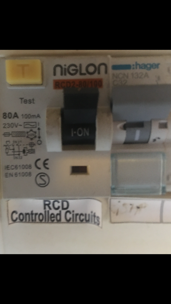

The first photo is the main one I think. Then their is another one next to it in the 2nd pic.
I had the photos on My phone already.
I’m not to sure what the2nd unit is for Myself.Yes the first pic as you say is your main consumer unit and then you have the second one which I can’t make out what it supplies. It looking like there is a little bit going on to start with.
As said how far is the workshop away from your consumer unit?

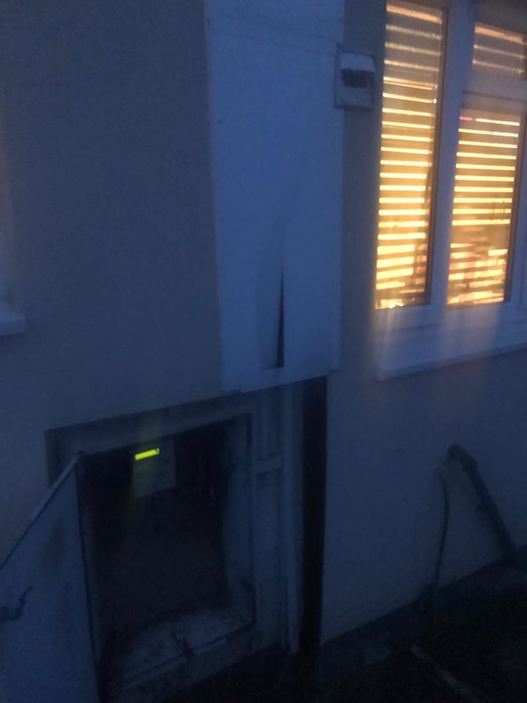

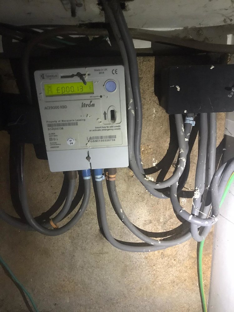

Thanks for the reply.the meter and earthing arrangements at supply would help theres 3 diffrent types of supply
I am really not sure. I will have to contact My electricity supplier to find the answer on that. Soon as the bank holiday is over I then can report back here and give an update.either the electricity board provide earthing and a n earthwire from the cutout to your distribution board or a tt overhead supply with no earth and you have an earth rod in the ground outside and wire going to the fusebox
No need for that if you can get us a pic of the electric meeter and the wider area ware the wires go in and out we should be able to tell you what’s going on.I am really not sure. I will have to contact My electricity supplier to find the answer on that. Soon as the bank holiday is over I then can report back here and give an update.

Appreciate your input thank you. I will upload the wiring from the opposite exterior wall out of interest if this will help.Let's go for a random stab in the dark.
