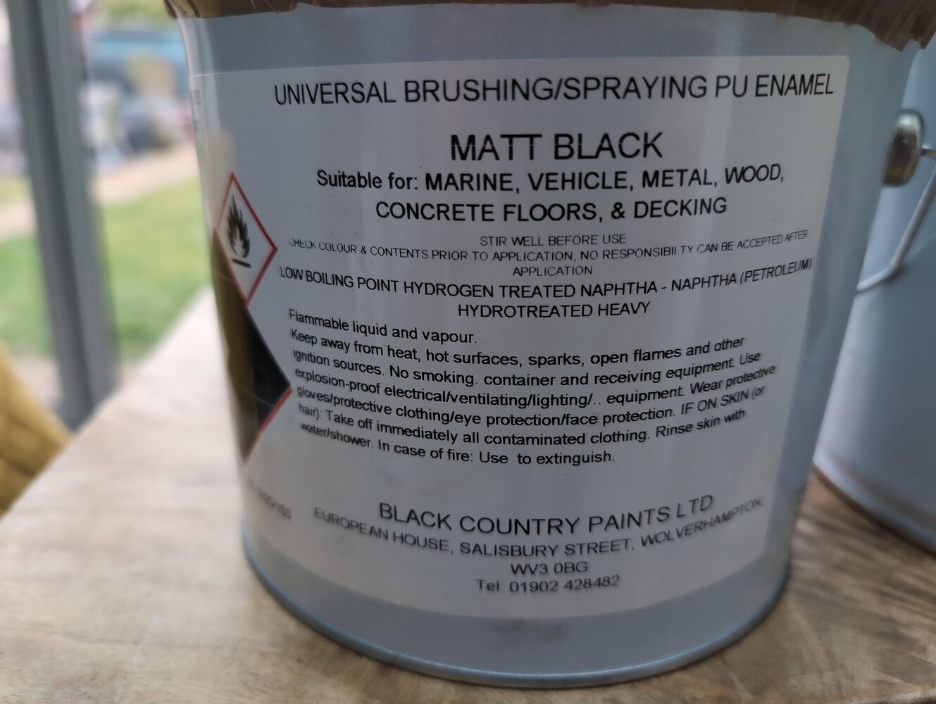

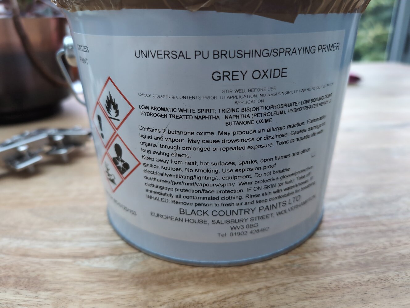

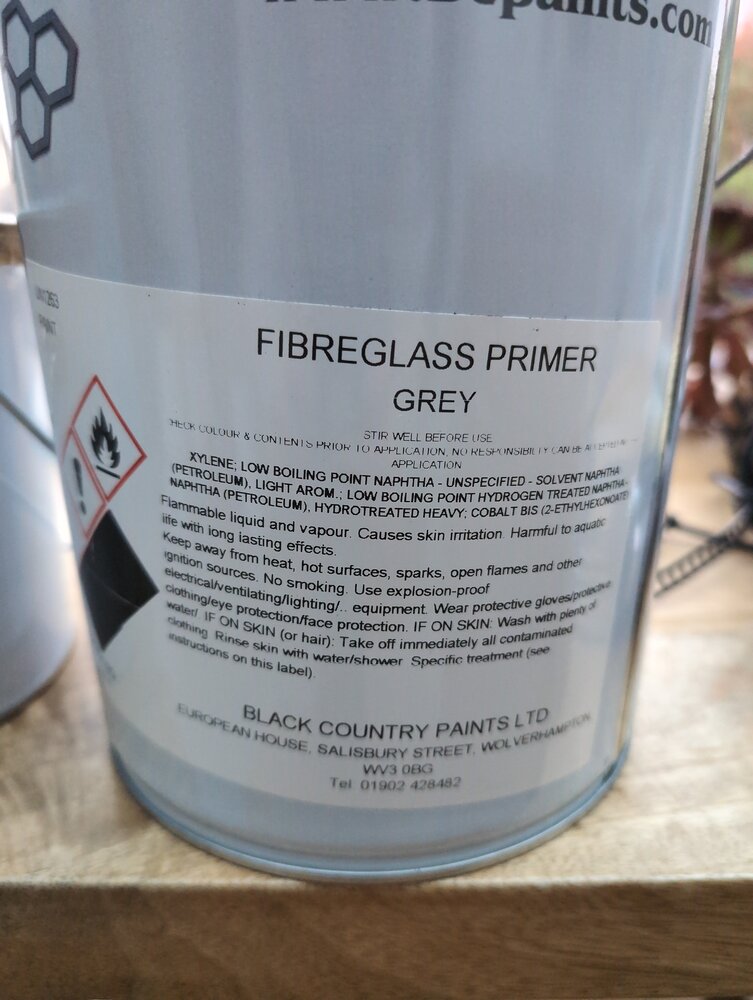

Hi all,
This year I hope to be painting my project car. It's a fibreglass body.
I'd like to paint it with polyurethane paint, a bit of research suggests it's hard wearing and works well with GRP bodies.
I'm going to use a paint roller for the interior parts of the car, however would like to spray the exterior (in sections).
I am trying to avoid the paint with Isocyanates in it, so I can spray.
Does anybody know if a single pack polyurethane paint needs a full forced air fed mask for spraying?
The paint I'm hoping to use is here. https://www.taindustrialpaints.co.uk/products/1k-polyurethane-paint?_pos=1&_sid=62721885c&_ss=r
I can't find much in the way of safety on the Web page .
Thanks in advance
Thanks in advance
..... But for that paint I'd probably just use A2/P2 filters on a half mask, but loads of through ventilation or paint outside when weather is warmer. Let us know how it goes
