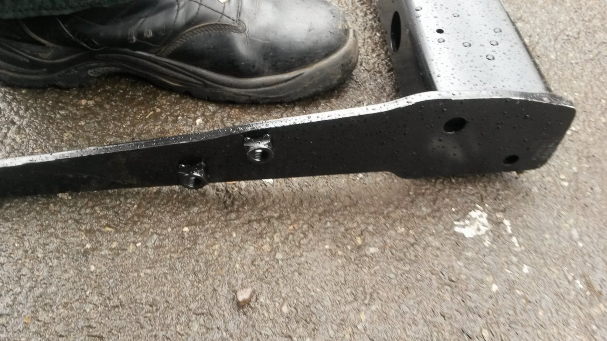

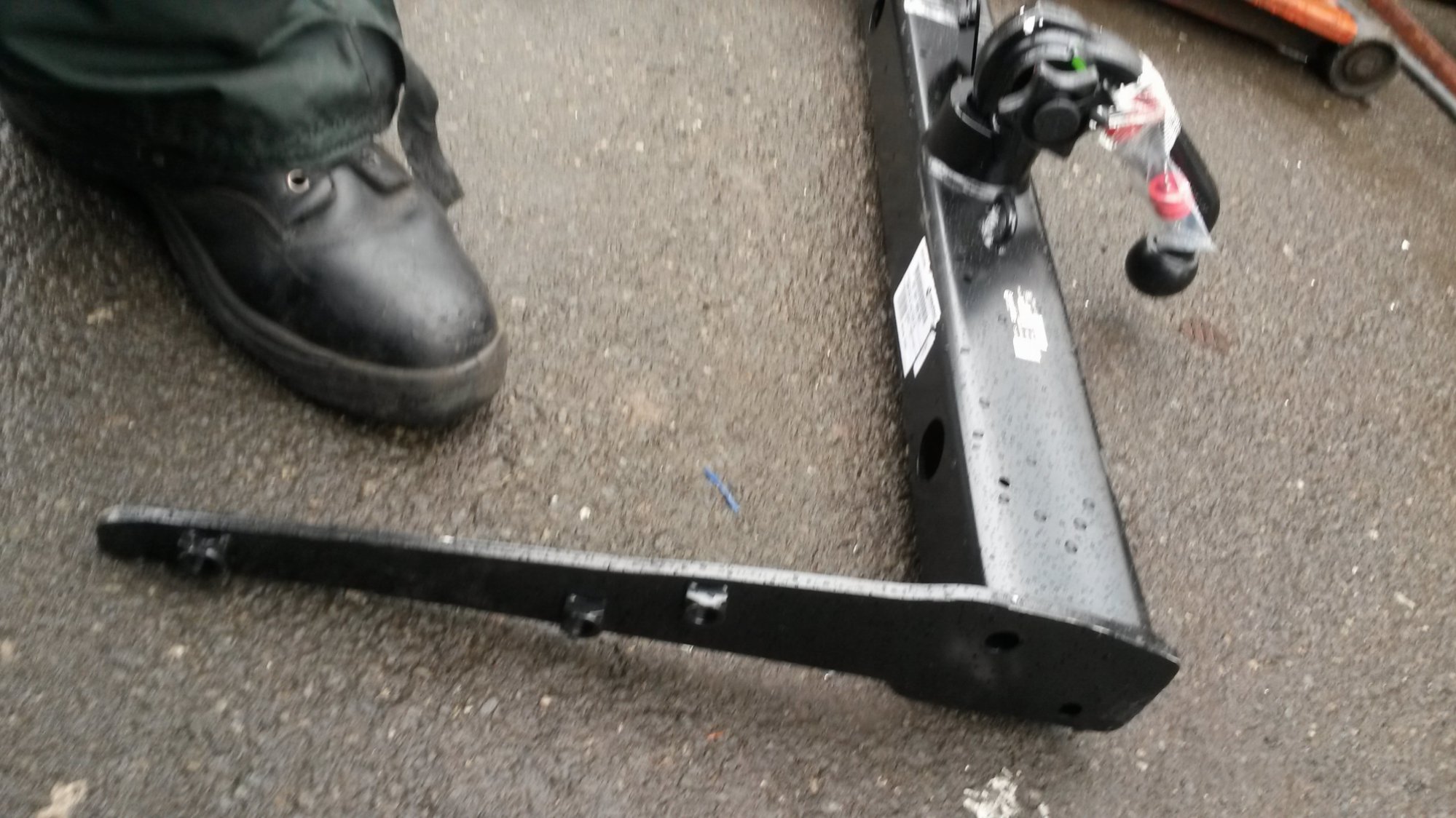

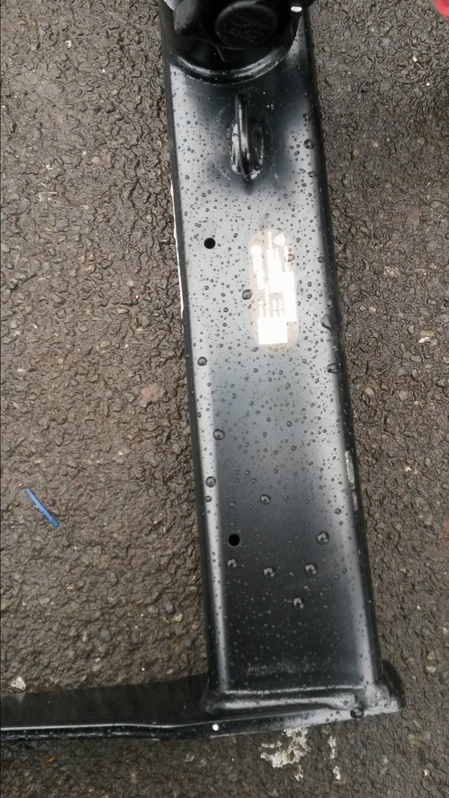

Hi just a thought on tow bar legalities here is one I fitted to a vw transporter last week note the sticker on the bar that is all that tells anybody this is a legally tested towbar how long will that last? it is on the underside of the bar so will get scratched the first time a jack is used on it. and the paint will soon deteriate with the weather etc, the other sticker ia a paper one and is nothing to do with the legalities
the side plates went inside the chassis which was approx 1.75mm to 2mm section channel, with no washers on the 3 bolts per side or load spreading plates !!
obviously this has been tested but didnt look that strong to me to have 3 tonnes or more swinging around on it
PLUS the QR ball had two 6mm sprung loaded ball bearings which kept the adapter up in the socket of the X member and took the full nose weight of the trailer, that didnt look that strong either, against a properly bolted tow ball . I for one would not like to trust that system for very long in the harsh winter conditions etc
The point here is as said before, there are many like this in scrap yds etc that are re used, when the stickers are gone who is to say or prove that this bar was 'professionally' made?
I personally would have made bar this considerably stronger if I had been designing it.
