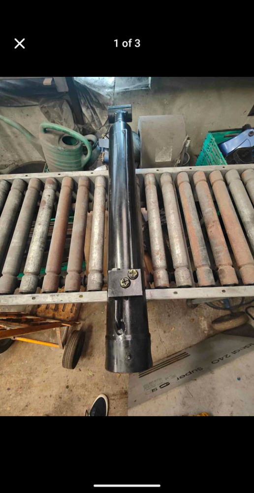

My pump is a 2 stage 22gpm on a 16hp engine and only servicing this one ram on a log splitter. Is there any downside to what I want to do?Pumps will typically have bigger ports than rams because a pump will typically service more than one ram/motor simultaeneously. I would leave well alone.
Yes I want fast approach and return, please explain the recycling valve to me a bit more, I don't fully understand itReally no need to
I do make hydraulic rams so speaking from experience .
If you pump was producing to much flow for the pressure relief valve in the valve block you’d need to put a diverter valve in but
I can see with the two stage pump you want very fast approach before going on load .
You can put a recycling valve in to take oil from the return circuit and feed into the out stroke and visa Versa
Damping? These terms are all new to me lolOn looking at the picture with my glasses on I can see the feed pipes and see your concerns but I’m sure you’ll be ok as velocity goes up to flow is ok
Another problem with over sizing holes is loss of damping
Both intake and outake are 3/4how big (or small) is the smallest orifice in your control valve?
Overthinking this.Both intake and outake are 3/4
