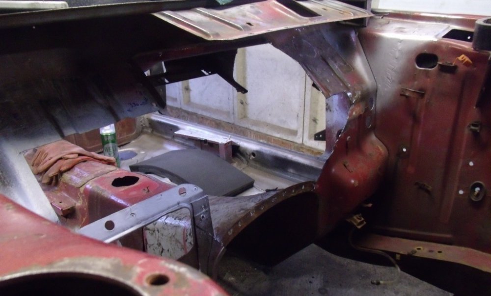

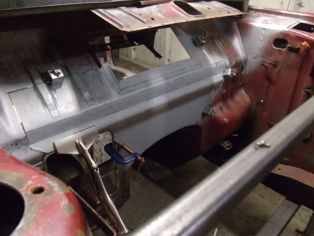

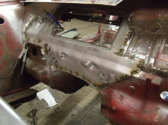

Cheers Mike. Yes mate I am aware I will need to brace the car. I have some 20mm square sections I have been using, on the door openings, etc. The car is also braced inside and on both front and rear subframe mounts. So hopefully movement should be kept down.
The car is a 1972 BMW 2002 Tii.
