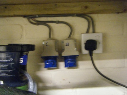

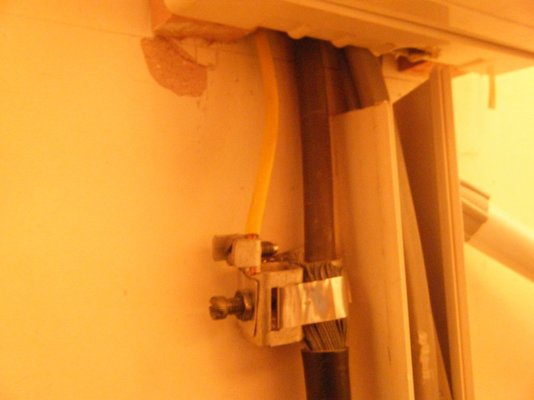

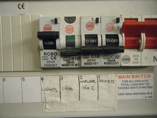

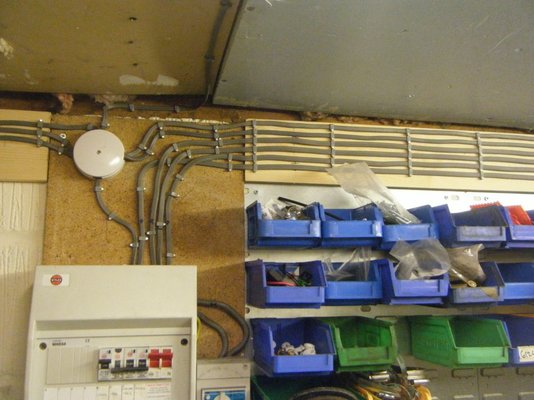

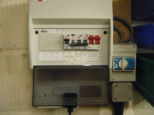

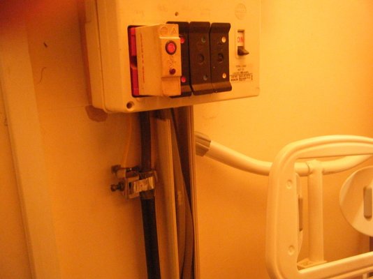

i moved into my first house 7 month ago and just got around to sorting the garage electrics out. I already had a supply to the garage, there is an armoured cable that goes I consumer unit with a 30a fuse under the stairs. this cable then goes under my garden into the garage. before it had one socket and 1 strip light and a metal fuse box. I got my dad to change everything, he is not an electrician but a plumber so has general knowledge of electrics from installing boilers etc. me on the other had have no idea so I have tried to show as many pictures of what has been installed. we have installed a new consumer unit, outside security light, 3 strip lights and 6 double sockets and a single socket on a ring main (wire goes to socket then back to the consumer unit??). the problem I have is my two 16a sockets, one is on a 16a type b rcbo and the other is a 16a type c rcbo (consumer unit and all rcbo came second hand on ebay), the sockets just have a single wire going to them, if I plug my portamig into the c socket on the higher settings it will trip the rcbo, if I plug it into the b socket it will trip the box on the right of the consumer uint were the power comes from my house into the unit. an idea whats the problem?
supply from house
new comsumer unit in garage
2 16a sockets
supply from house
2 16a sockets
