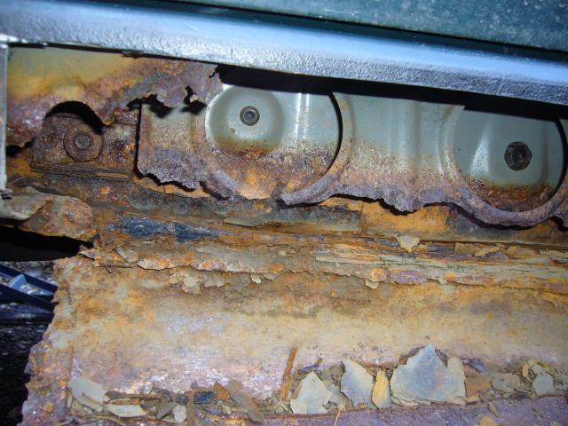

I did use weld through primer on the panels, but I expect much of that burned off when the welding was done, so I made sure I gave the insides a liberal dosing of wax when it was all finished.
Joints were butt welded (continuous weld) along the cut lines where new sections were grafted in. I used plug welds where there were originally spot welds (for example, where the outer sill joins the inner sill along the bottom edge).
Hope that helps.
