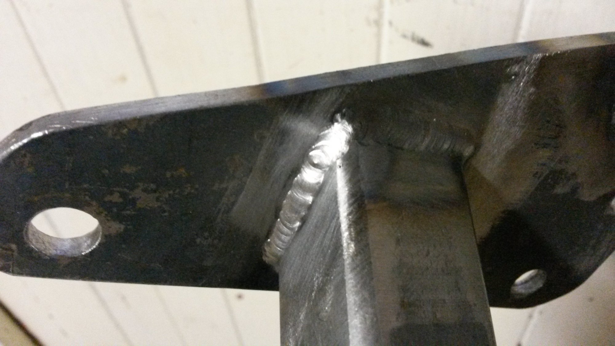

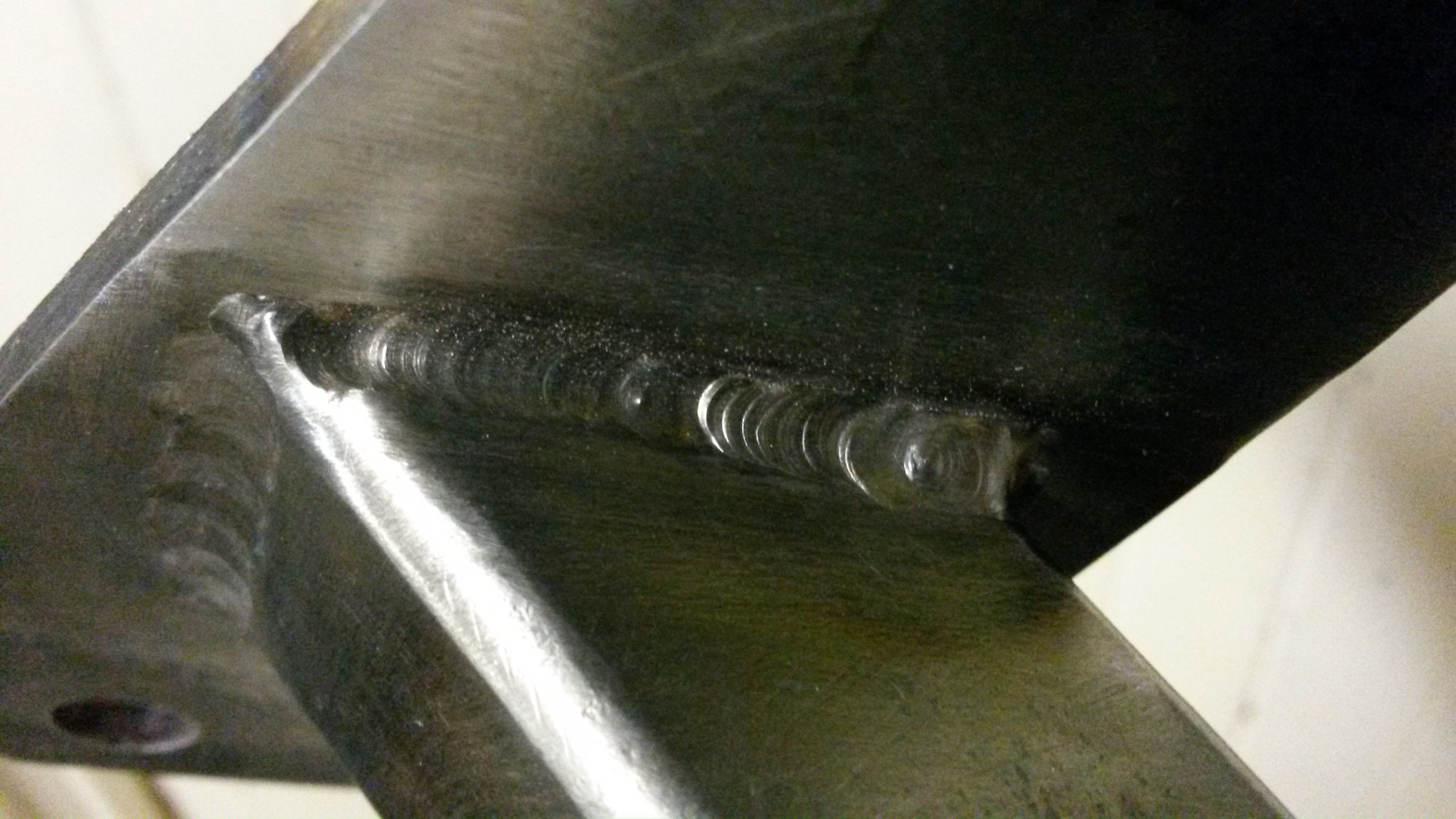

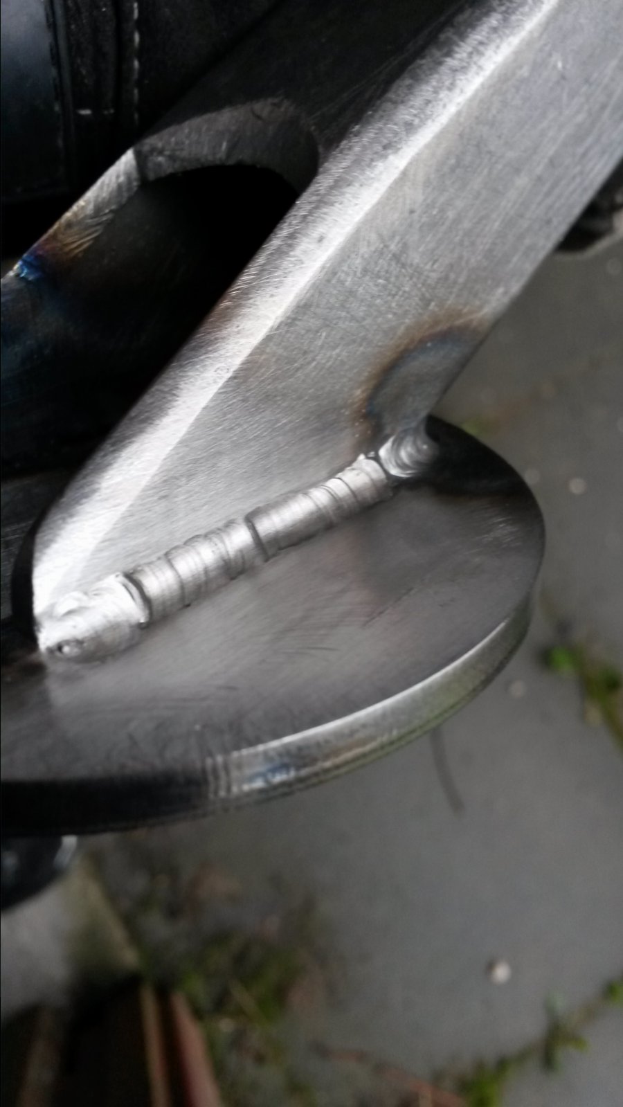

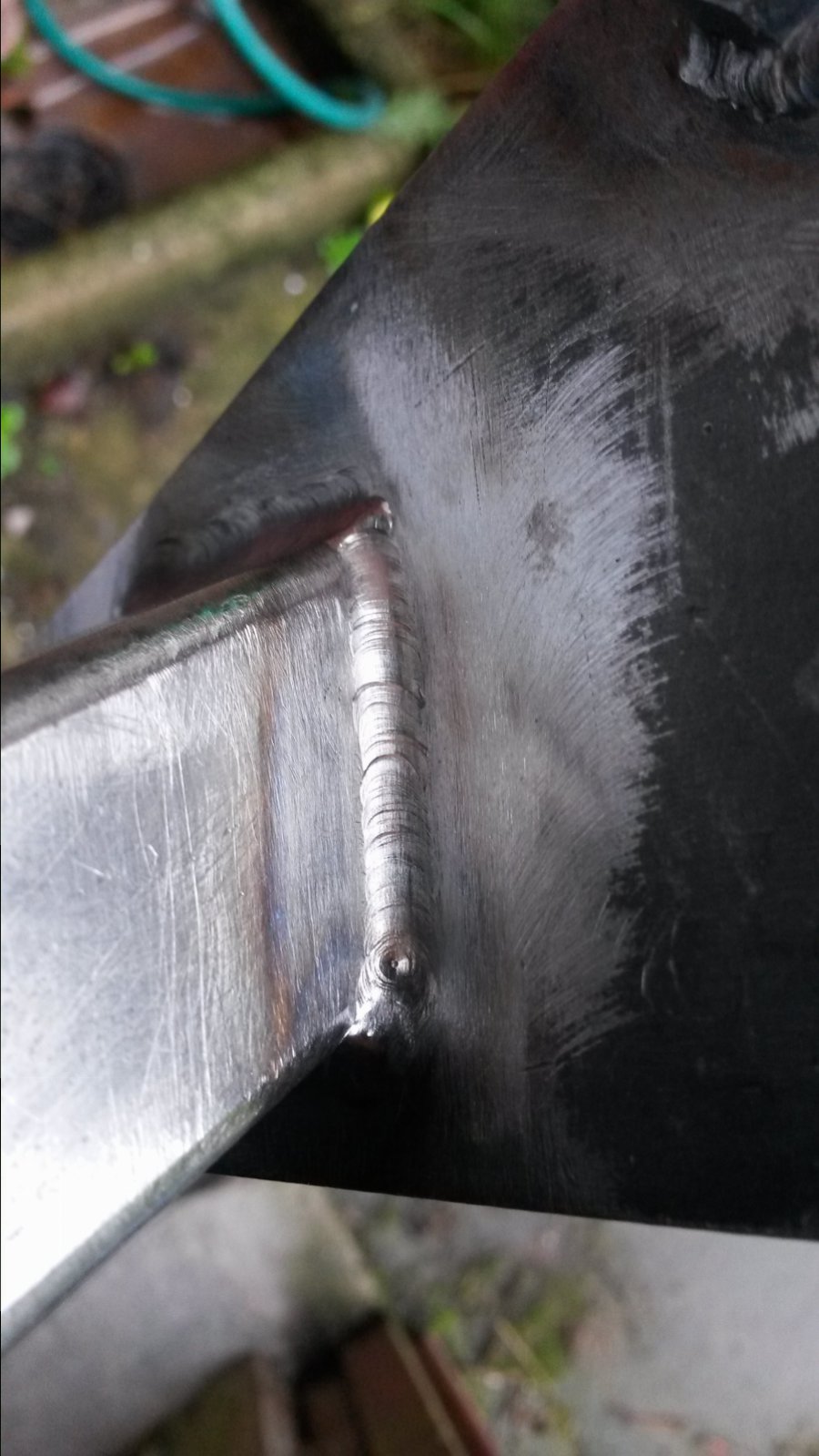

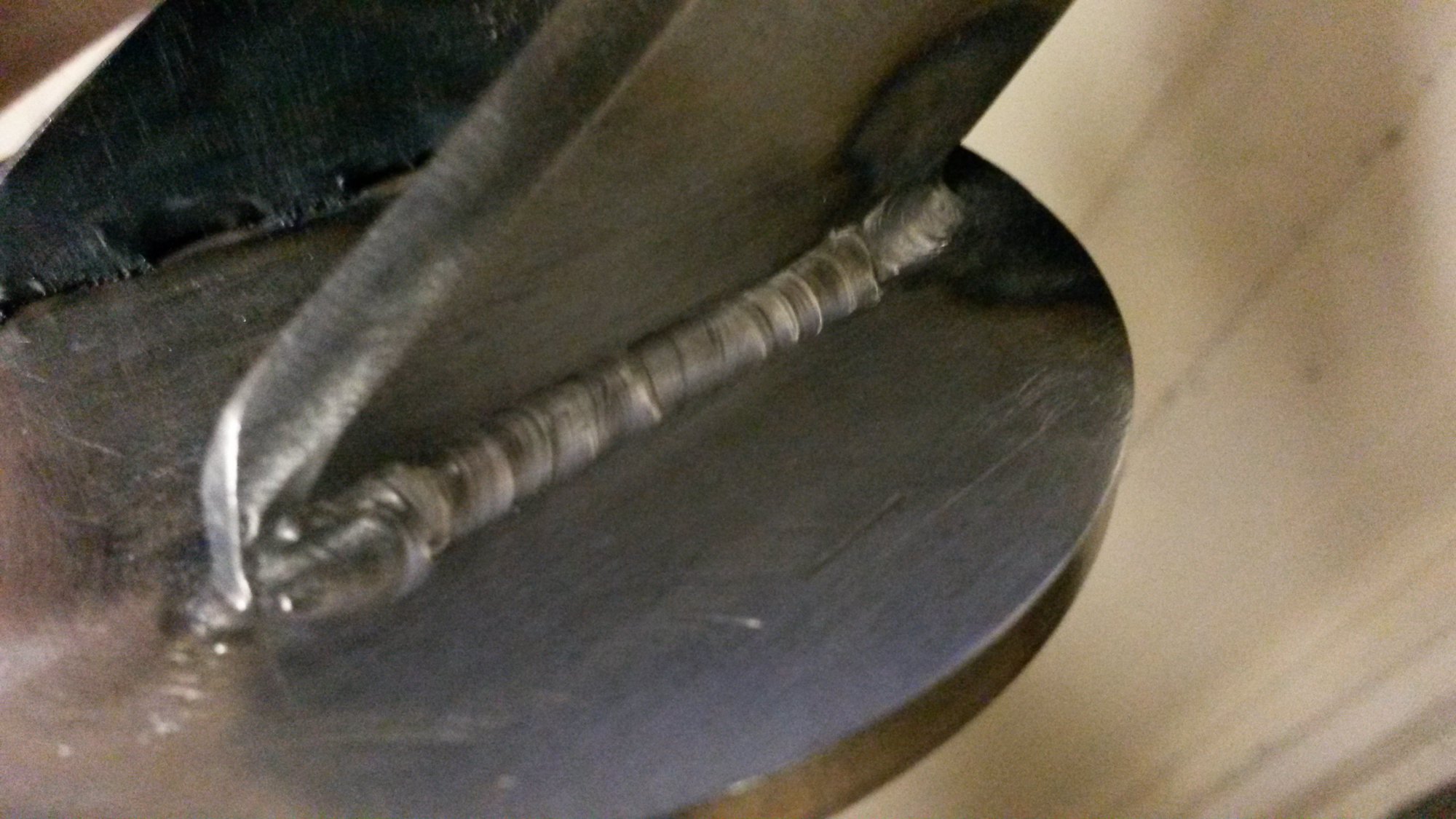

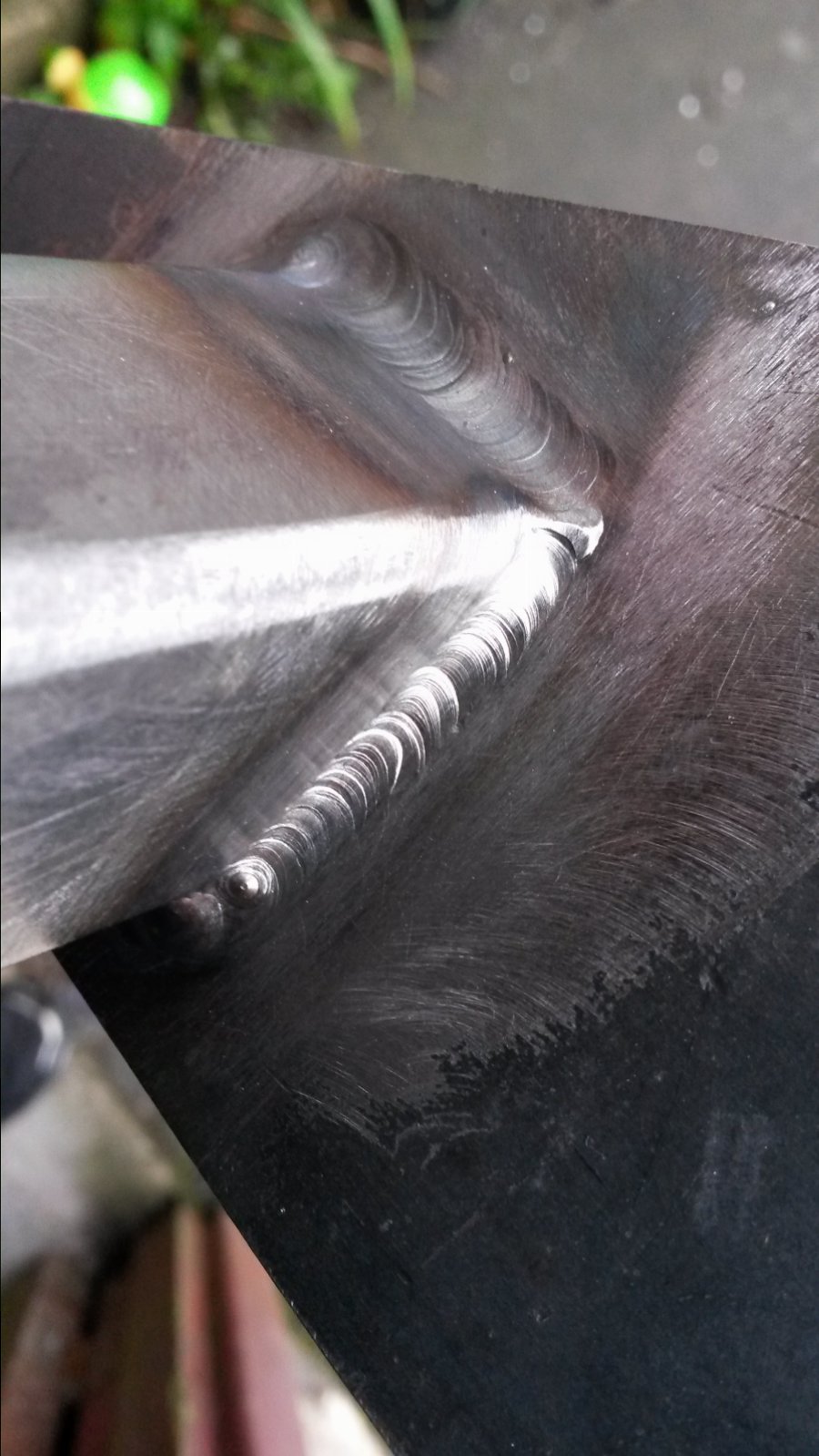

Takes a few practice runs to match the slope down accurately with your pace if you haven't done it. I run on a little longer and step back after finished Afew mm to smooth off the end dab and avoid a crator. More important with Alu mind but you get in the habit with both.I'd be doing a wee little manual pulse on the button to finish the point end. Never thought of actually doing it all on a long downslope before - nice one mate![]()
