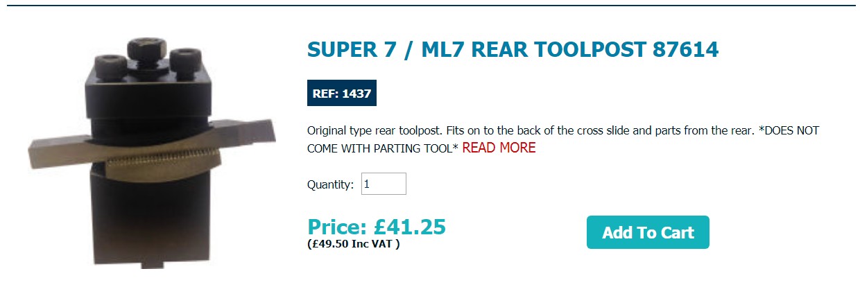

The op is using carbide which is most likely negative rake so lifting at the rear could compound it if he try’s to face with it
Does anyone remember the tapered holders for hss increasing rake by tilting the toolbit so saving the amount needed to be ground from the top making the tool stronger and making it easier to set centre height
Putting it on centre height will make it work properly, however that is achieved, Doesn’t matter if the tool is vertical, upside down or whatever, as long as the tip is centre height it will work.
