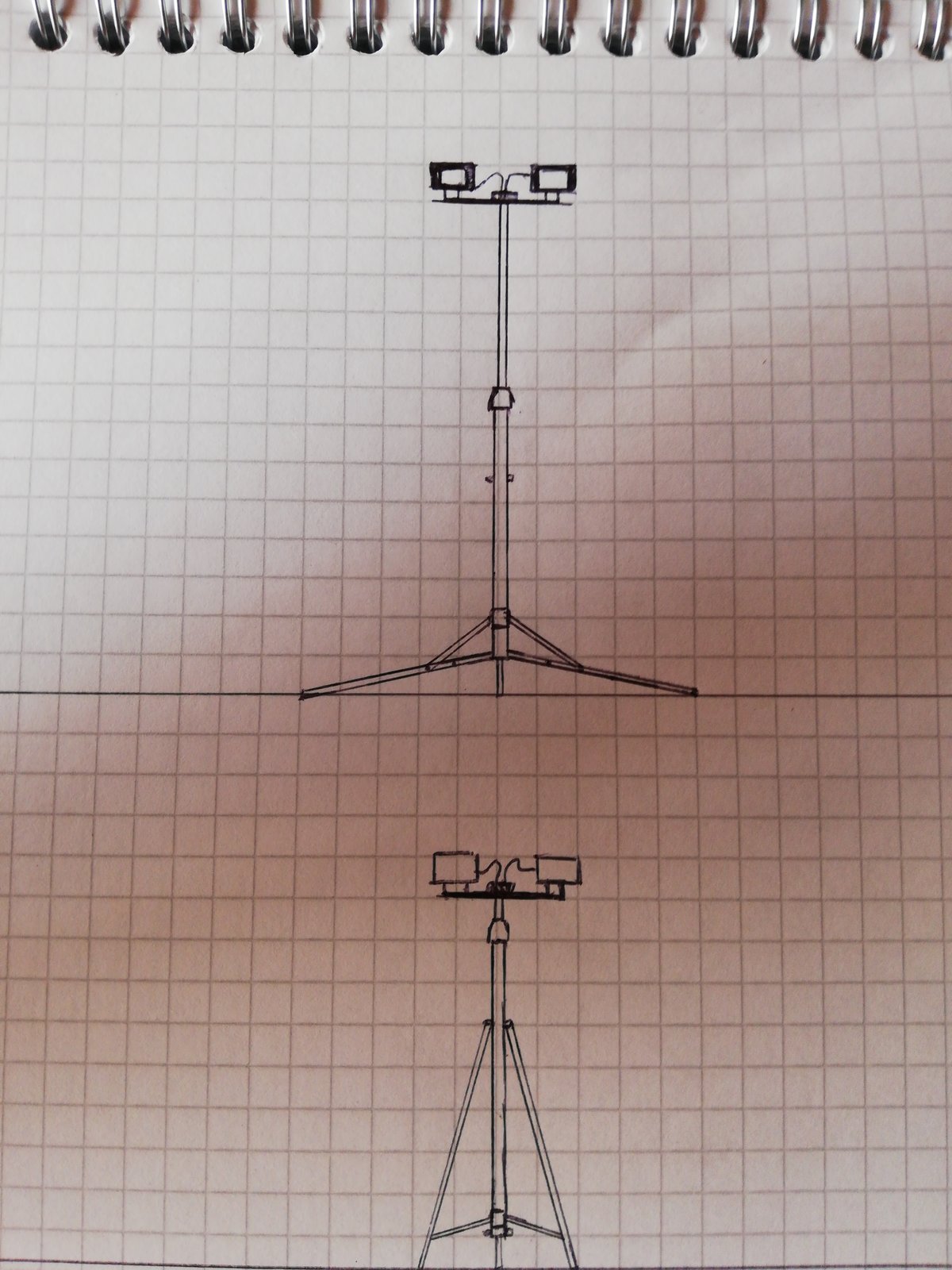

In this days me and my brother feel the need of a light tower on the actual building site we are working on
My original idea was to use two iron pipes and some angle iron to make the base
So essentially an 1" pipe as outer tubing/frame and a 3/4" pipe as inner pipe ,to lock this at the desired elevation I was thinking to use a transition fitting for polyethylene pipes
So when this fitting is loose the inner pipe can move back and forward ,but tightening it the pipe been locked in position .
The legs or feets or whatever we can call them
I would like to make them using or "L" or "T" angle iron or maybe better use always round tubing .
Each one with 3 holes drilled ,one on the ends and one at almost 3/4 of the total length
That because , when I needed this kind of light I was in open areas and the lights in this occasion should be in elevated position
up to 4 meters I would say
So it does need a wider base than in normal close areas environment (into a room or something like that)
So the idea is that changing the I position of 3 bolts is possible to change the inge point so the base will be larger or smaller
For the light source I was thinking to use two led headlights ,15W I believe .
Now my doubts are concentrated on the wire
Thinking about spiral springyish kind of cable between the switch box and the lights themselves
But I should put the wire inside the inner tube to protect it against impacts etc but now I'm thinking that it could being scratched or pinched between the two tubes .
Otherwise if I put this cable outside it will be exposed to anything ,so sparks dirt water, sun (yep this sounds weird) ,heat , and it can be crushed or grabbed during the transport
I will make a drawing this afternoon to make this topic easier to understand
I need advices about , this thing shouldn't have an easy life
