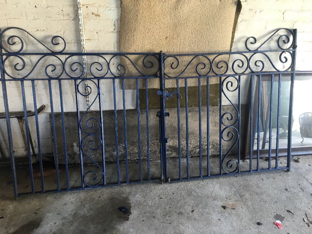

these gates need adjusting to much bigger size
they need to be adjusted by 10" either side and im thinking its best to add on at the hinge side of these to get what is wanted by using 10mm bar to gain the extra size and either a round bar in the space or just using the 10mm bar
the round pins to be ground off and reused but i do have the adjustable ones and pins to go on the posts
im not so sure the adjustment would be better within the middle as more ackward to get it right
