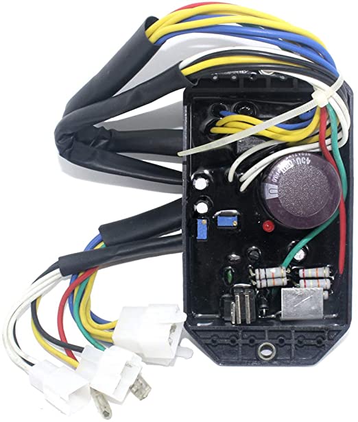

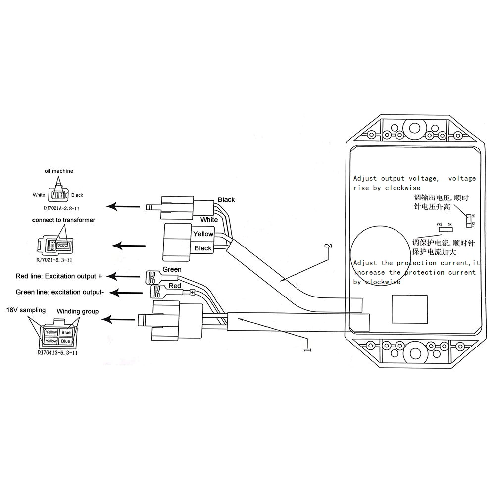

Anyone know why there are two adjustment screws on the AVR on my kva Chinese nasty generator? is one for each 110v winding or is one up and one down ?
What is the correct procedure to adjust the AVR, load or off load, what's the right voltage 220 or 240? ( my mini inverter stick welder says 240 v input )
