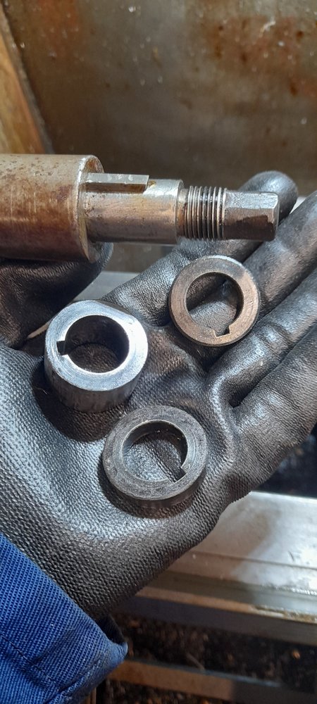

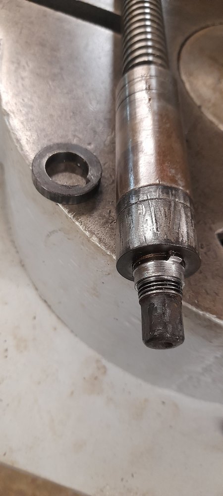

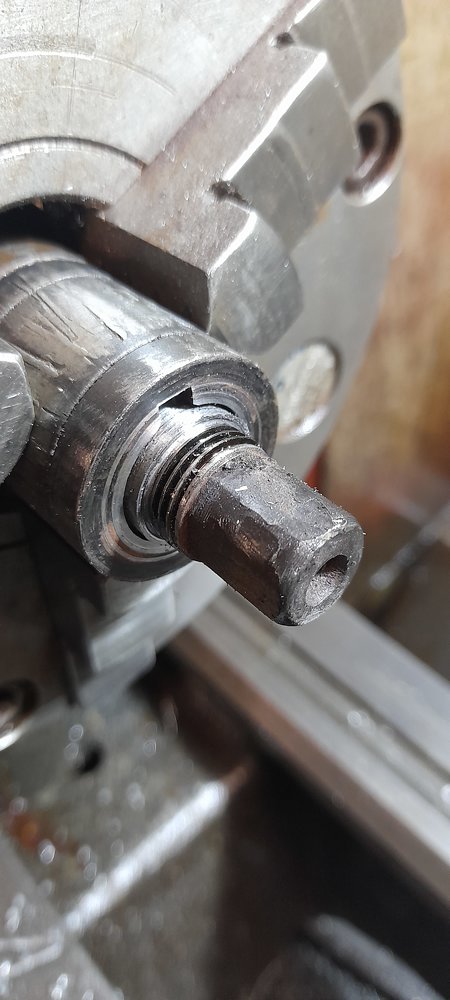

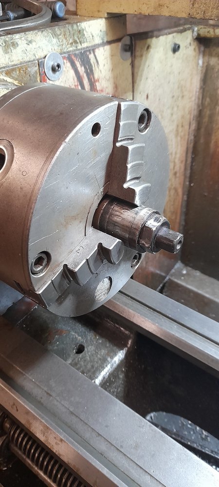

Tried that!Maybe someone has loctited it? Bit of heat?
A lot of heat?Maybe someone has loctited it? Bit of heat?
There's no cover on this screw. I'm tempted to add a rubber boot to give a small amount of protection.

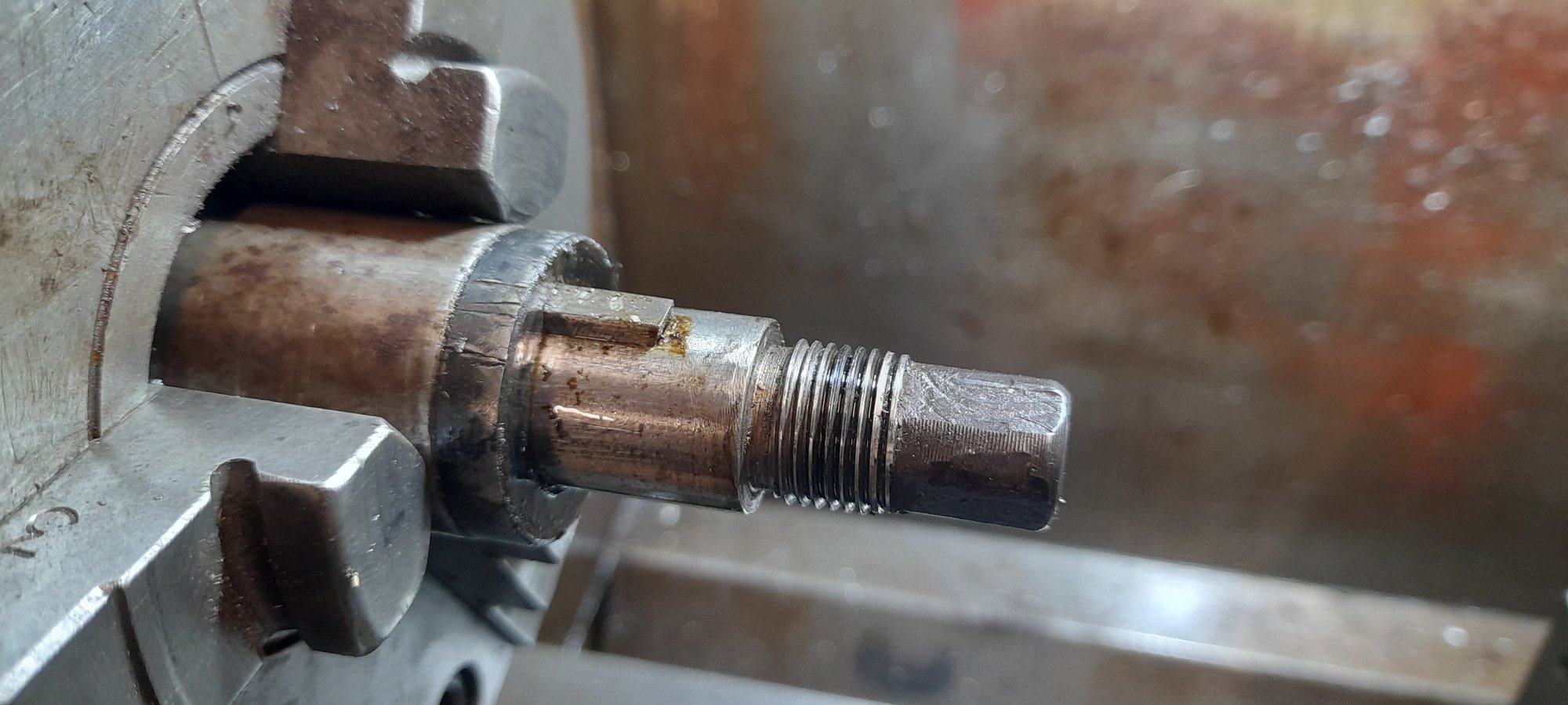

Righty tighty, lefty loosy?Thanks! Looks identical to mine. But now I really don't understand why mine didn't budge.

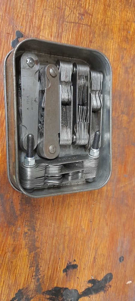

I'm pretty certain that I've a set of 3 5/8" unf taps.Thread dimension is a bit annoying as I need to make a new nut and had hoped to clean up that thread. I'll have a rummage but fairly sure I don't have 5/8 UNF.
