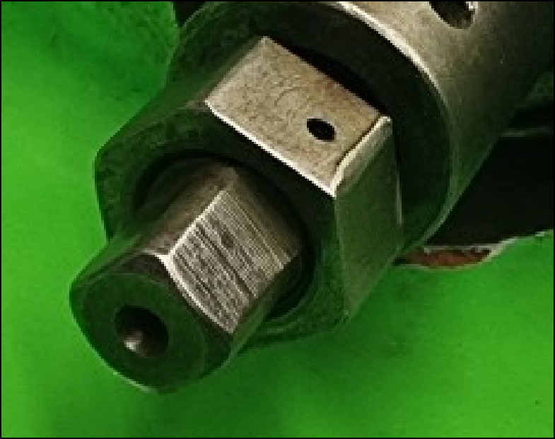

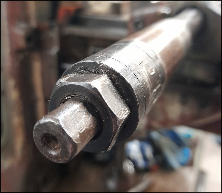

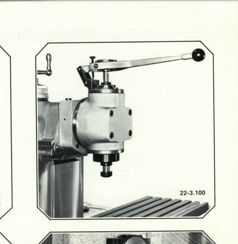

Can't help you with that one, mine is pinned to the screw so that it doesn't come undone. Obviously the screw is push-pull so that it can pull in or eject from the taper. The internal shoulder is for ejecting so the screw had to go out through the front.
Since the nut in the pic is for 'pulling' against, it must be either pinned of left hand thread or else it would come undone when tightening the drawbar.
