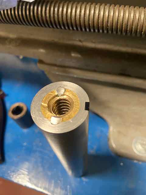

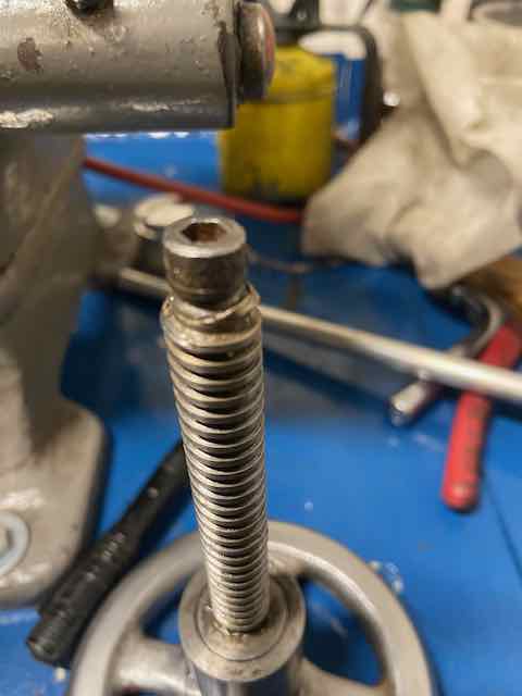

I've got myself a nice little Lathe, the tailstock didn't auto eject so I thought I'd have a go at fixing this. It appeared to be the tailstock thread wasn't long enough to hit the morse taper and eject it. So drilled and taped it and fitted a cap head screw, worked great.
After a few goes at ejecting various morse tapers I have it stopped working. Anyway on closer inspection it had pulled the threaded bung out of the tailstock spindle.
It had 2 thread holes at either side of the bung with missing grub screws. No problem I thought so grabbed a tap the correct size
and cleaned the threads out, found a couple of cap head screws in m odds and sods box and Loctited them in. Hacksawed the extra off and faced them in my lathe (first job).
In my haste I'd made a big mistake, I never noticed the screws actually protrude into the acme thread of the tailstock. So it won't screw back in.
Yes I know and I do feel swear word stupid...........
So 2 questions can you get taps in acme type thread form ? If I could run a tap down it I'm petty sure that would sort it out.
If not can anyone around my way East Yorks chase the thread through on a lathe recutting the thread ?
Or is my only option to drill out the screws and try again.
