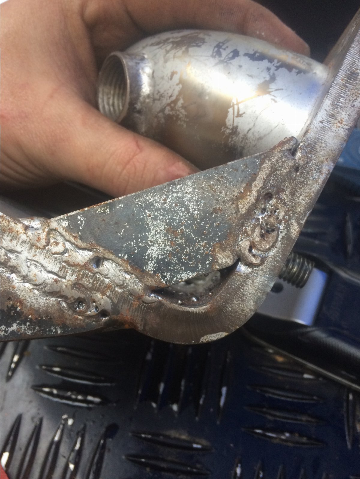

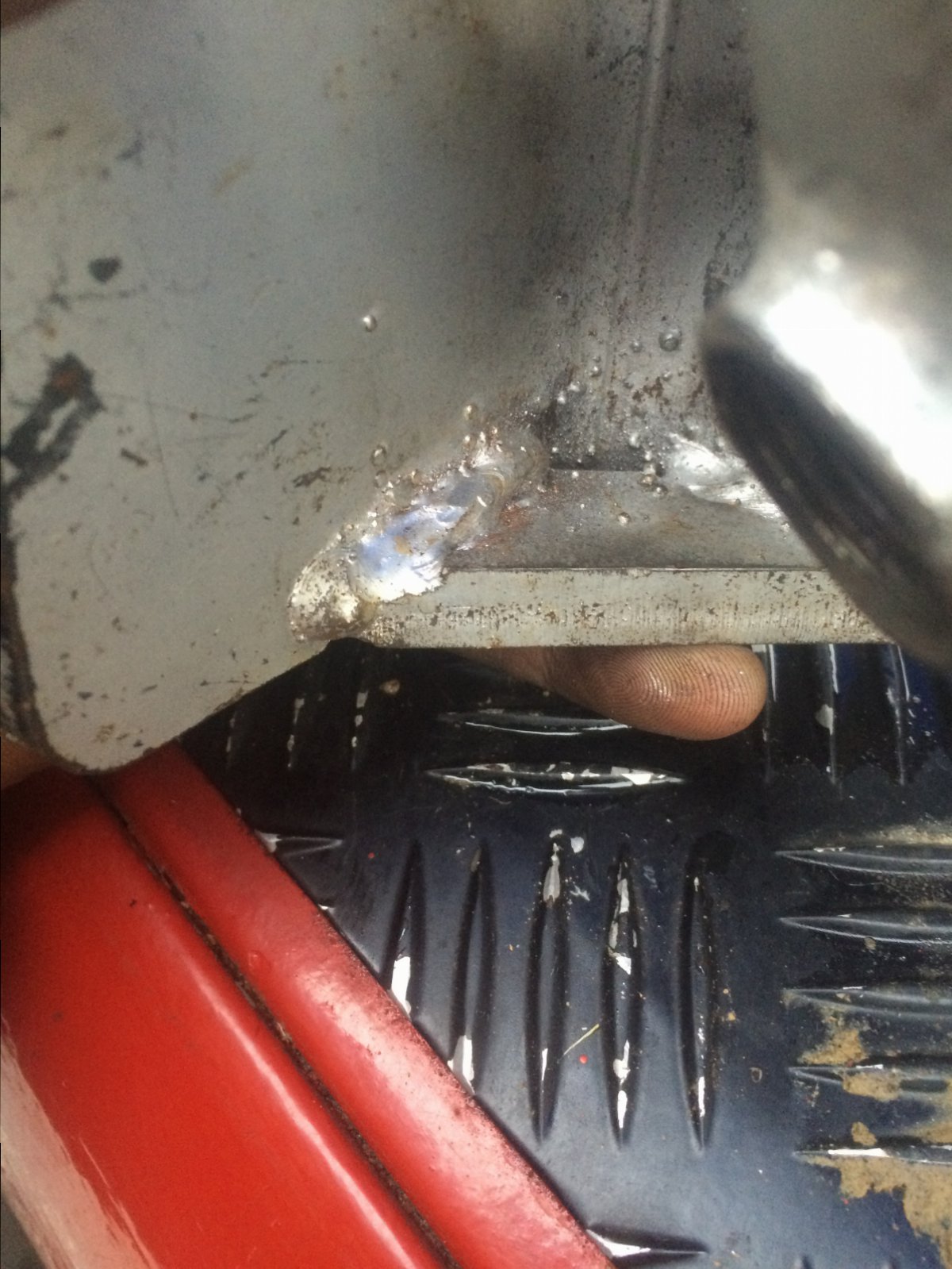

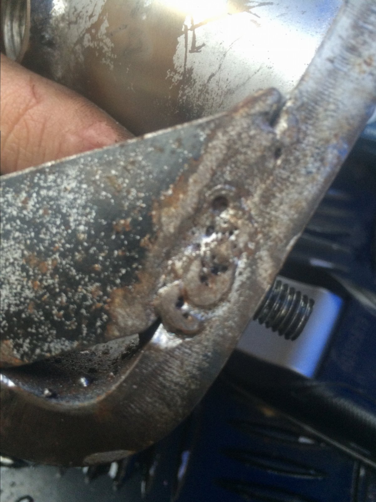

as people might've noticed, I've been helping with a Cummins conversion into a 110 these past few weeks. These are pictures of the alternator mount supplied as part of a conversion kit, and frankly I was appalled at the state of the welds. Fair enough it'll hold, but to me that's not the point, I'd be embarrassed to send something looking like this to a customer, especially at the price paid!

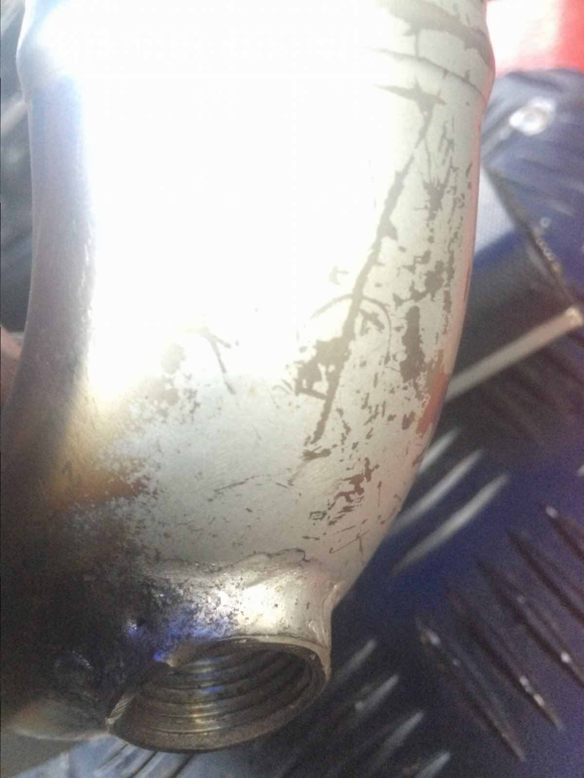

The last pic is of the modified bottom water hose, complete with a pinprick hole in the weld, and the inside of the tube full of swarf where the drills burst thru
