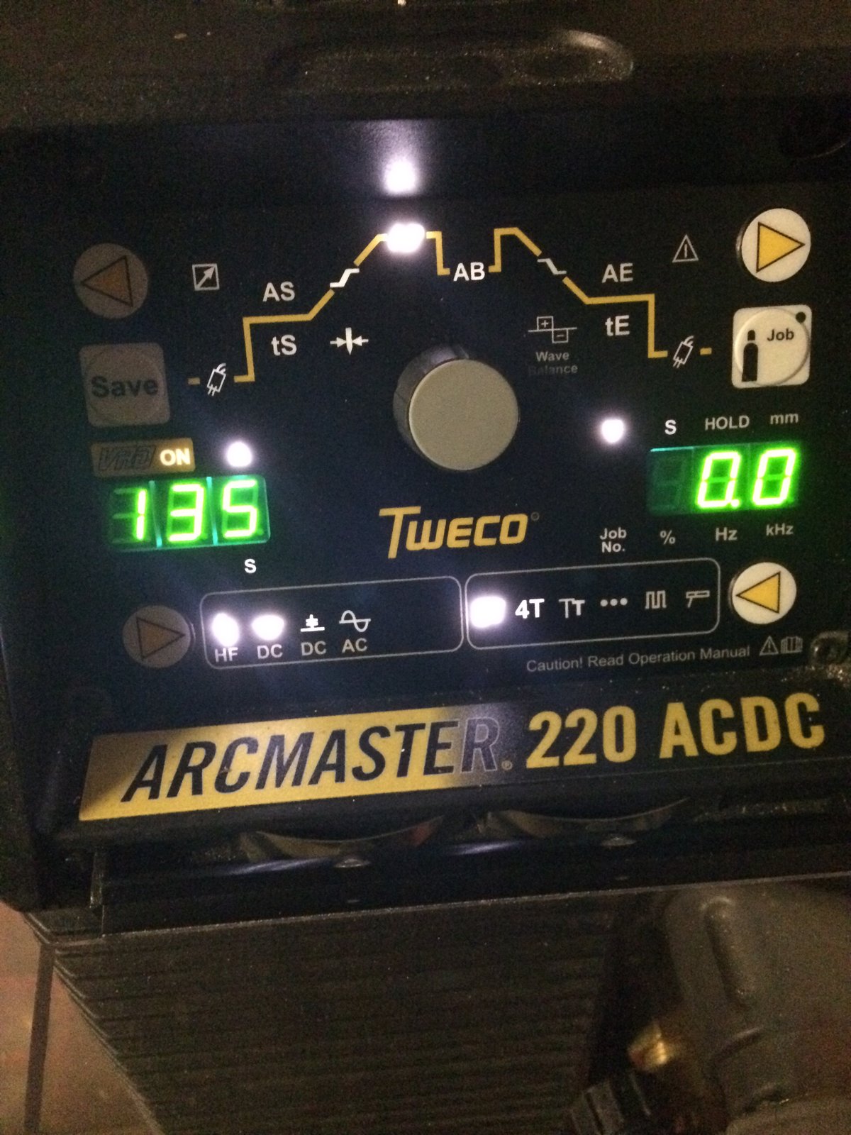

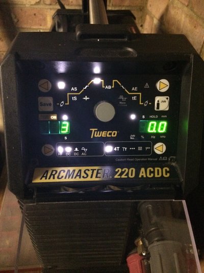

So the reading on the left shows you the actual amps you are using? Could be handy i suppose find the sweet spot then dial that in to max if you want.This is how mine works.
Pic 1 with the pedal plugged in. Minimum current setting is displayed (I can set this to what ever I want. It's at 3amps)
Pic 2 pedal un plugged now shows max current achieved by flooring the pedal. I can change that with the pedal plugged in but I won't see it change unless I unplug it. I can count the increments on the knob as I turn it if I wish but it's easier to just pull out the plug. Doesn't take me 10 seconds. I thought the other thermal arcs were the same but could be wrong it's been a while.
Well yes it shows actual amps been generated. But you don't have to find a sweet spot. You can pre set it where you like and use it like a switch you just unplug the pedal to see where your setting for max. For min you can leave the pedal in.So the reading on the left shows you the actual amps you are using? Could be handy i suppose find the sweet spot then dial that in to max if you want.
