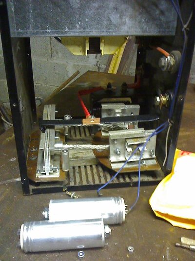

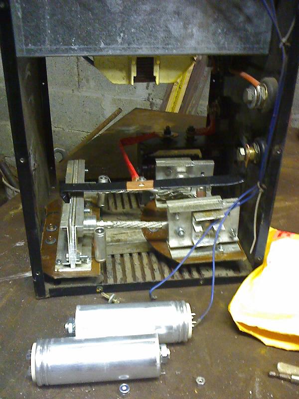

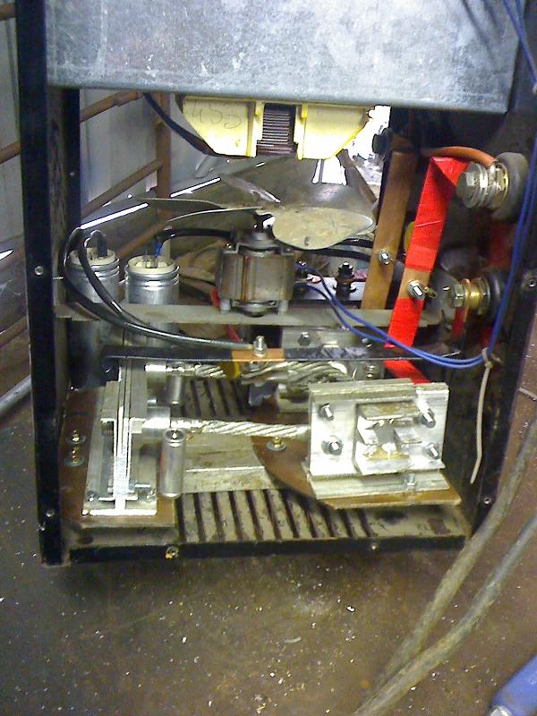

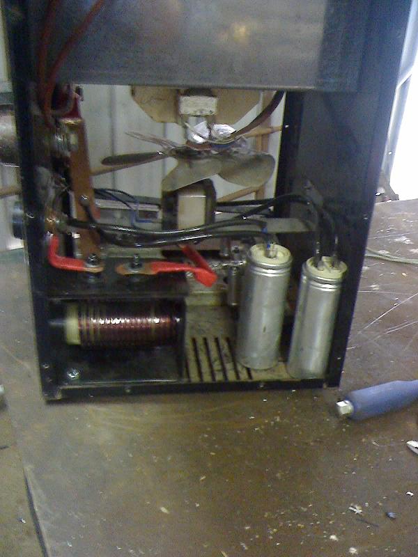

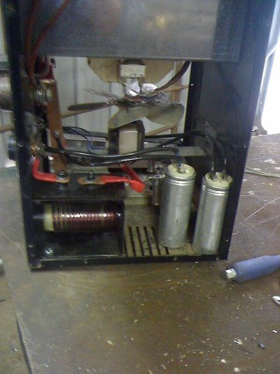

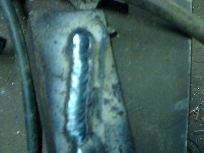

oops that is .5uf for the ones on the diodes I wasn't too sure of the two on the right-hand side the ones on the same heatsink because the first two I have crossing the heatsink so that all I need to finish the job. There is a good bit of room in the bottom of the welder if it doesn't fit by the looking out for a small mig welder or a big battery charger thats burnt out and put it all into

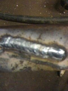

but absolutely delighted with the way it welds I did notice that the end of the run was much flatter than on AC and the you need to turn the welder of a bit higher than usual can I use the ohmmeter to test for amps
I'll post a few more pictures when I get to use it in anger I wish I had a digital camera so I could take close-ups the weld is much better than it looks in the photo
