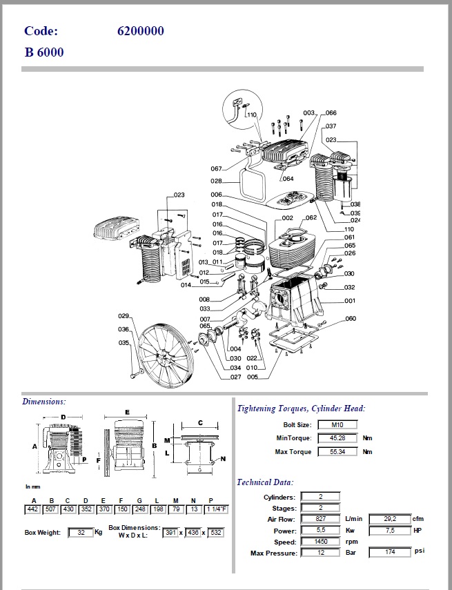

I have a Abac B630/270 3phase compressor, bought new approx five years ago and used quite literally a handful of times. It appears to have blown it’s head gasket - I was expecting a lot longer life out of it to be honest - anyone any ideas on why it has failed with such little use?
