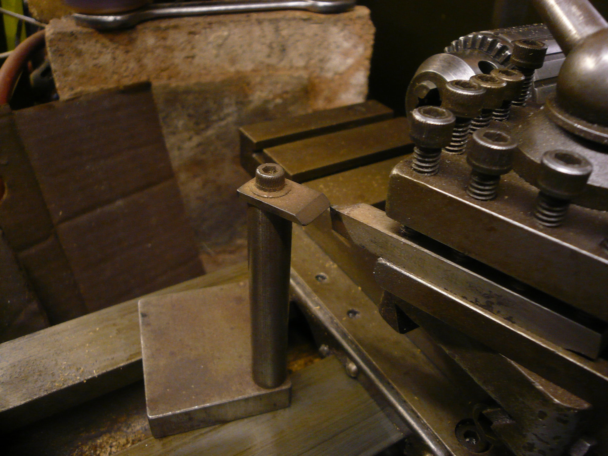

I got a really neat one with my Bantam. Barlidge now has it. It was just a piece of turned bar with a rod screwed into the top bent 90 degrees and a point on the end. You stand it on the cross slide and line the tool up with the point. Simple to make and easy to use.
