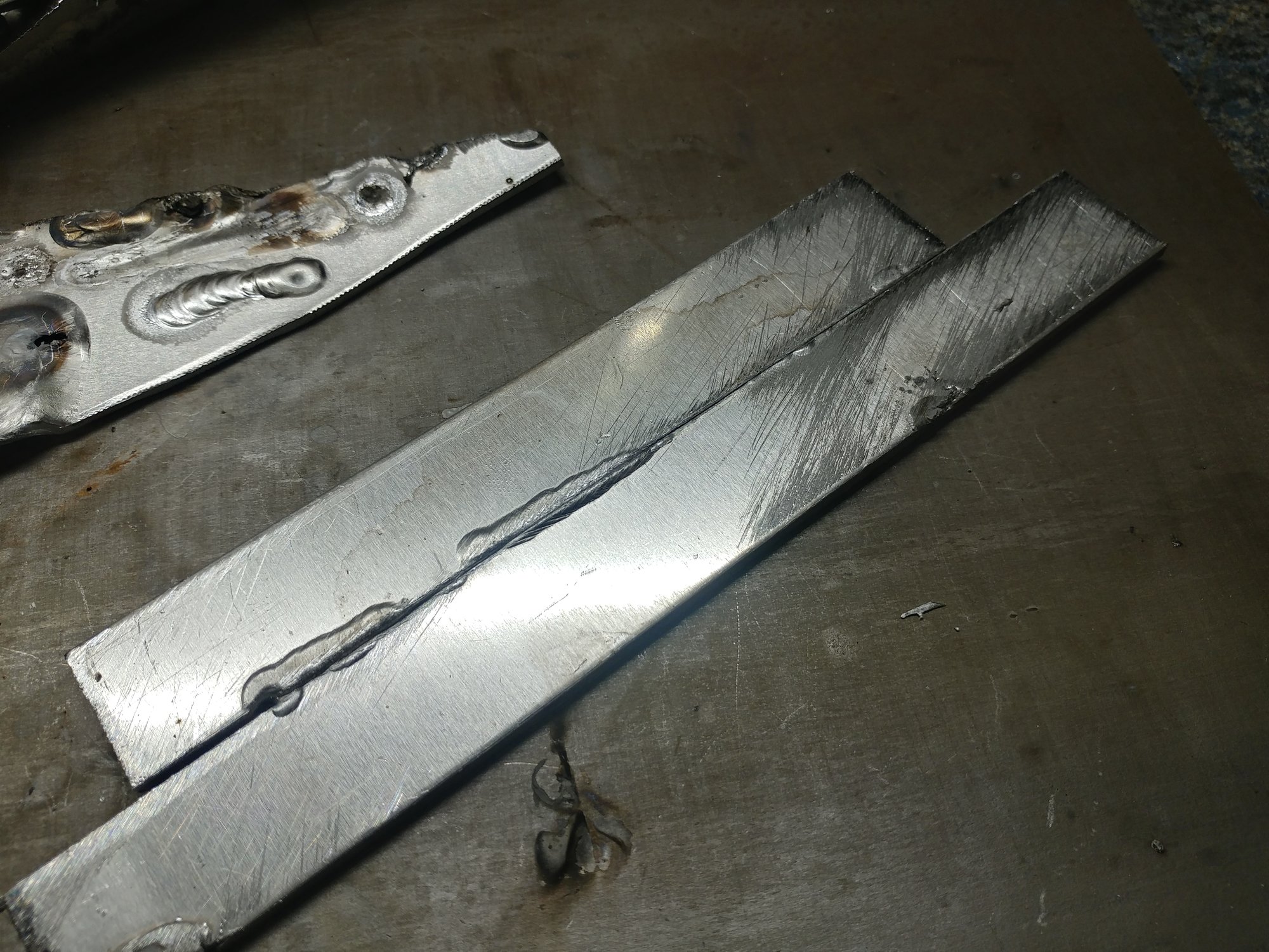

I don’t understandI think the main issue is likely to be tungsten contamination
Sit down, get comfortable, support the cable around your shoulder or something. Try to rest your for arms on something to keep as steady and comfortable as you can. Get a few chunks of metal to support what your welding, it also reduces heat soak on small practice pieces

In the nicest possible way I think you’re trying to run before you can walk, keep practising running beads until you’re getting consistently good ones every time then move on to butt joints and do the same then fillets, corners etc. Make sure everything is clean and fits well, you’ll get there in the end.

Also normal steel/inox disks aren't meant for alu they can clog the disc up causeing it to heat up and explodeDon't think he's going down any time soon but I'll see if I can persuade him after a few tins of wife beater lol.
Don't have a plasma cutter. Slitting disc takes forever![]()

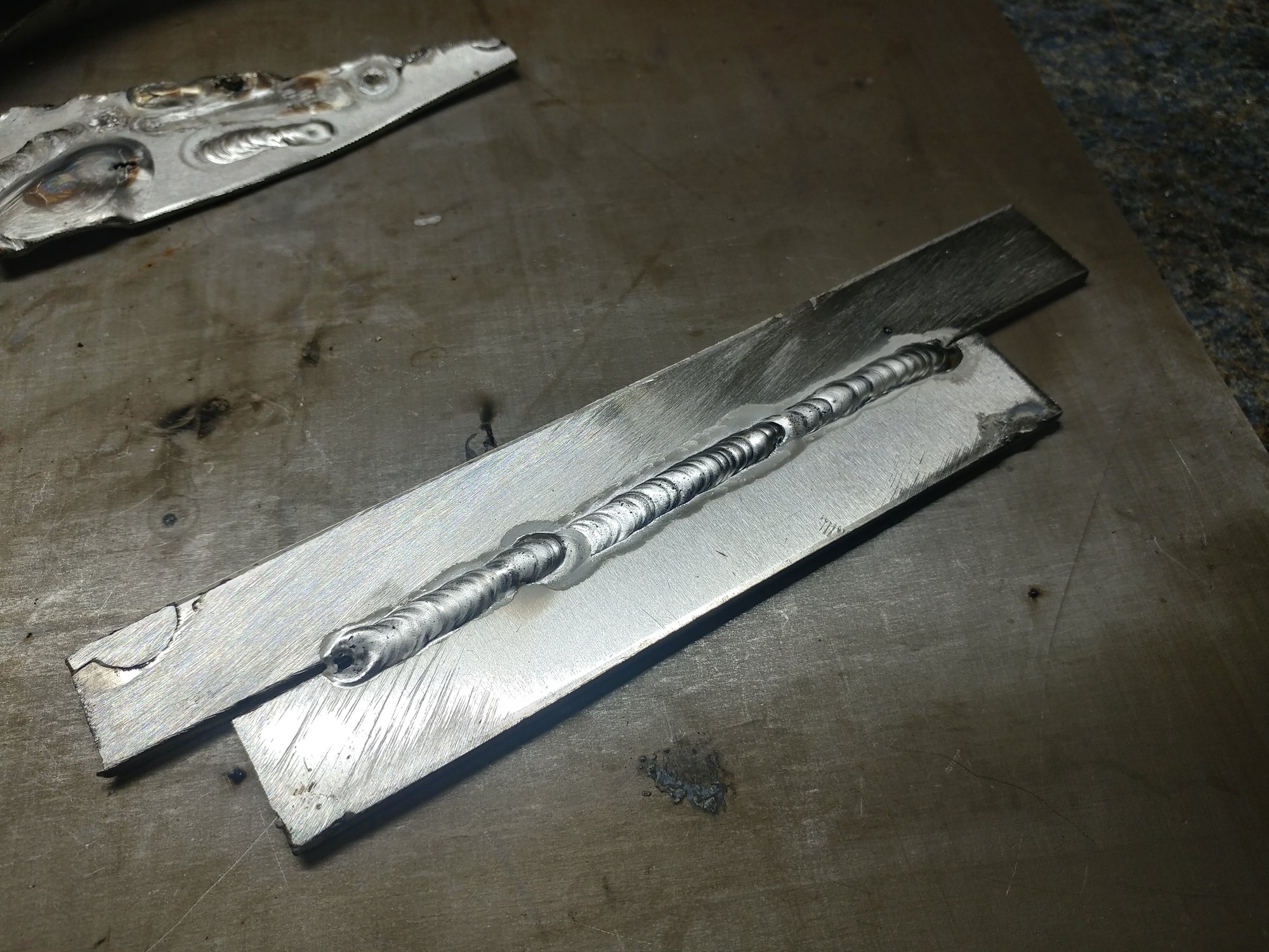

The filler kept melting because it was near the arc.
What he said, abrasive disc is a no-noPlasmas and grinders are disastrous for producing an edge to weld. You’ll get a very contaminated weld.
It needs to be cut cold and in a mechanical fashion.
I use a throatless shear now all the time. It will cut any shape out I want and takes up no space at all. Shears, nibblers, jigsaws are other suitable methods.
Torch needs to be quite steep and with a tight arc when starting the run then lean it back when the pool is established, do not add filler until at least one, but preferably both sides of the joint are liquid, then add the filler to the edge of the molten pool not the arc gap,
The filler rod should be melted by the pool not the arc
