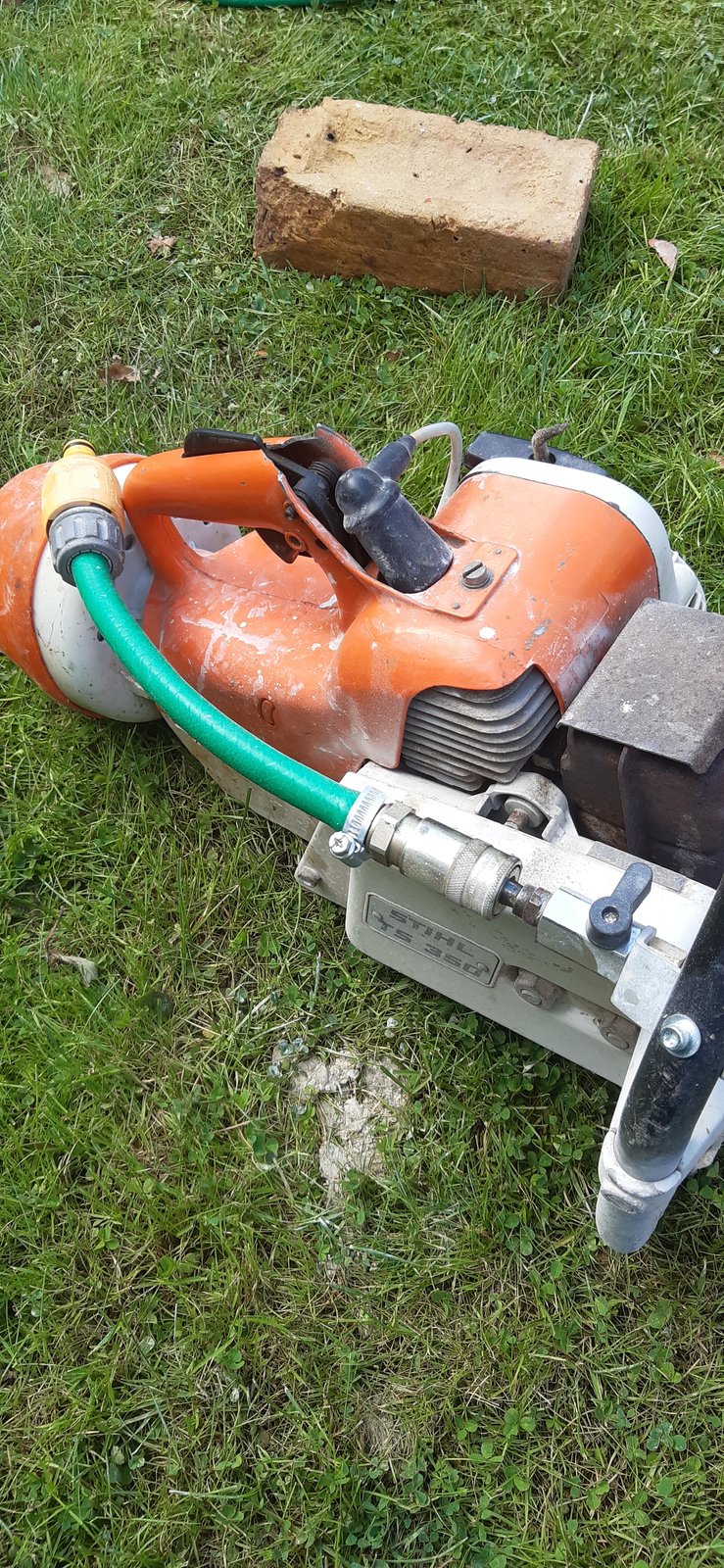

The second saw is another very different story!
It sounded very rattly when turned over and had no compression so I pulled it apart.....
Scored piston, loose rings in their grooves, sloppy mains and little end bearings and a massive ridge in the cylinder at TDC !
The deposit you can see in the head by the plug hole is not carbon build up but brick dust! The inside of the air filter is full of dust and the gasket missing a lump.
Poor little engine!
I'll probably rebuild this as parts are cheap on Ebay.
£38 for a new crank with con rod, £40 for a new cylinder with piston and rings etc.
I'll lovingly run it on some old Castrol 747 racing two stroke oil I have left, mmmm.
