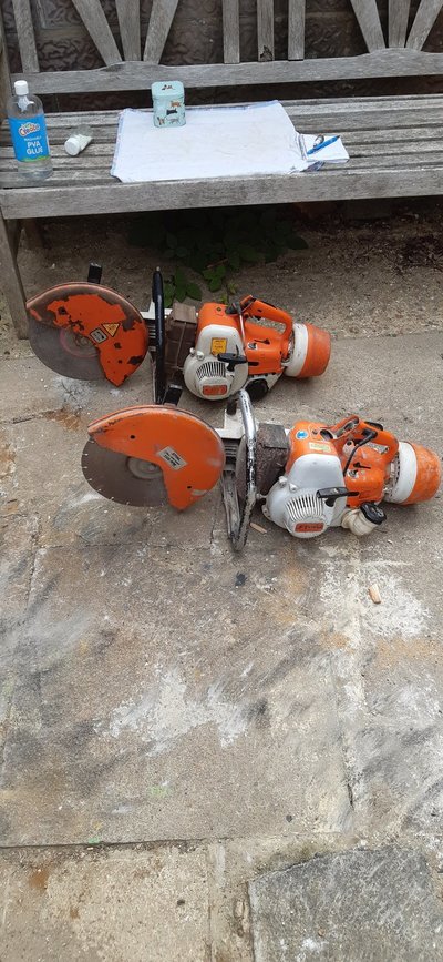

I recently bought two Stihl saws off Ebay in preparation for doing the patio, one would have been enough but I was a bit drunk at the time so two seemed a better idea!
Ones a TS350 the other a TS350 super.
Anyway I finally got round to looking at them, one would start but ran badly the other sounded like the bearings were shot so I started on the "runner"

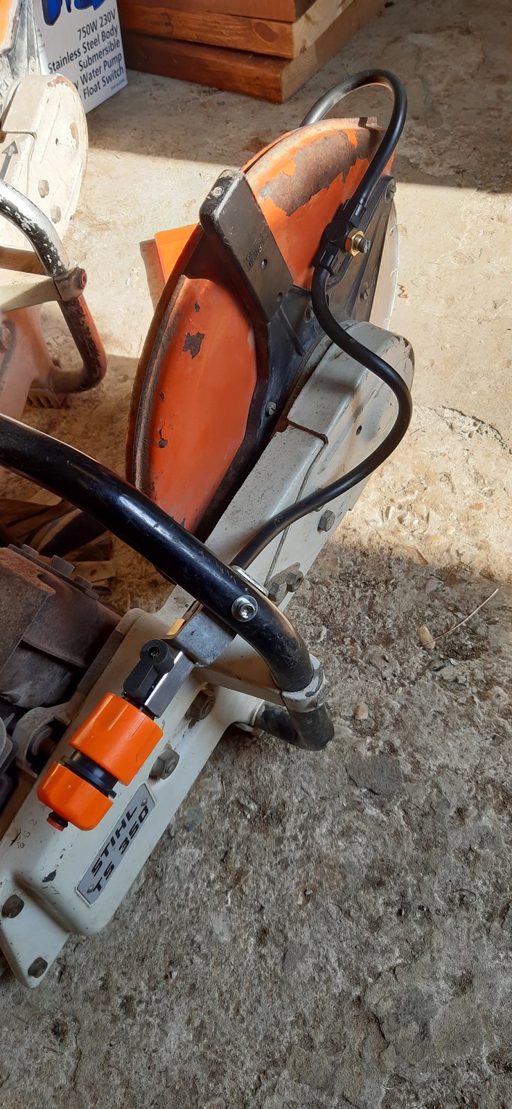

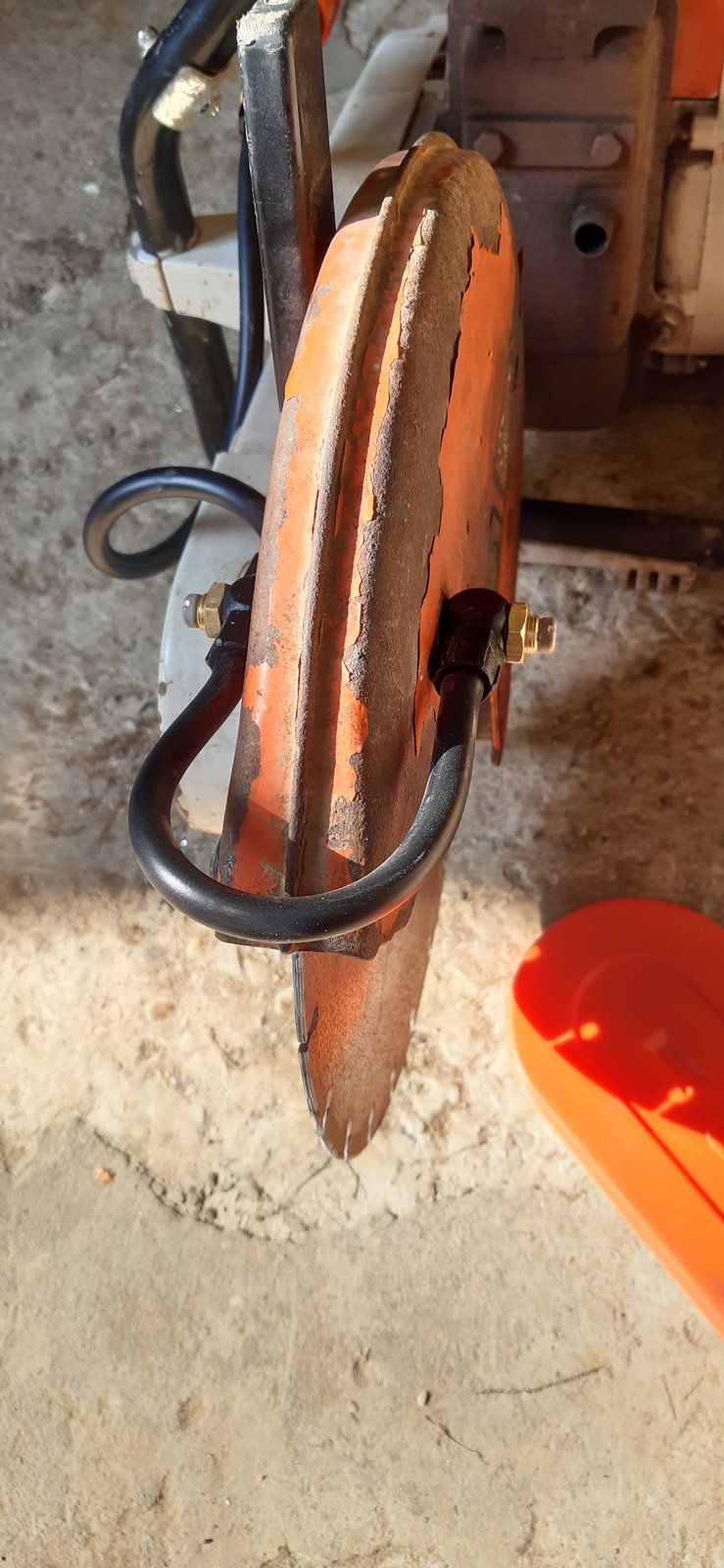

Rebuilt it and had another go at starting it on factory settings. It flooded so I turned the low speed needle valve down a bit and it worked! The engine sounds good and will now start on only a couple of pulls on the cord so I'm happy with that! I've just bought a water dust suppression kit for it as this thing chucks out some serious dust when cutting stone!
