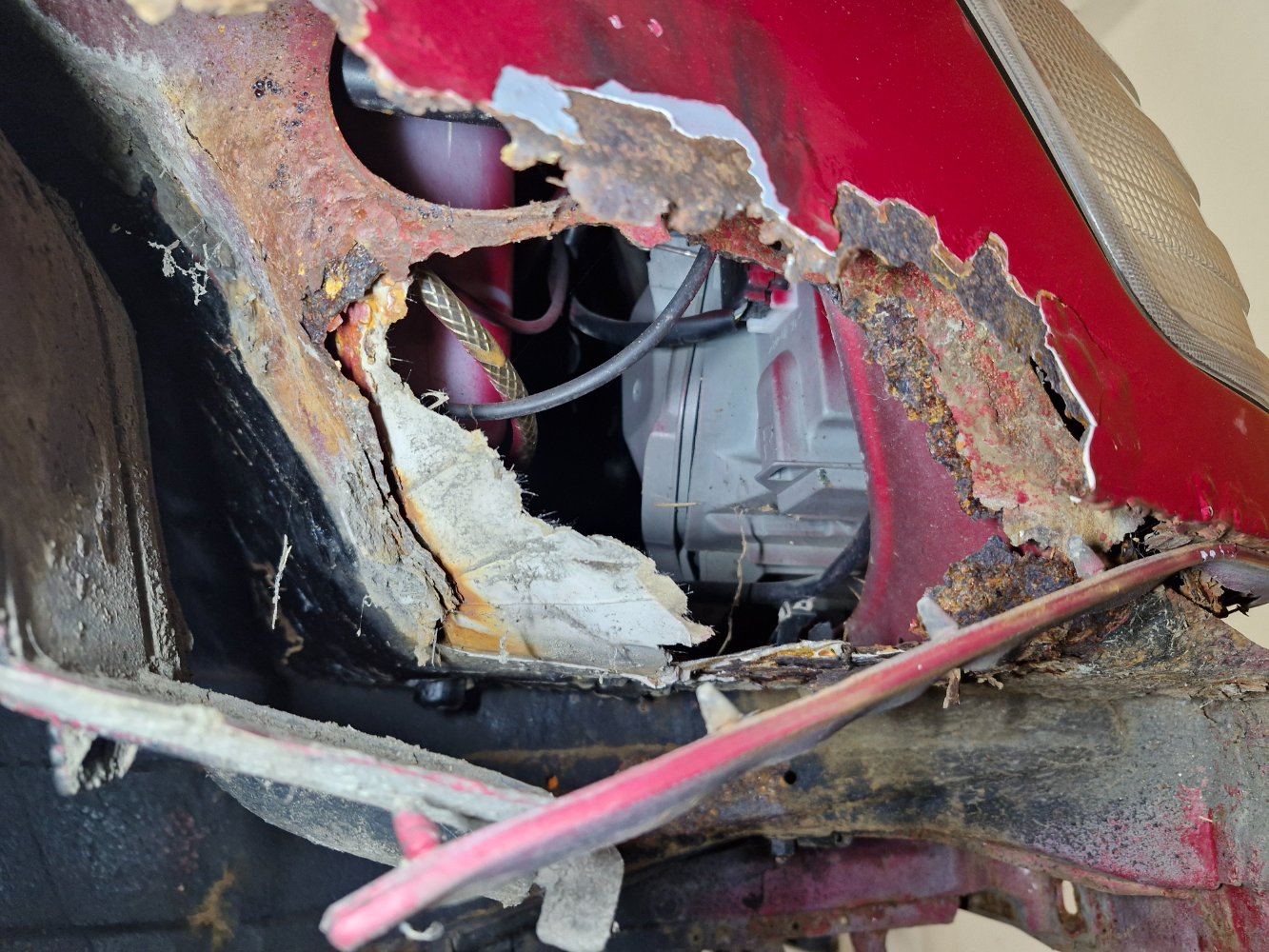

A few of them do, the worst years seem to be 1999-2003 although I have heard that rotten subframes on 2015 Mercs are an issue. My 1997 W202 got to 24 years old and 200,000 miles without needing a welder which is pretty good I think but it had some rust on every panel by then. Such a shame Merc couldn't have taken a leaf out of the PSA groups cars, those cars were incredibly corrosion resistant. From my observations their etch coat was incredibly zinc rich and tough and the top coat on the shell was also much tougher than Merc.all 90s Benzes rust like Lancia's.![]()

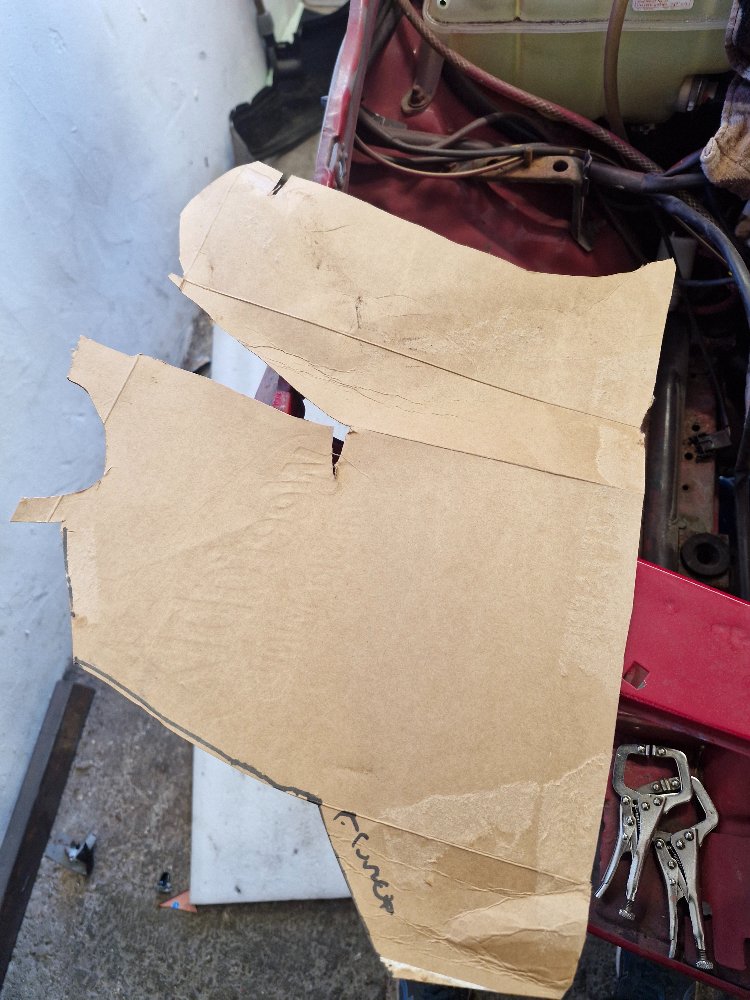

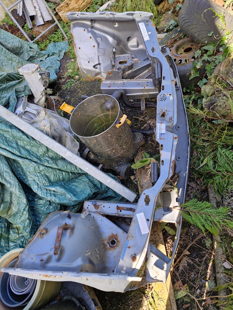

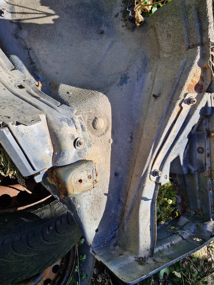

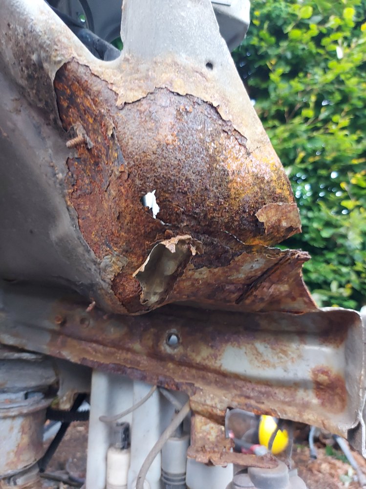

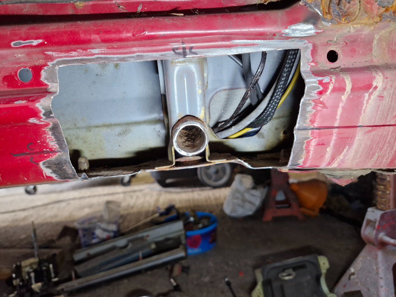

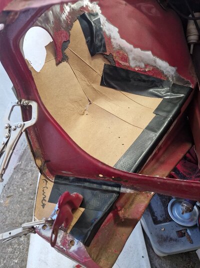

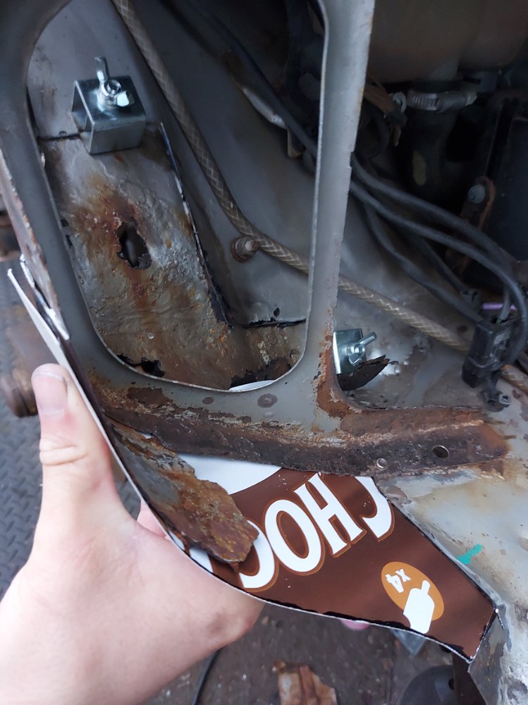

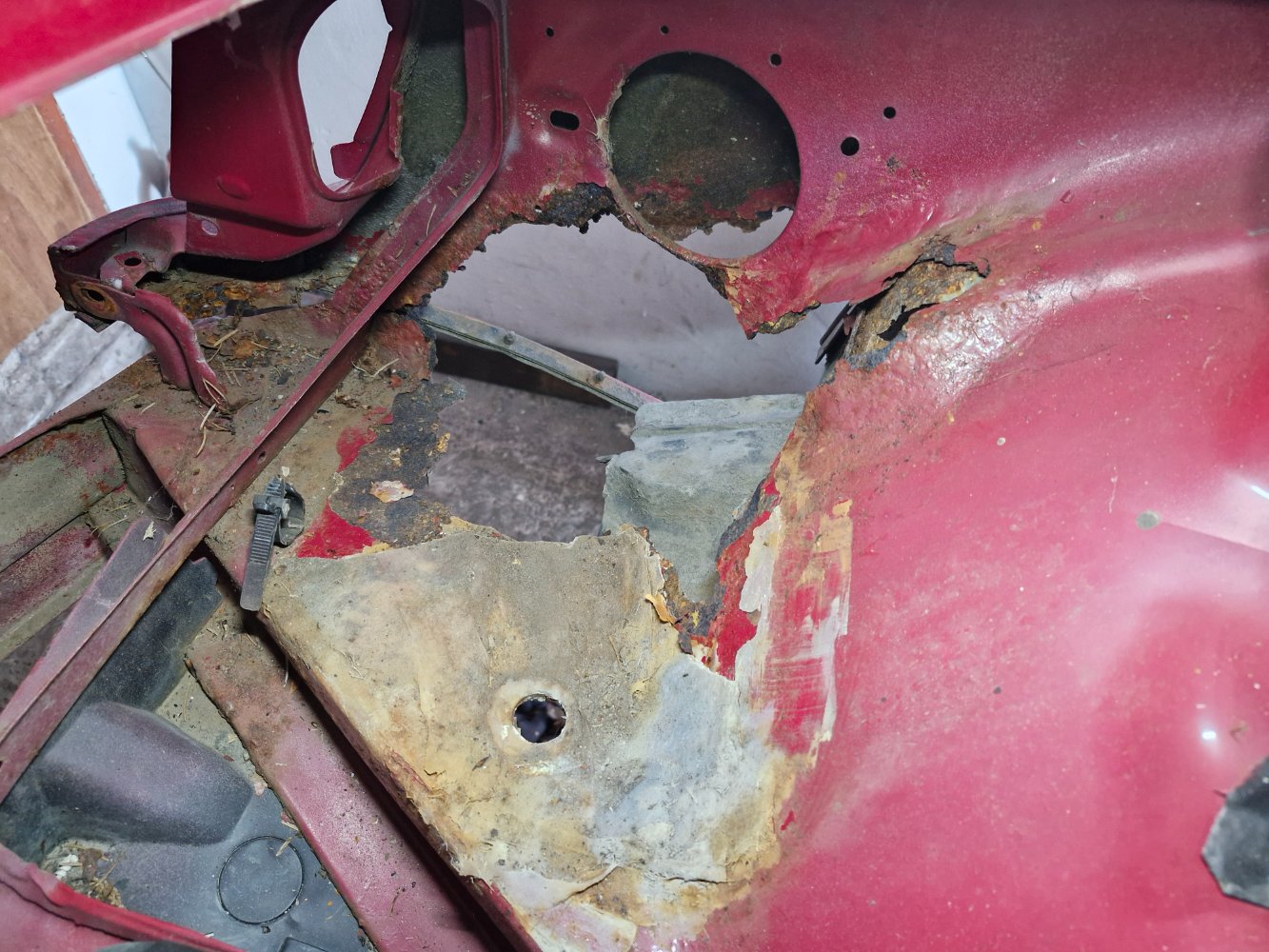

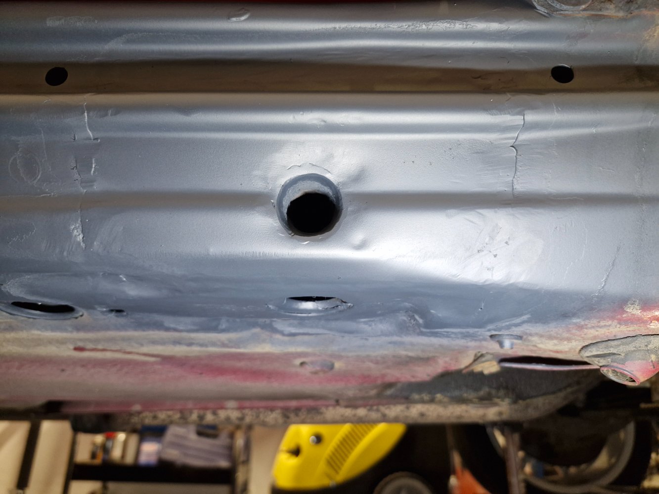

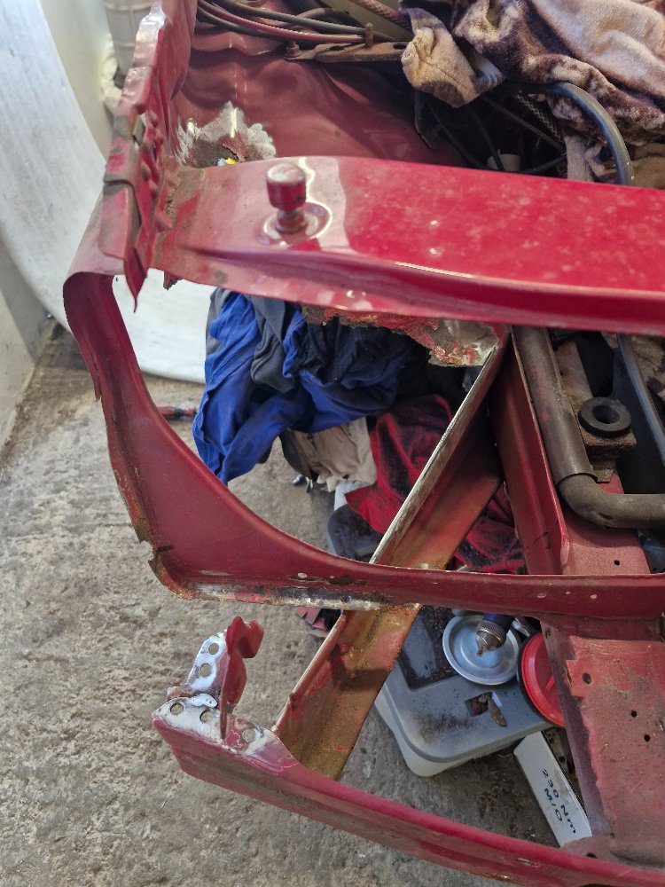

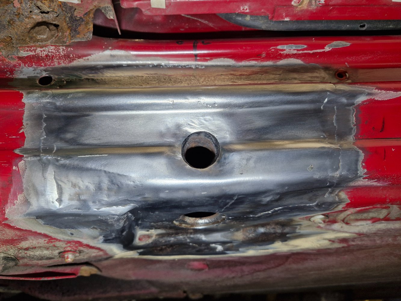

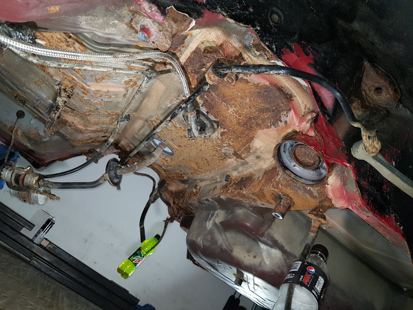

I've always done them in several peices too but there are panels available
Inner fender repair sheet (for Mercedes W124)
Another typical rust spot on the W124 are the front inner fenders. In particular, the right side (passenger side) under the wiper water reservoir is often affected by…www.trabhan.com
You're doing a great job there but what awful factory finishing for a premium brand.

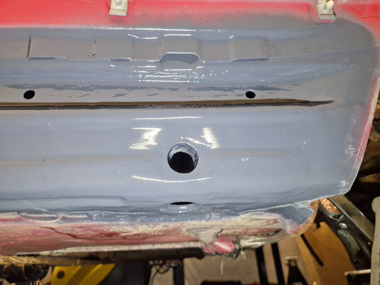

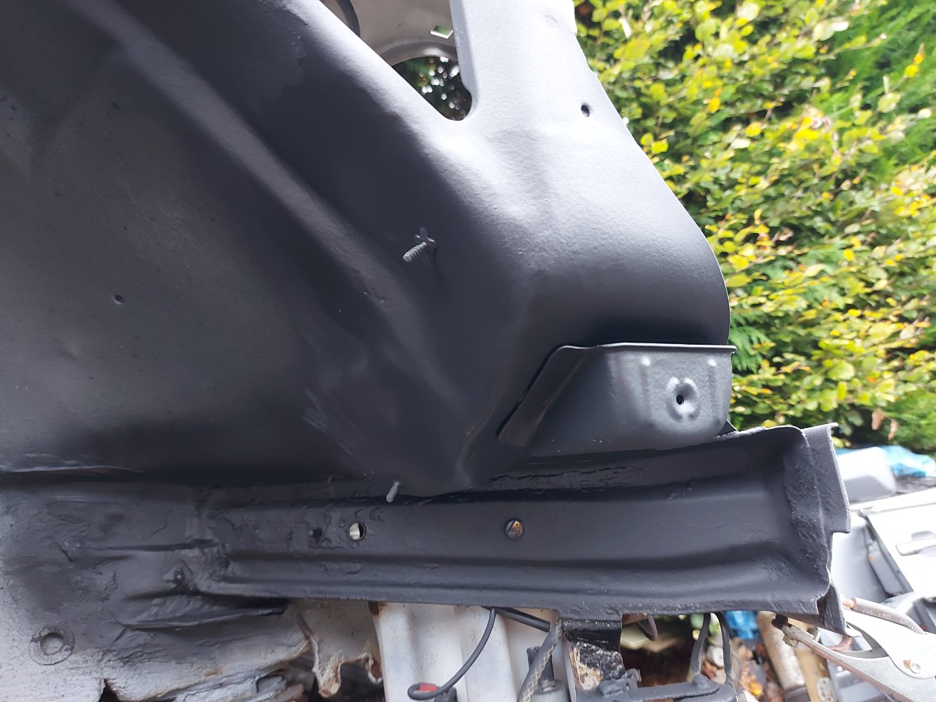

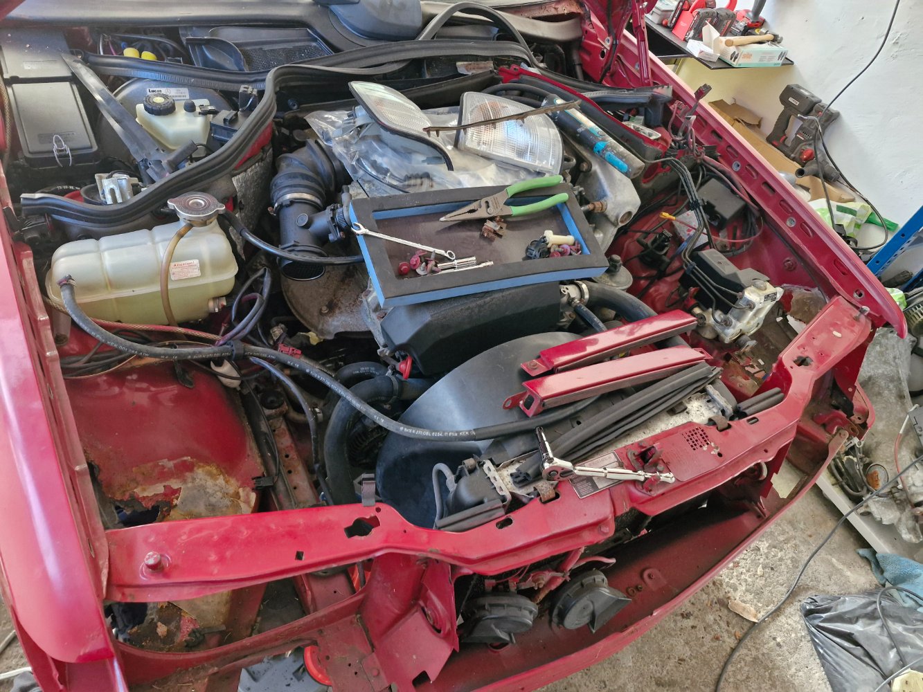

I am looking at what to treat the underbody with on this car. I normally used an epoxy primer, POR15 and followed by black waxoyl shutz.
I am looking at this epoxy which is expensive but claims to offer great protection. I could use my blast pot to remove the areas which have surface rust then brush and mini gloss roller 2x coats of the black epoxy on.

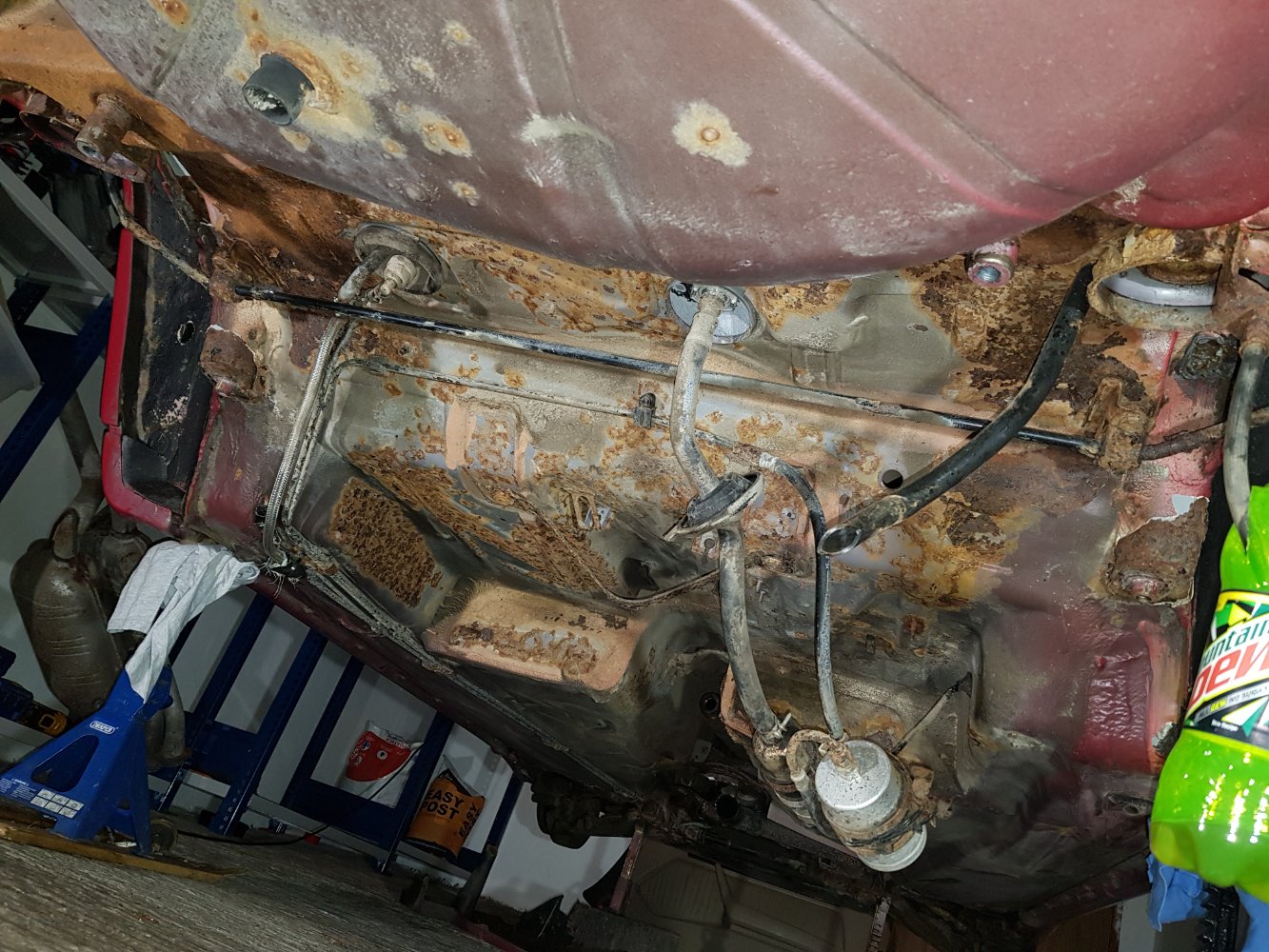

All C124s look like this- they mustn't have had enough paint underneath above the rear subframe
Are you doing this in your tent garage? How is the project going to fit the car lift in the other garage?
